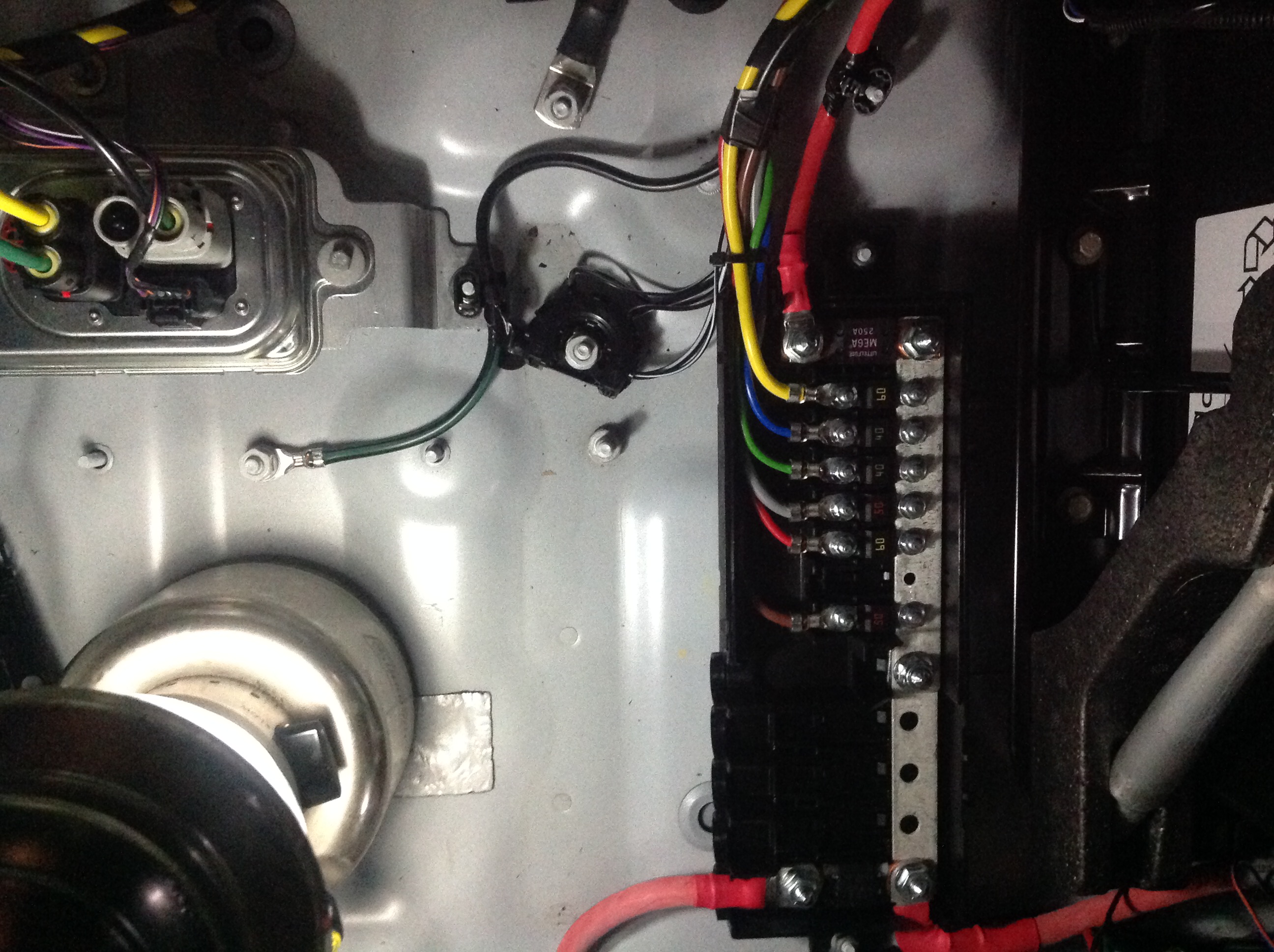

Old Dec 11, 2016 | 03:27 PM
jaguny's Avatar
Posts: 5,317
Likes: 635
From: upstate new york
Default 16 R coupe tender connection confirmation
I went to hook up my tender and thought I'd tack onto to this thread for a confirmation. My 16 looks close to "2015Coupe's" photo. If I read the previous info correctly, red is connected on the terminal to right of yellow and black is on connector with thick black wire on nut just visible at top of photo (rear of car). Please note rear of car is up in this photo.
Foosh or others please advise. Thanks.
Also, if correct, then what is the odd roundish buckle connector to left of yellow wire and what is green wire for (far left)?

Old Dec 11, 2016 | 09:06 PM
  #28
Waynejnc's Avatar
Joined: Sep 2016
Posts: 2
From: Star, NC
Default Hook up
Hook the red to the yellow (use the post directly across which has nothing hooked to it) and the ground to the chassis (with the green wire)... I hooked mine up yesterday. Works great... WJ

Old Dec 12, 2016 | 04:26 AM

jaguny's Avatar
Posts: 5,317
Likes: 635
Based on my house electrical knowledge I thought green (ground) was the correct location for black but the Foosh thread seems to indicate to connect to black I indicated. Maybe it doesn't matter which?

Unhingd's Avatar
Joined: Dec 2014
Posts: 16,948
Likes: 4,728
From: Maryland, US
A ground is a ground. You can connect the black (negative) lead of the tender to any of the grounding studs sticking out from the bodywork. Just make certain there is bare metal just below the nut.

Mikey's Avatar
Joined: Oct 2009
Posts: 11,057
Likes: 2,271
From: Perth Ontario Canada
North American household wiring practices don't apply to cars of any origin. On cars, red is almost always positive, black is almost always negative, except when they aren't. In the latter case, the smoke might be let out and you will need to start again with a different car.

Dogbreath!'s Avatar
Joined: Dec 2015
Posts: 656
Likes: 202
From: People's Republik of MD
To add to the confusion, Japanese cars often use blue for hot, except when they don't.
