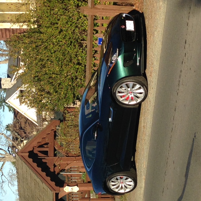

and why is the photo turned on its side???? Can it be straightened?
