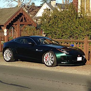

Trying to think the oil-check routine through logically: Unless there is something fundamentally different about these particular Jaguar engines, there should be no reason why an after-overnight cold reading of FULL would not be accurate (but readings should be taken in a consistent manner: always cold or always hot to eliminate the variables). If you really want to know how much oil is in the sump then allowing a sufficient amount of time for it to drain down is the only way. If the oil level reads FULL (and not above) on a cold engine then there is no danger of being overfilled. Given that the volume of oil increases somewhat when it is hot, we still have to accept that in a running hot engine much of the oil is circulating and therefore the amount left in the sump will be less (that is, below any danger level). What is more, the stated fill amounts are for COLD oil out of the container, not hot oil. So if 7.5 litres are specified for a full fill including filter then that means that 7.25 litres will/should give a FULL reading on a COLD engine, not an over-full reading.
The instruction to check the oil when warm/hot is new - it was never part of oil-checking instructions previously for Jaguar engines (or any other as far as I am aware). Indeed the instruction was always to wait for several minutes (as it is now) to allow the oil to drain into the sump to provide a reasonably accurate reading. Indeed, this instruction was embossed on Jaguar disptick handles.
I doubt that the modern Jaguar engines REQUIRE the oil to be checked when hot (rather than cold) - the admonition is there simply (as before) to make sure that most or all of the available oil has returned freely to the sump. There is no admonition to NOT check the oil cold, is there? not in my handbook. So I still cannot see why a cold check would not be appropriate.

Originally Posted by sov211
and why is the photo turned on its side???? Can it be straightened?
You were holding your phone sideways when you took the pic. Phones auto-rotate images, most computers don't.
Yes.

Originally Posted by malbec
Yes.
Ah yes, the cell phone. Thanks for reminding me of that and thanks to Malbec for making my beautiful F-Type land on its feet. The colour just amazes me.
