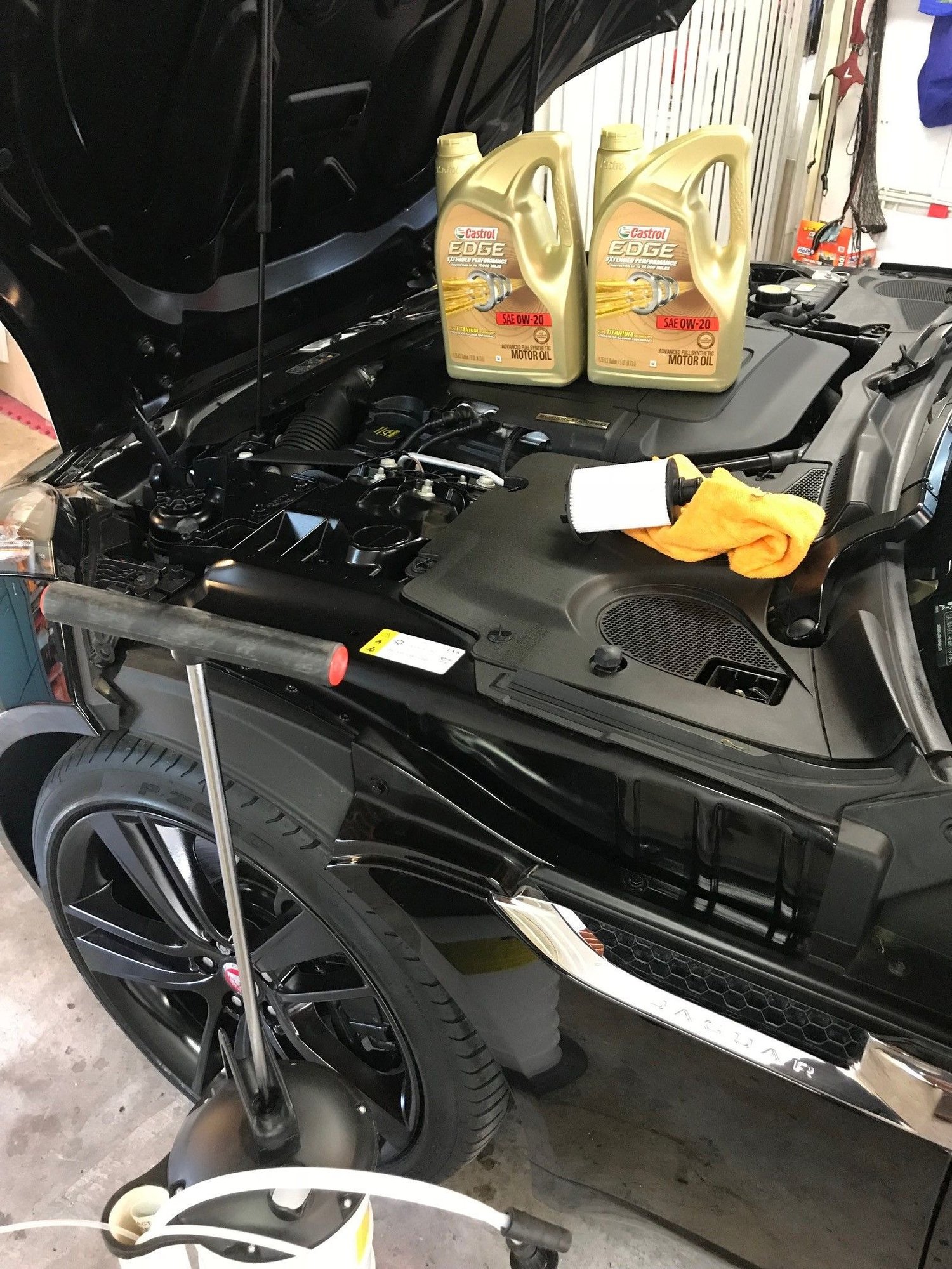

Didn't feel like going to the dealer so I ordered a hand pump on Amazon for $15 and went at it today. The black rubber seal on the top was poor so it took a lot more pumps than it should have, but it got the job done. I'd say that's about 500ml, so seems like exactly as much as you'd expect if they fill an AWD car with the amount that RWD takes.
Now to drive it and check again... I think perhaps the most ridiculous part about this is how the instruction for overfill situations is "do not drive under any circumstances" but step 1 of the standard procedure for checking for the condition is "drive the vehicle"
