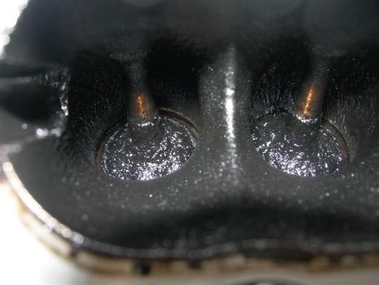

Direct Injected (DI) engines put extra stress on oil while variable timing makes engines more sensitive to oil quality. DI also has a unique weak spot - sludge buildup on intake valves that is related to blow-by. You have more blow-by as your engine oil accumulates miles, none the first couple thousand miles and up from there.
Mainly, this is what you want to avoid with frequent oil changes:
The above picture is of BMW engine, where too long service interval resulted in such problems. Pictured engine is only a year out of warranty and followed service interval. In response to these problems, BMW reduced recommended oil change interval but left owners paying out of pocket for mechanic's bills.
The only way following factory oil change interval makes sense if it is leased car that you will dump on the next sucker long before any of this becomes your problem. If you still see yourself driving your F-type at 50K miles, then half your oil change interval.
