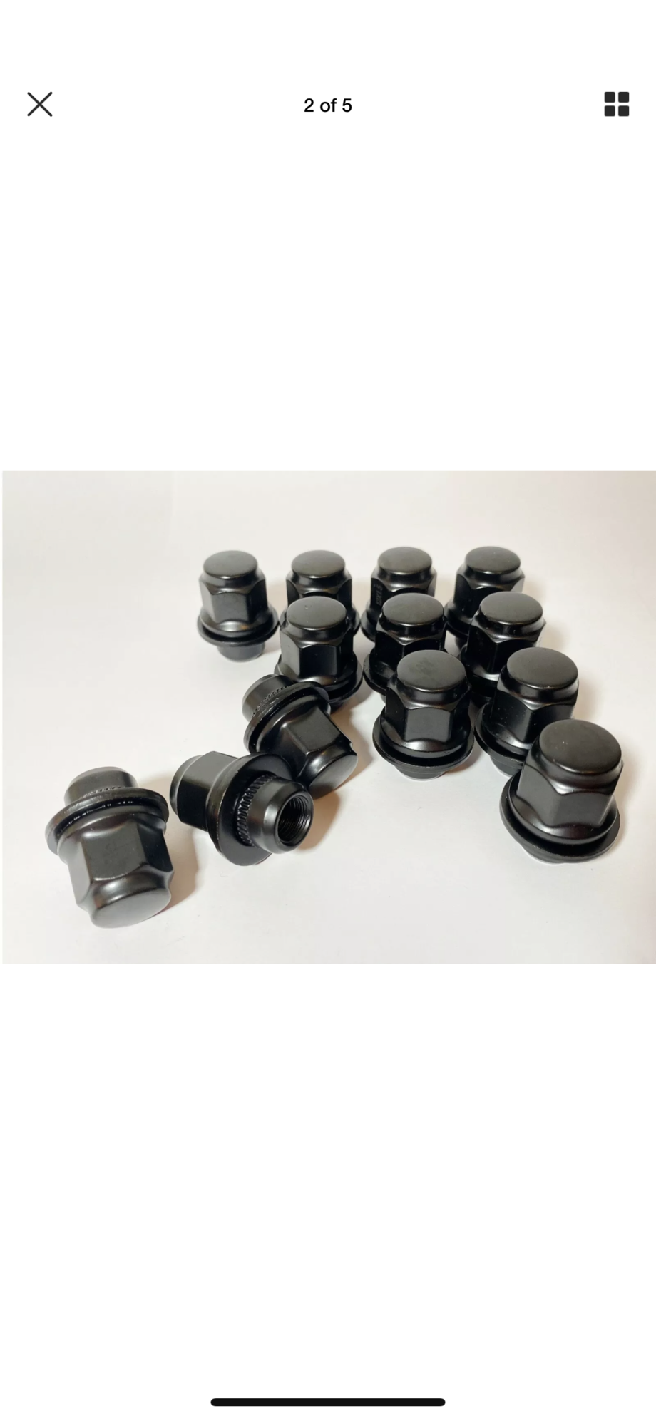

Hello, I have been having a hell of a time finding correct info for the proper lug nuts for my car. The car is an R1 model XJR with the factory BBS Milan wheels. I took the car to get tires balanced and the shop said they didn't want to mess with the lug nuts because they are afraid they will break.
I want to buy a new set and Searching online is giving me two different answers as to which lugs are correct. I BELIEVE the ones on the left is what my Milan's require.
Could anyone please give me a 100% answer on what will work on the factory BBS wheels?
Thanks so much in advance!

This is a few days late, and does not entirely answer your question, but my BBS Montreal’s use the pictured left hand extended nut.

Mine also has the extended ones. I am wondering if the shorter ones will work.
Im trying to avoid spending $185 on oem ones. I found plenty of 12x1.5 options that look like the shorter ones in my picture above.
the thing is when I look at the cars it will fit the 99-03 XJR is excluded.

I have both sets of lug nuts and they both work with my BBS Montreal wheels. I prefer the shorter ones myself.
