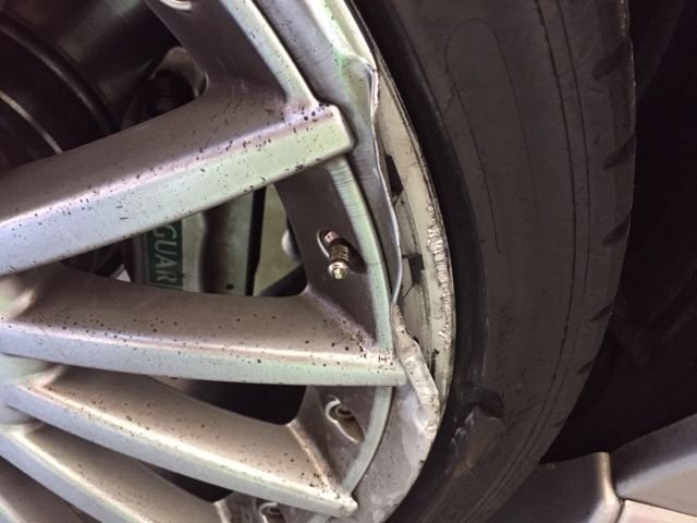

Hey, I tore up the chrome rim on rear 20” Sepang BBS on 2005 XKR. Alloy part of rim is ok but ring is destroyed. Does anyone know if that part of wheel is replaceable? If so, any place in Atlanta area? If not, how can I find a replacement for whole wheel?
Thanks
Old May 15, 2019 | 03:01 PM
Likes: 17,009
YES - it's a separate trim ring which is replaceable.
Not cheap (in the UK they are available at 125 UKP) but a lot less than a replacement Sepang wheel which is becoming very hard to find.

They are polished stainless though, so the damage might be repairable by someone with metal working skills, if it is not hurt too bad.

Not sure if this is any use, but I'm pretty sure BBS used to have (or maybe still does have) a location in or around Atlanta. There's gotta be someone who can fix those wheels.
Some shops just remove the trim ring and polish the rim underneath, followed up with clear coat. Two of mine are like that, and they're pretty solid looking. Deathly afraid of curbing them, though.

Thanks for the thoughts. The Sepang wheel itself (barrel and spider) are fine and I have replaced the Mich tire (I always get the Road Hazard Warranty) with no problems. But the trim ring is destroyed in two places (see image). I doubt anyone can 'repair' it, so I'm gonna have to replace it. Anything els I should order with it that might be needed during replacement?

The titanium bolts are fixed with Loctite and torqued by Superman. Be prepared for a fight.

You will need to have the spline bit. 12 point M8 l think. There are trim ring replacement guides available online to give you a good idea of procedure.

One thing no one has mentioned so far.......... you do know that the front any rear tyres/tires are different sizes dont you?
As for th rims as mentioned before they are separate and expensive. I had my wheel refurbished when I first got the car, not a cheap thing to do click me to see damage
Then my wheel after, the others were the same. click me and take a look
