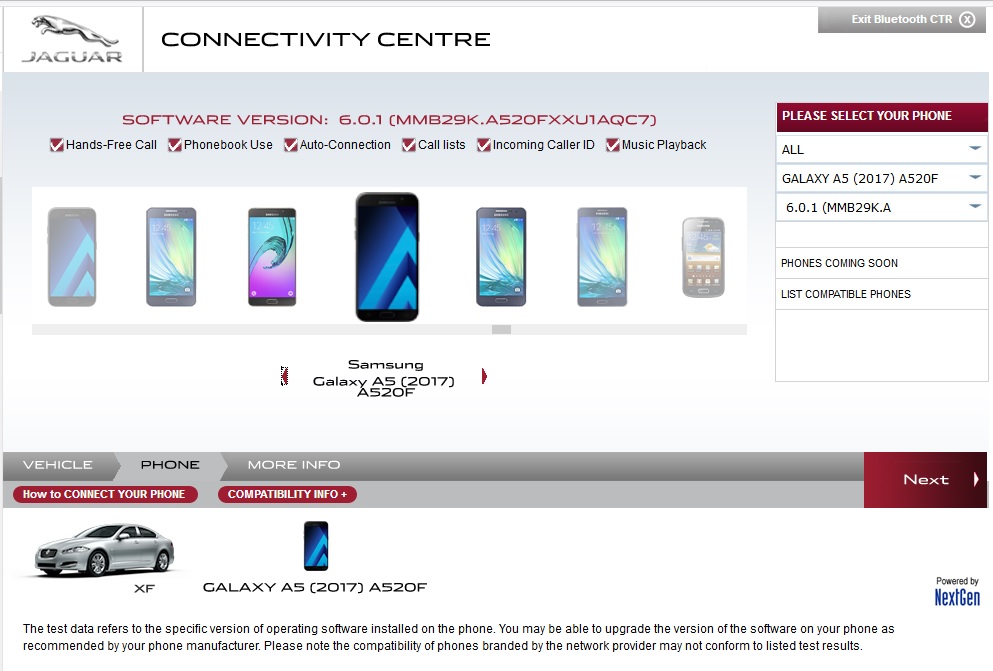

Welcome to the forum madmack,
Your problem is not new - Jaguar have an uneasy relationship with Bluetooth and always appear to lag behind developments. Go to the Jaguar Connectivity Centre to check phone compatabilty and pairing instructions for your model:
Vehicles - Jaguar
Looks like to Jaguar X250 and the A5 should be compatible.

Thx GGG for the welcome and info, I also used the connectivity site, without vin number as you did it does show my phone, but with the vin number it isn't there, so I'm guessing from what I've read I will need an ungraded module.

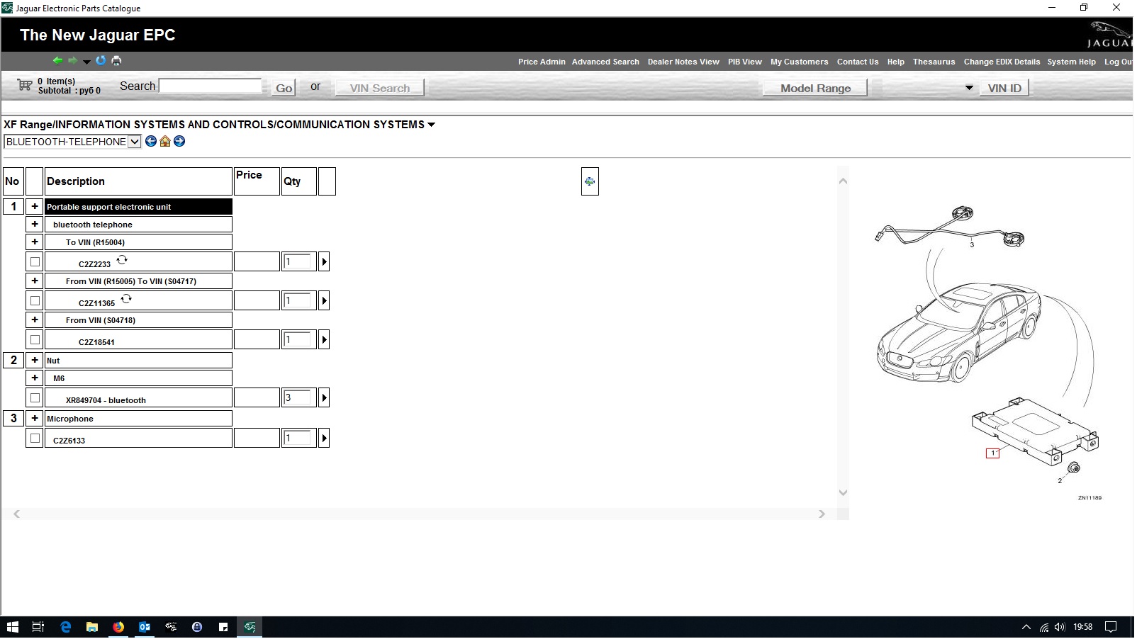

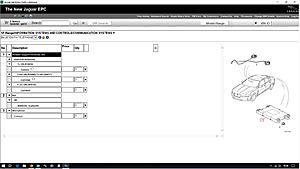

Old Jun 2, 2018 | 02:03 PM
If your vehicle is not factory BT equipped, it's an expensive retro fit.
(double click on the image to enlarge it)
There are superior aftermarket alternatives - not as neat but more efficient and lower cost.
