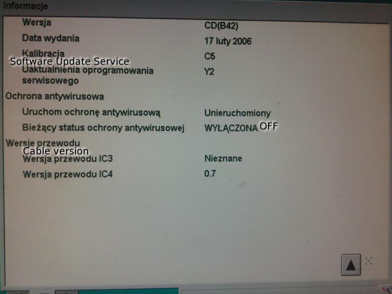

I have some problem with WDS.
System can't read information about battery. I checked the battery and tried to communicate with him using my AVR microcontroler to sow what information she send.
And all look good, she (battery) return information about capacity, date of matufacture, manufacturer, ID number etc.
Sow I plugin to WDS and... and nothing.
System see battery but does not show battery information.
When I start WDS, he wants to condition the battery, sow I run it and... and 1 week later baterry have 100%.
But system still want to condition the battery and don't return information about battery.
Could someone check he see information about battery?

I add photo with information about battery and system.
Attached Thumbnails Ford/Jaguar WDS Genrad GDS3500-c360_2012-10-25-10-11-59.jpg   Ford/Jaguar WDS Genrad GDS3500-c360_2012-10-25-10-11-09.jpg   Ford/Jaguar WDS Genrad GDS3500-c360_2012-10-25-10-11-33.jpg
