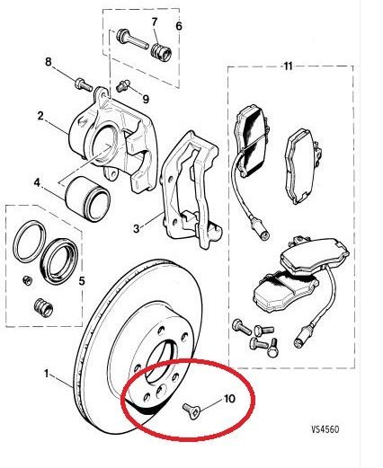

I am putting new rotors, calipers and pads on all 4 wheels on my 88 XJ6 Base. The right front hub does not have a hole for the set screw. Is this normal, and if so, why. If it is not, what do I do?

Had that a few times over the years. Some not drilled, never worked out why, some butchered, some sheared off.
I would worry not, rotor on, wheel on, tighten the nuts, everything is happy.
None of mine had any issues without that set screw, stopped fine, no noises, no vibrations/shudder, and I really never worked out why it was there in the first place.
If it really worries you, drill and tap the hub to suit.

OE Jaguar brake discs had a countersunk drilling for the setscrew - many aftermarket equivalent replacements do not.
The setscrew arguably makes assembly a little easier but most do not bother to refit it if it was difficult to remove or damaged. As Grant says, after assembly, the wheel holds everything in place regardless.
