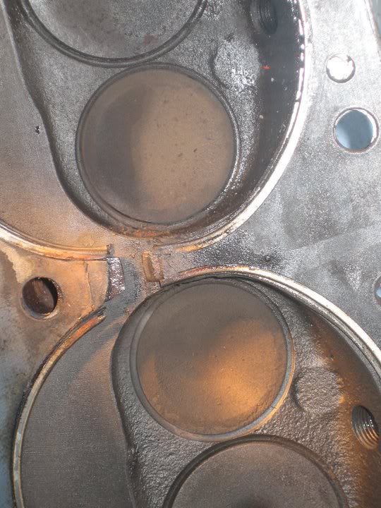

This is an example of a head gasket blowing on a 7.2 litre Chrysler engine.
In this case the engine sounded bad, was down on power but it never over heated and there was no coolant mix with oil. The cylinders were simply "swapping spit".
The engine was stripped due to another problem- metal fragments in the oil system and low oil pressure and THIS was also found!
[The Metal fragments DID NOT result in a spun bearing or scored journals- most amazingly (although I was sure not to drive it when I saw something was up). I feel sure that if this had happened to a modern aluminium pent roof VCT quad cam 32 valve engine , the engine would be junk in short order!]
