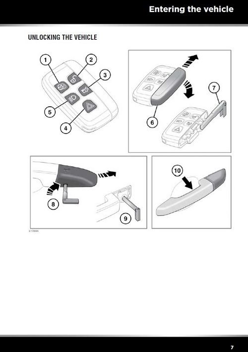

Help please Jaguar xf refuses to open, suspect flat battery, key fobs do not work also mechanical key does not unlock the door just sounds the alarm (until back up battery became flat). Looking like will have to smash the driver door window unless any one knows a way to open the car.
Old Dec 21, 2023 | 06:09 AM
Likes: 17,008
Welcome to the forums Smerlin,
I would avoid breaking a window. JLR parts supply chain is getting worse and, when you get a replacement, fitting a door glass will be very expensive. There's a lot of disassembly/reassembly involved.
The emergency key blade operates the lock manually via a cable - it doesn't rely on electrics.
I had to use this entry method a few times on my last XK. You should be able to feel the cable movement as you rotate the emergency key and then pull the door handle. It always triggers the alarm as soon as the door is opened but "docking" the smartkey then stops the alarm.

I have tried the AA and mobile locksmiths none of which could gain entry. Graham the emergency key refused to unlock the car. Does any one know if there are any external battery terminals behind the front wheel arch cover as on other models.
