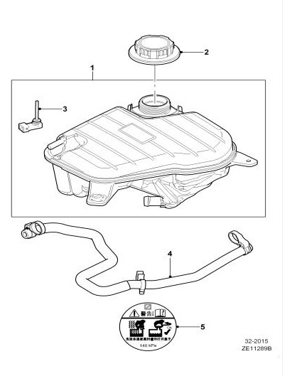

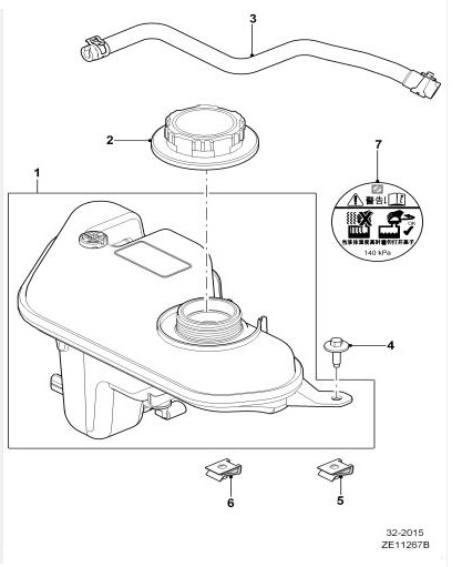

I see this question as correctly belonging in X250 forum where members with the same model are more likely to see it but will leave it here for a while.
Is this a N/A or S/C engine? According to JEPC they use different Expansion Tanks.
NATURALLY ASPIRATED
SUPERCHARGED
