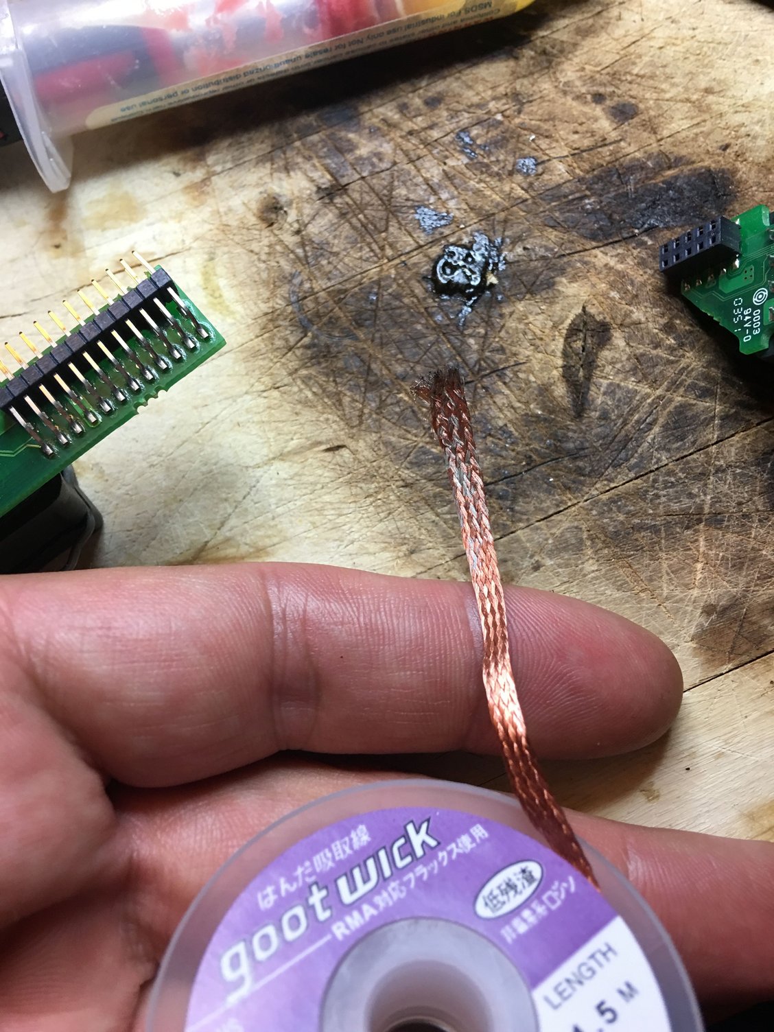

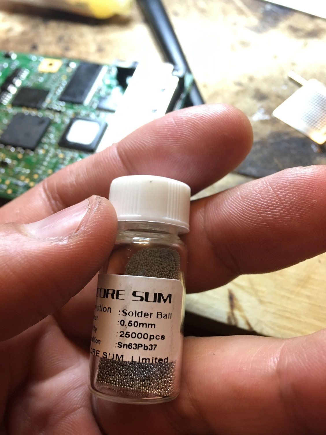

Getting ready to remove the chip
This is the stencil I used
Playing with my *****
Got a lot of stencils for $37
This is what you use to wick old solder. I didn't take more pictures as I was finally alone and not sure how much time I have. Plus taking pics alone when doing stuff takes 3 times as long.

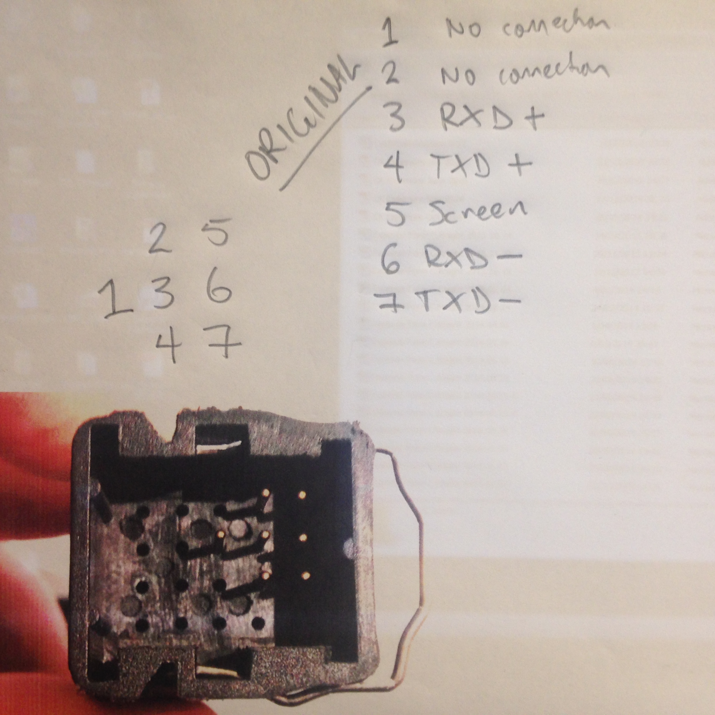

There is a pin-out of the original DLC cable to test one if you have one that you're not sure about.
Repair an original VCM / GNA600?-screen-shot-11-01-16-12.34-am.jpg
Testing the USB cable is not so easy, but I did take notes of the connections of one of my originals, but to test it you need to open up the "box" in the middle of the cable, and then make a continuity test from the PCB to the connectors at each end. You can see the RX, TX, etc from the PCB to the VCM connector.
Repair an original VCM / GNA600?-img_2671.jpg
I thought I had noted the USB side of the cable as well but i don'e seem to have that in my notes. Live-testing a USB cable is pretty straight forward though, it either works or it doesn't, regardless of if you are connected to a vehicle (external power to the VCM).
Live testing the DLC is a bit complicated if you don't have access to different vehicles Ford, Mazda & JLR, but it's easy enough to check the pinouts according to the instructions.
