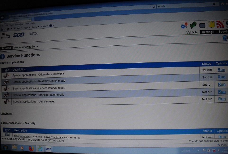

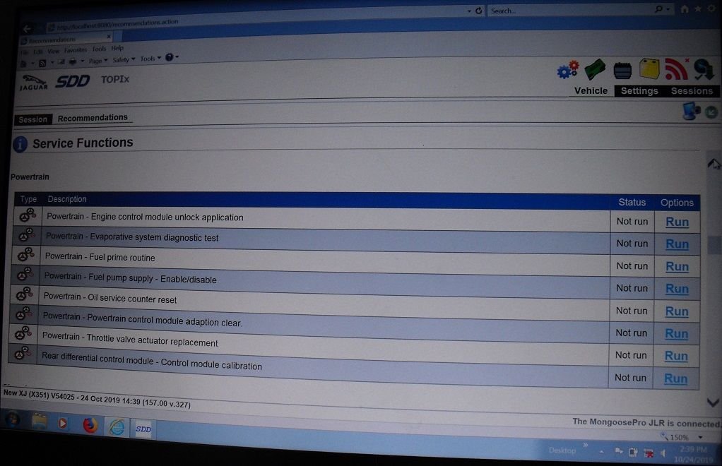

Everything works fine but looking for the oil service reset I seem to find 2 places with a resetting service indicator?
This one;
and this one;
The second one looks better because it mentions Oil but maybe reset both?

Either one of those srvc resets work. Theyre one in the same
