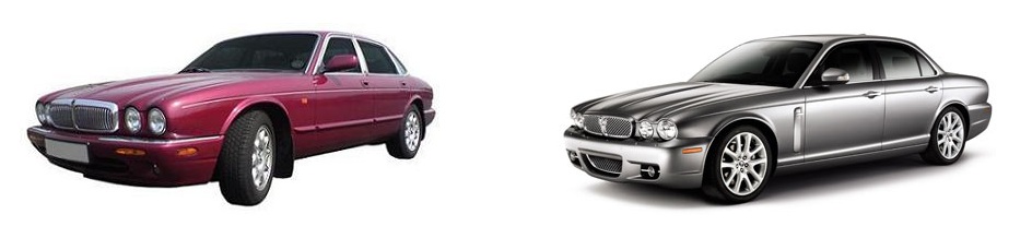

First off, welcome to the forum June,
To get relevant advice, you need to confirm which model XJ8.
Is it the steel body 1997-2003 model on the left or the aluminium body 2003-2009 model on the right?
To distinguish between these XJ8's, the early one is known as X308 and the later one as X351.
As has already been mentioned, without having the DTC (Diagnostic Trouble Codes) read, troubleshooting is just guessing.

Oh sorry, I forgot to mention it's a steal, x308.
