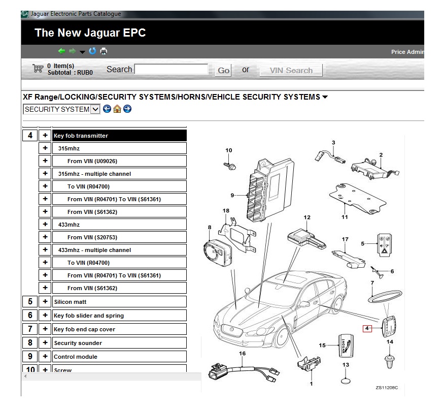

Old Mar 27, 2014 | 06:13 AM
The important word here is identical.
As with this and all earlier Jaguar models, the security system is both market specific (different operating frequencies of 315mhx and 433 mhz) and subject to updating throughout the model run.
The Parts Catalogue lists six different Smartkeys for the XF. They all look the same but have different internal components.
To allow reprogramming, you need one of the same frequency and from the same VIN range. This is what I understood you meant by describing it as identical.
