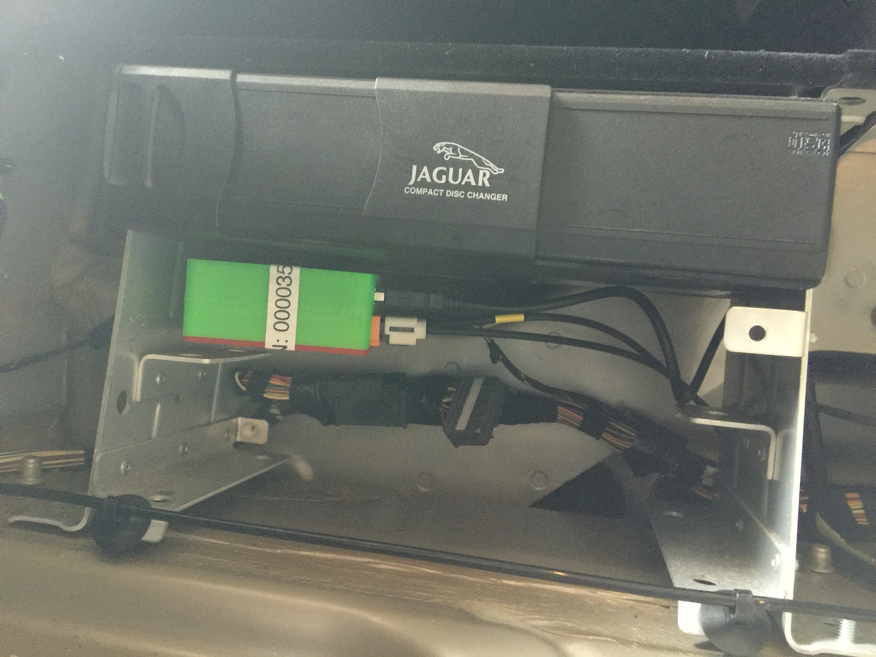

I don't know whether it was installed at new or after pal is there a way of checking? Also I don't know if it has a VACM, I have a box in my boot that says motorola on it under the cd changer if that helps?

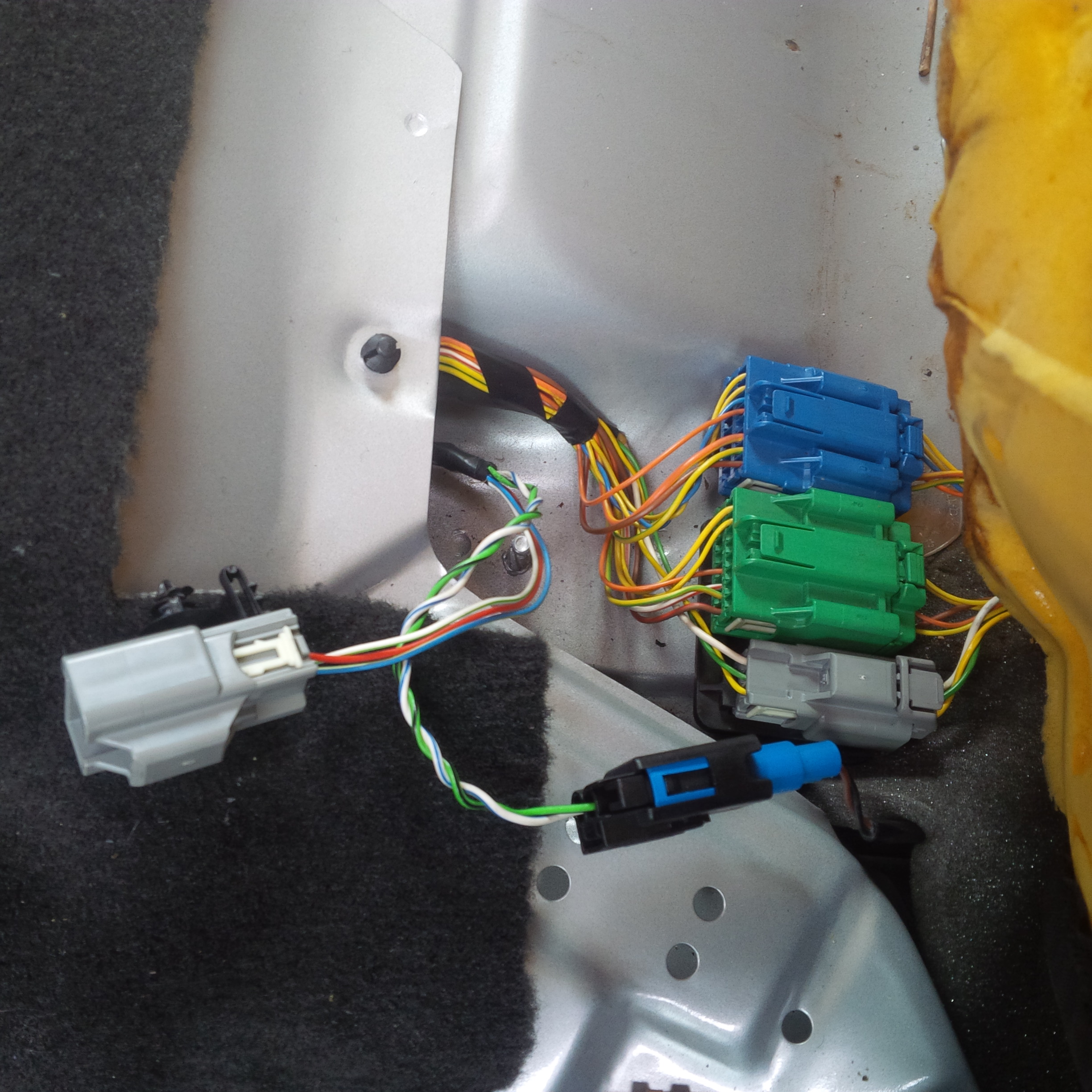

Also while trying to get to know my car (routing around) I found this block connector with nothing connected into it under the rear seats... is this something to do with any of it?

Old Jul 8, 2015 | 05:52 AM
  #45
jackra_1's Avatar
Joined: Aug 2014
Posts: 6,264
Likes: 1,764
If you have VACM installed you should be able to activate it with the button on the steering wheel.
the Bluetooth module has Motorola stamped on it. My VACM unit is black plastic but I think some earlier ones are metal.

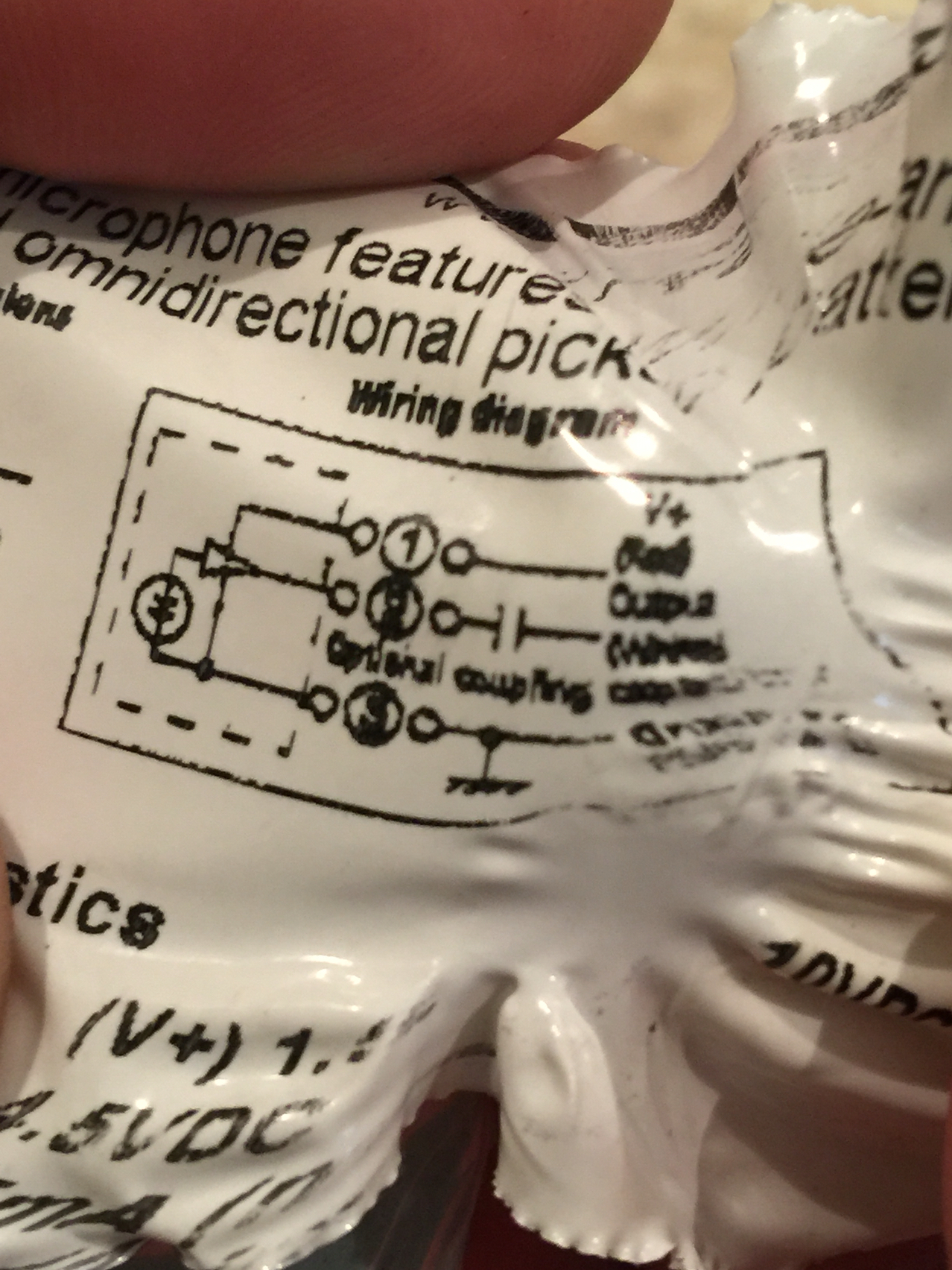

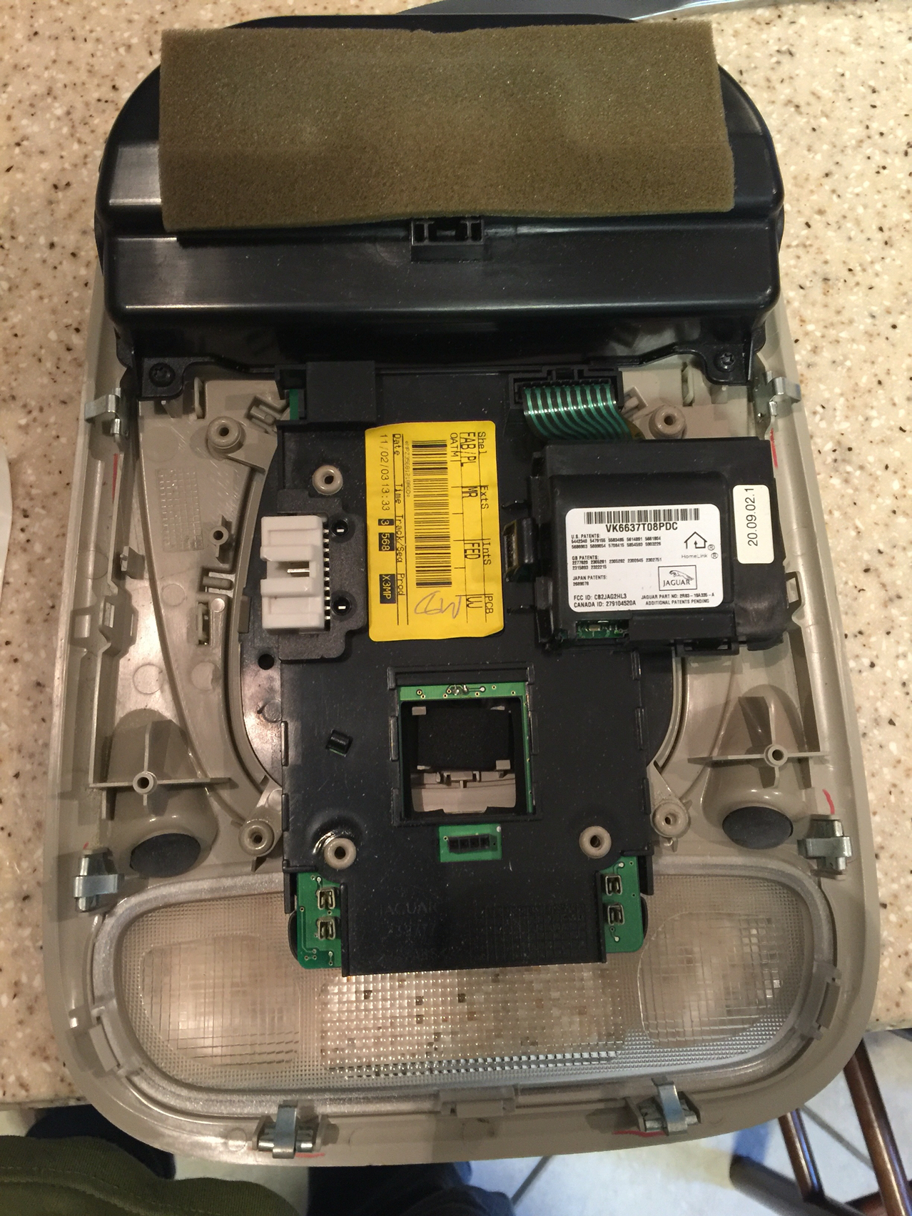

Default Question about Mic Choice
Hello-
Using the information in the thread, I added the "upgraded" style bluetooth and the antenna to 04 Xj which had neither.
I have been trying to source an OEM microphone, but have not to this time.
So, my phone module arrived from Poland and my antenna from China and I HAD to get it installed. Having read this thread in the past and noticing that 'any electret should do', I went to Radio Shack and found the following Radioshack - Products
Tech specs: RadioShack Electret Microphone Element (270-0090)
This setup 'works' but the volume from the microphone is low.
For the electret, what are the 'look fors' which might specify better volume performance? Any suggestions other than oem?
Thank you
mag
