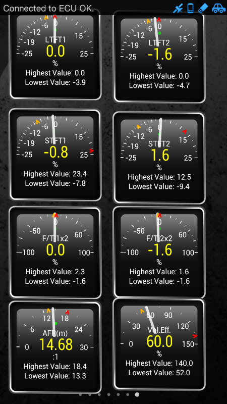

Thanks John, I've checked the fuel trims at idle and they're close enough to 0%
I don't remember what they were like at part throttle before but you can see for yourself here.
Just pottering along the short term gets up to around 3-6%, half throttle sees them up higher, in the teens and low 20's
Bear in mind these values are less than 100 miles after an ECU reflash...

It's the Torque App on my Android phone, using a ELM327 bluetooth OBD2 adaptor.
Took the screenshots with a screenshot app.

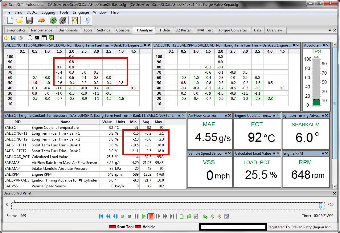

Well, SDD can actually be one-upped by other stuff sometimes. The attached screen can illustrate a couple things.
First, with regard to the Short Term Trims, I said not to pay such close attention to them, here's why. This screen is from a logged drive after I made a purge valve repair, to confirm it was fixed. All the cells in the FT Map for both banks show LT Trim very near zero. That is what we want to see, this car is darn near perfect. Now look at the lower red box, you can see the Min and Max figures for both LT and ST trim. This car is perfect, and the ST shows having gone both way high and way low. The fact you see that tells you absolutely nothing, IN THIS CASE. They do have value at other times, though, just not right here.
Now if we were to map Cameron's car the same way, and our theory is correct, that is boost pressure getting out is causing his whistle, I would expect the FT figures in the cells in the upper red box [those are the load cells where we would expect SC boost] to trend negative. Negative because it would be metered air that never made it to the combustion chamber. The O2 sensors would detect the actual exhaust oxygen and the trims would respond accordingly. If the leak was to just one of the intercoolers, only one bank would trend negative, if it was the seal at the SC outlet, I'd expect it to affect both banks.
In the real world, how much it would affect performance is anybody's guess. Depends of the size of the leak, of course.
Cheers,
