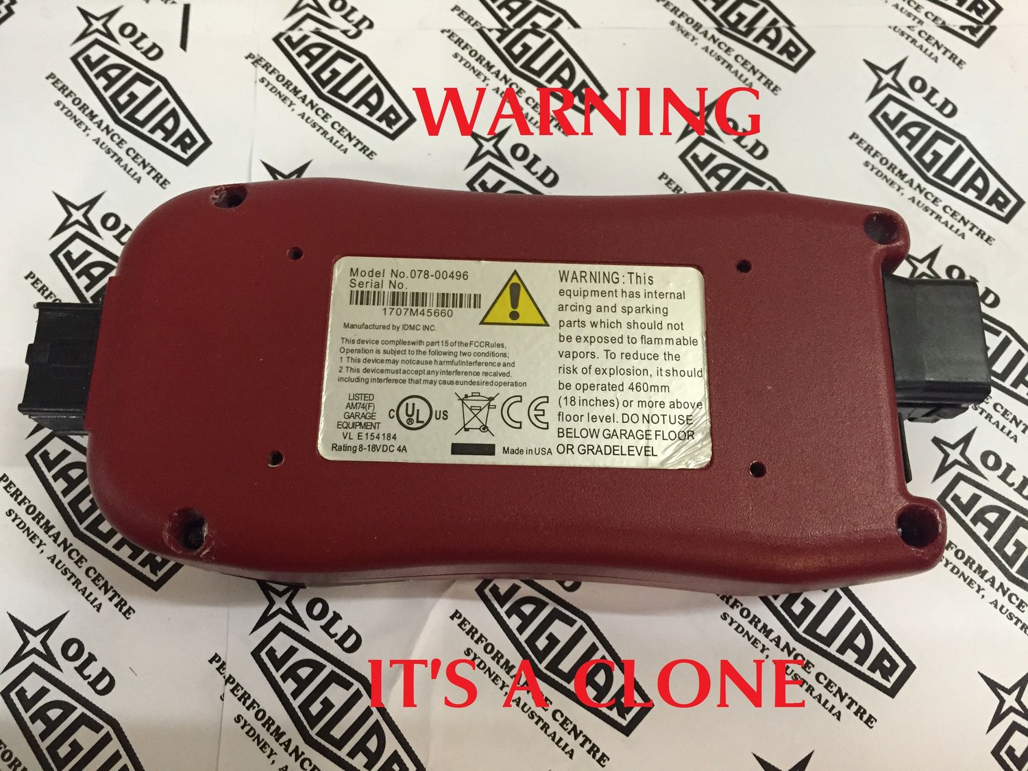

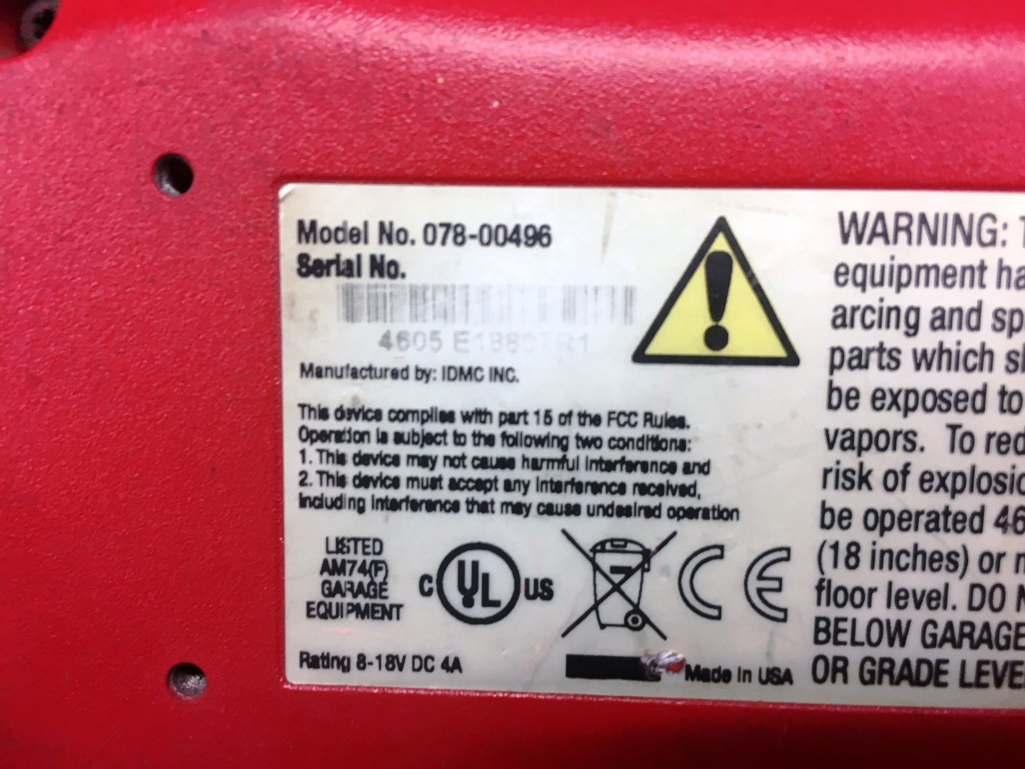

Never seen a clone VCM with the blue label, so you can be quite sure a blue label one is genuine, unless someone swapped clone PCB's into an original case (this happened to me once!)
Only genuine VCM's have the PCMCIA socket in the upper PCB, you can see the black button to release the card through the clear cover.
Clones usually have flat-slot screws holding the black clips for the clear cover in place, genuine have small allen head screws.
The label on clone VCM's is often reversed, so the VCM points the wrong way.
On a genuine VCM the serial number is printed on the label afterward, different font, badly aligned, slighty faded.
The genuine serial number is in a format of four numbers, a letter, then five numbers, sometimes with an additional letter at the end of R1, R2, and spaces between them, .. e.g. 1234 A 56789 R1
This is a clone label
This is a genuine label
Of course there are variations, not all will look like this, but it is pretty common...

One other thing spotted on the clone is a code under the statement "Listed AM74(F) Garage Equipment" VL E154184 - This should be UL E154184 for Underwriters Laboratory. On the real vcm's I've seen the UL code appears to be printed on the label when the serial number is printed as they appear to be a more grey print.
