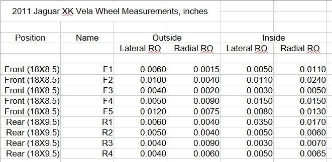

Nine Vela wheels were mounted as previously described. Runout in inches was measured using a dial-indicator gauge.
The purpose of this exercise is two-fold:
1. Evaluate the wheels for actual use.
2. Understand typical run-out values for a range of used alloy wheels.
Measurements were done twice to confirm reliability.
All wheels were used. The amount of use tended to correlate with amount of run-out.
Measurements were taken in the middle of the respective bead surface for both Lateral and Radial.
Conclusions:
Wheel F3 has the best (lowest) overall runout ranging from 0.002" to 0.005" It shows very little use.
It appears that the OEM specifies Run-out values between 0.000" and .005".
What is not evident from the values is the presentation of variation. Some variations change slowly and some change twice in one rotation.
An apparent dent is seen as a quick deviation over a short distance.
F1 and F3 were selected for front wheels.
R2 and R4 were selected for rear wheels.
