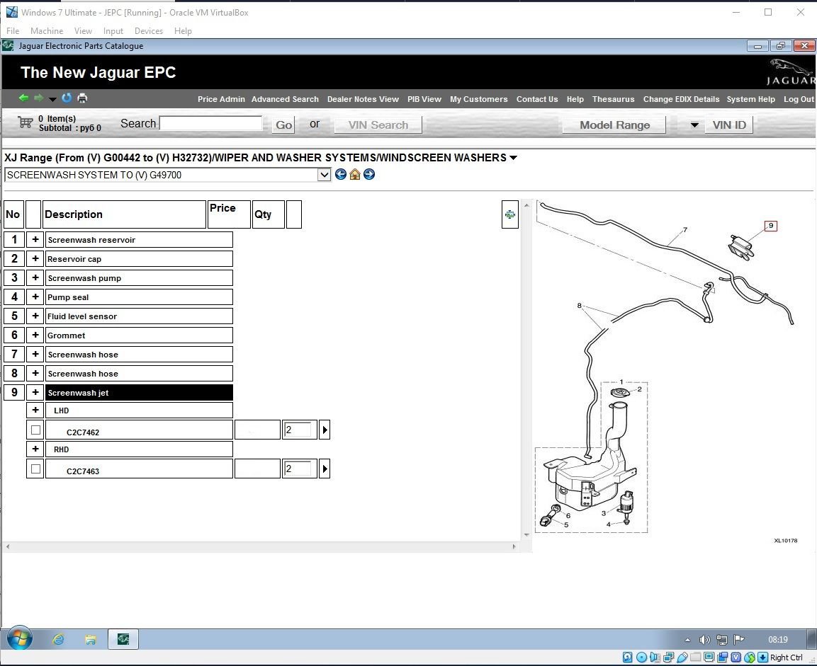

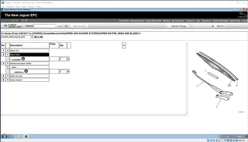

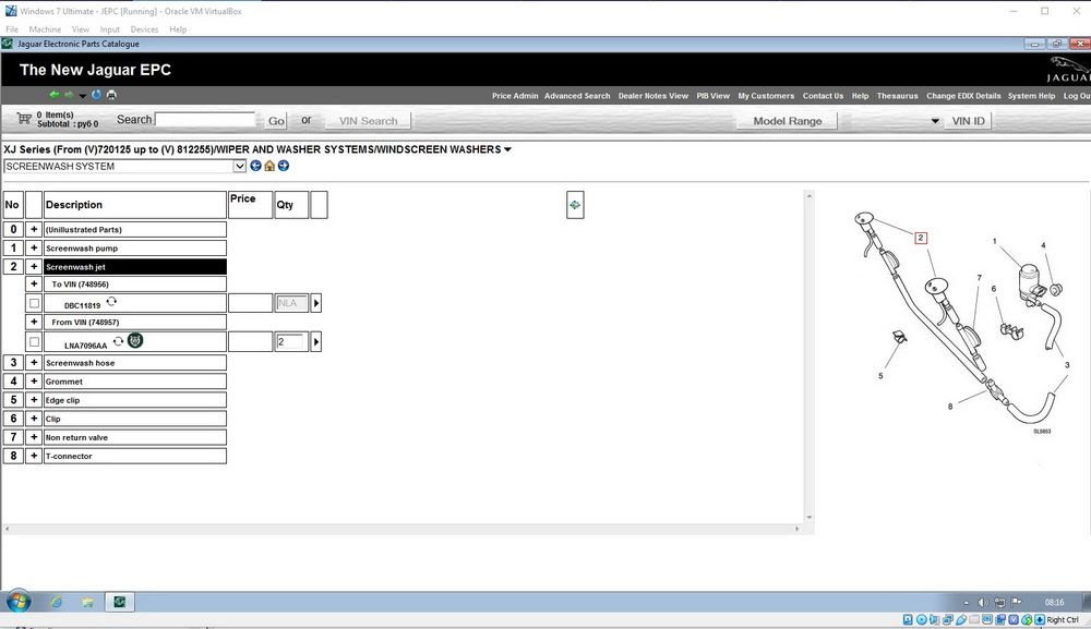

Here's the relevant pages from JEPC (Jaguar Electronic Parts Catalogue) for the US specification X350. Wiper Blades and Screenwash system. I don't see any hoses associated directly with the blades or arms:

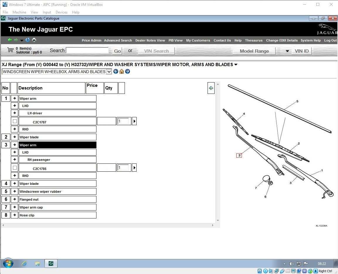

Found them in JEPC:
WIPER ARMS
WASHERS
Looks similar to XK8 - washers in a rectangular block attached to the arm and the feed pipe goes up the inside of the arm?

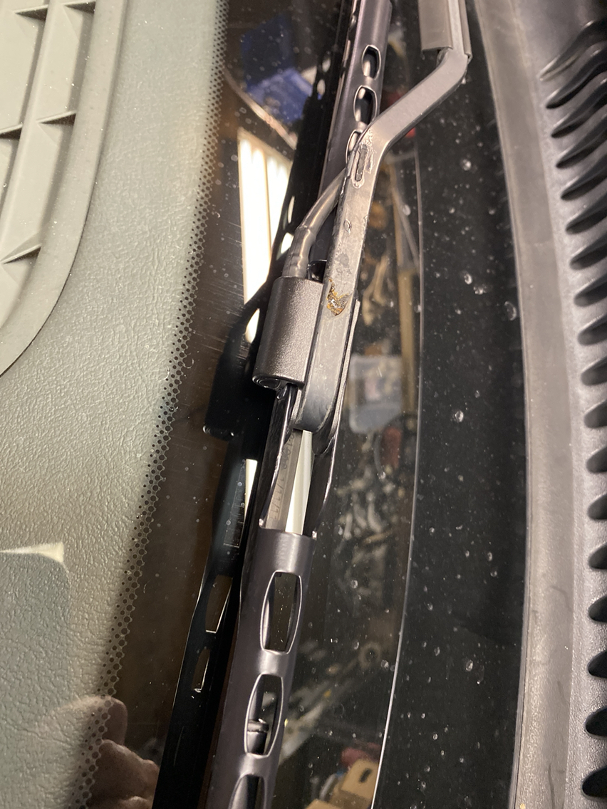

This is mine. The nozzle is part of the piece that connects to the arm...
