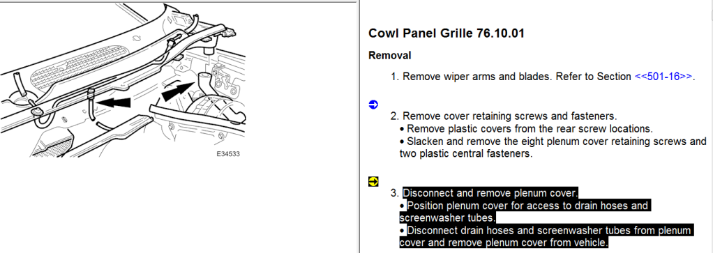

I read (here?) that pollen filters were optional- check that you have one before buying a replacement. It's not as easy as popping the hood. You have to remove the windshield wipers and "cowl panel grill" to see if you have it: attached is a pic from JTIS. You can see the filter peeking out under it in the lower left corner.
