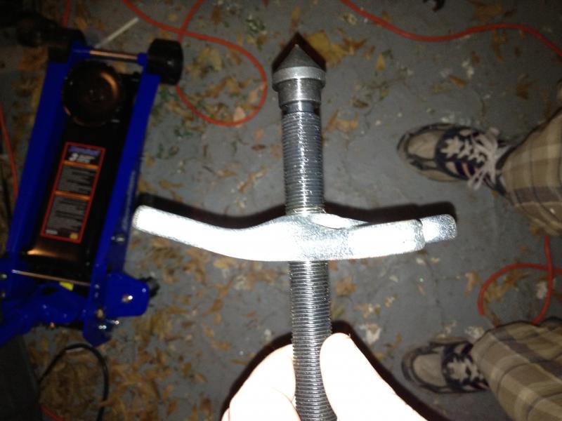

Since I hadn't seen it I just got the bolt out and stuck a harmonic balancer puller on it.
Here's how well that has worked:
Have I totally jacked things up by not using that remover-crankshaft damper tool mentioned in the bulletin?

That's the tool to use but you only need to pull the damper a little and then smack it to loosen the split cone. Then the tool will pull the damper off easily.
You might need a better quality puller if it is really tight.
Spray some penetrating oil to get things slippery.

You might be missing the most important part of the instructions motorcarman is giving you.
Smacking the balancer with a hammer is the key. The vibration loosens the cone more easily than tons of pressure will.
Now, since your tool does not have the button to seat the puller screw against, your next best bet is to screw the crank bolt back in leaving a gap of 1/4 inch between the head and the balancer. Apply heavy pressure with the puller against the bolt head and smack the balancer from different sides until it pops a bit.

One more tip ... grease the contact point between the bolt head and the puller screw since the bolt head will tend to turn in as you turn the puller screw ... you need that gap for the balancer to have room to pop. You can also use a wrench to keep the bolt from turning as you tighten the puller screw.
