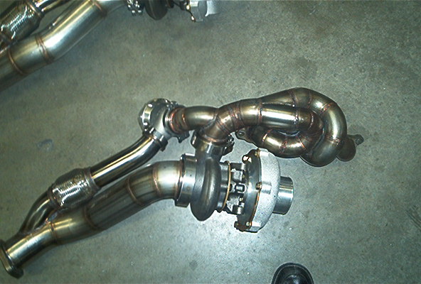

this kid is 20years old , he started welding at 16 in high school shop, Austin Texas.
now moved on to a high tech engine lab. doing all types of fabrication and welding.
i'm always impressed with skills that become art.
these turbo headers are for a Nissan GTR, making them fit to the car was amazing!

Work of art to be sure.
But, I have always wondered, what is the right balance of exhaust pulse arrangement vs a torturous convolution of tubing.
All of those twists and turns come at a loss of momentum, so what is the right balance to maximize flow?

so true, but to make them fit the vehicle, a street car new only 1 month old, without destroying the body and 4 wheel drive system, you make some sacrifices!
they wanted larger turbo's and a SS header/exhaust system, along with engine mods, car made 850hp on 1st dyno pull. factory displacement!
since then,about 1 year ago, it is up around 1000hp ,and cruises around Austin TX.

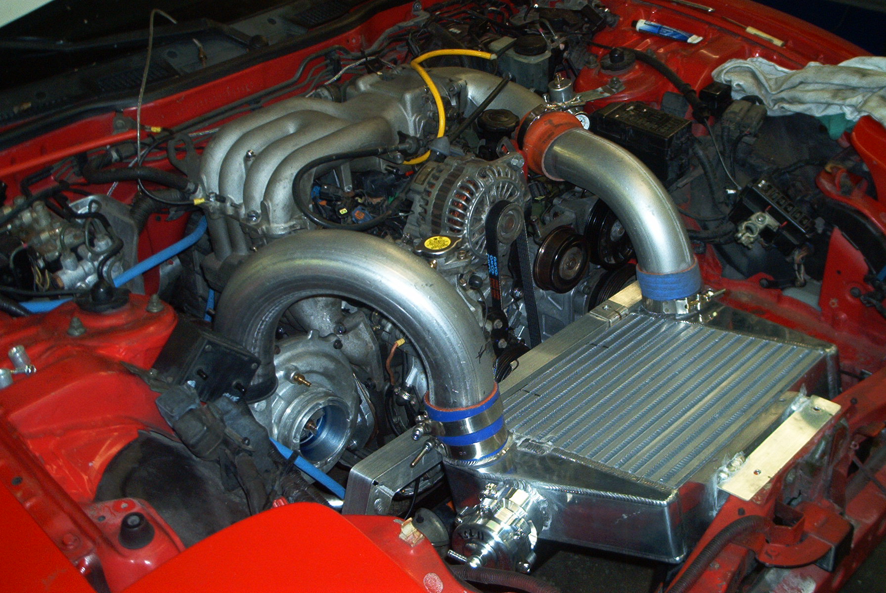

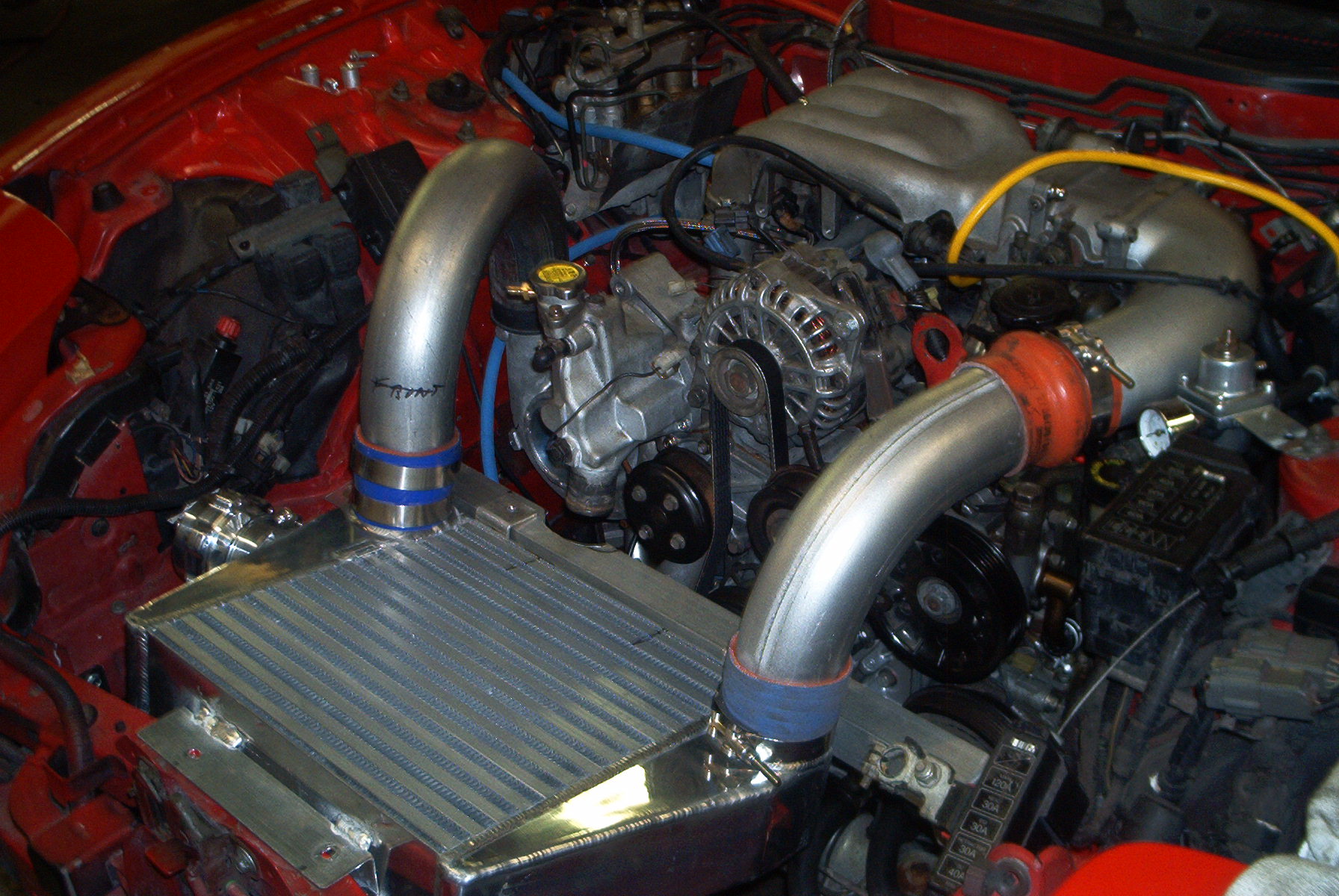

couple pix,, Mazda rotary(i work on anything thats interesting) big scoop under car, 500hp from 1.3 liter,.

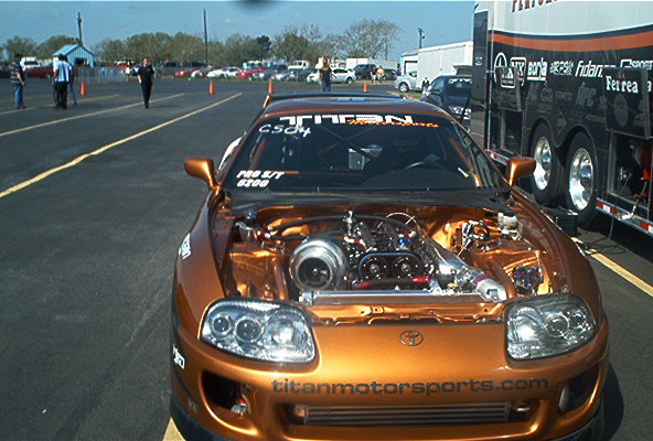

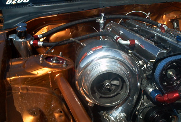

and a 1400hp in/line 6 cylinder Toyota, 204mph 6.7 seconds, 1/4 mile.
turbos work just fine!
