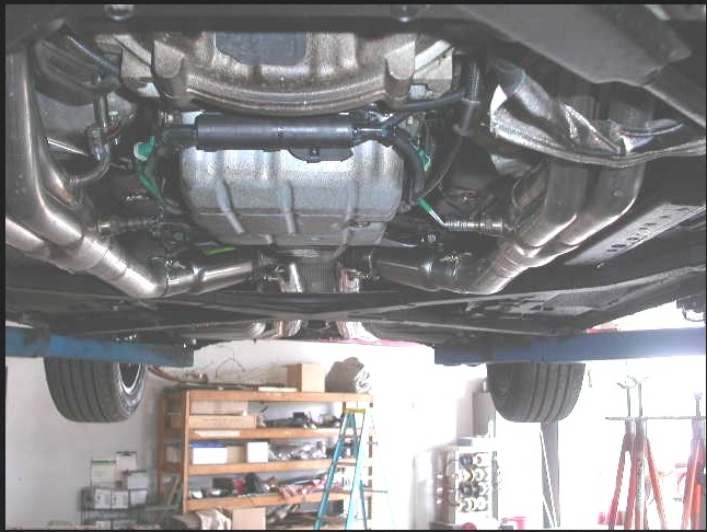

Yes. We never got the long tube Stainless Works headers installed on a S Type.
Stainless Works Performance Exhaust, Headers and Fabrication
They were finally installed on a Lincoln LS and the guy said it was very tough install.
They no longer even show a listing for these headers. Just no demand.
They are/were very pretty!
The second picture is them installed in a Thunderbird. Note the convertible "X" brace under the car. Never really got an answer on how they worked of the install difficulty.
