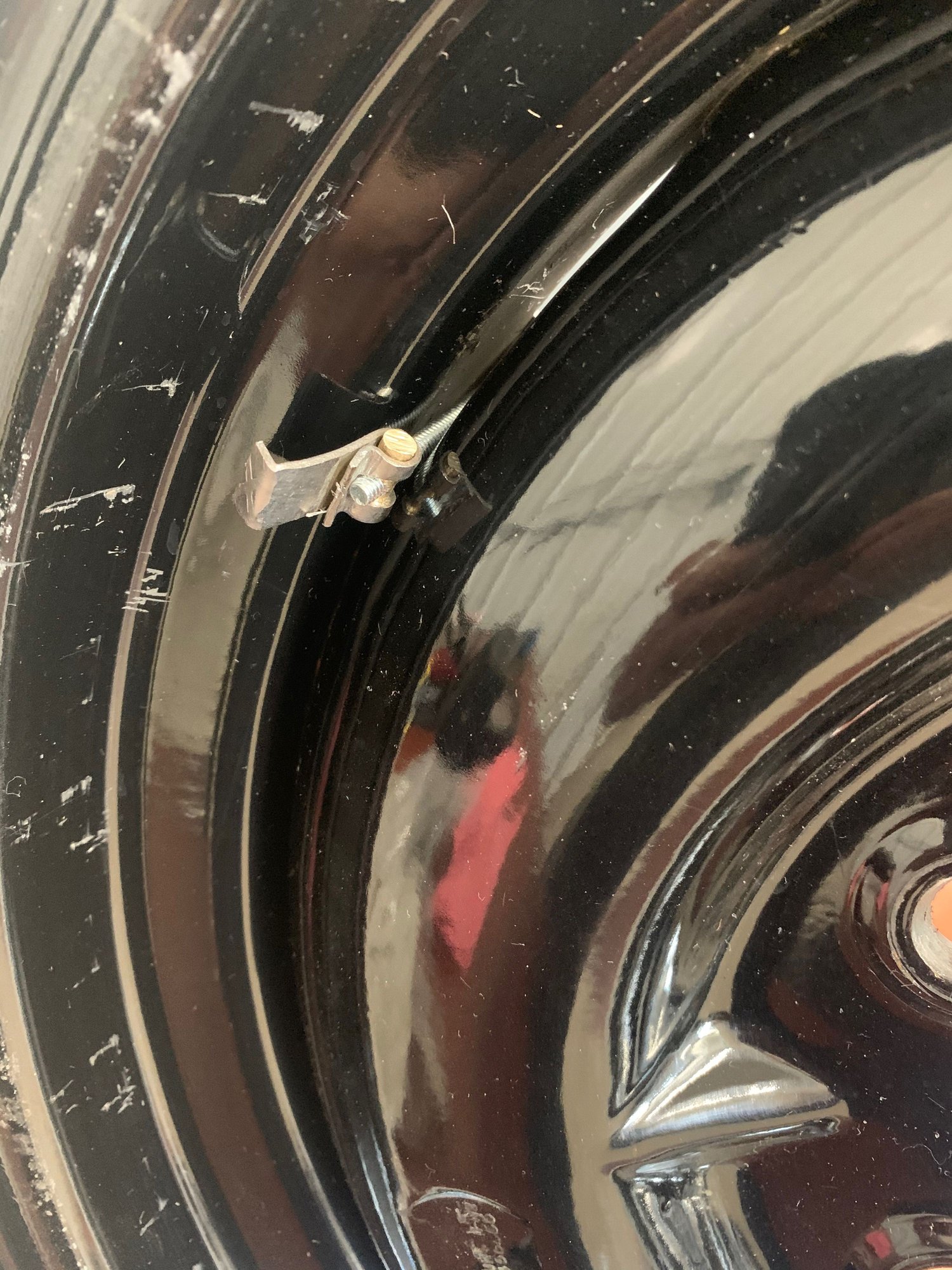

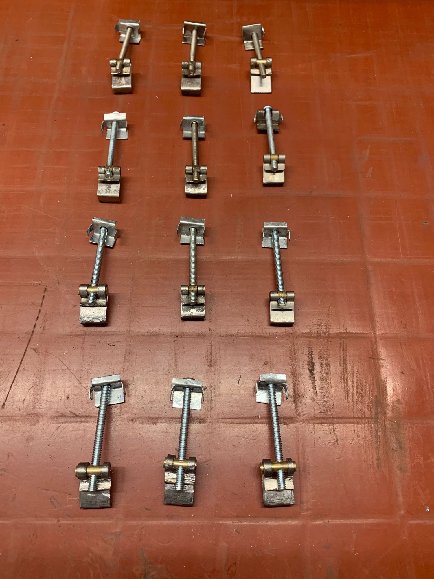

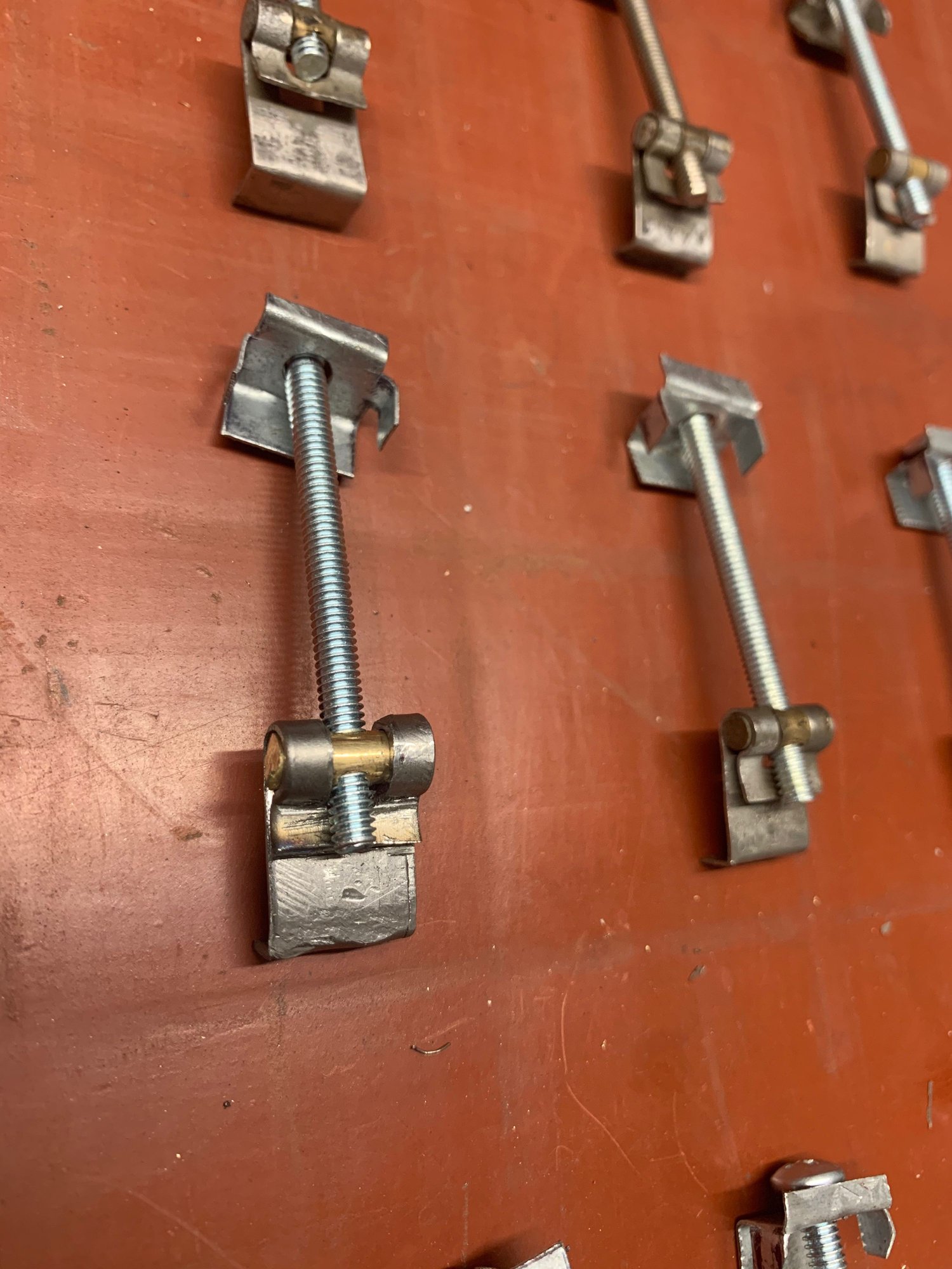

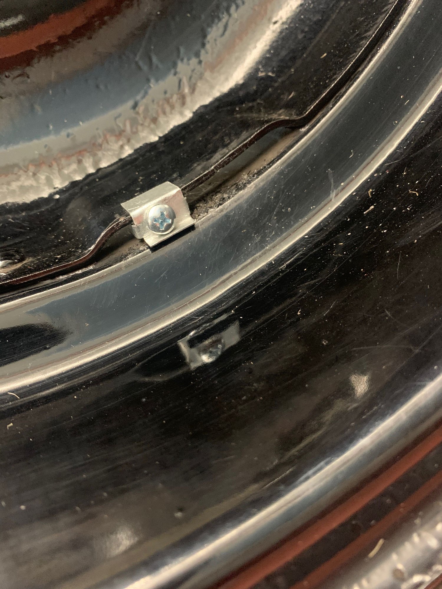

Its been a long time but I thought I would do a followup on these clips. My solution of using aftermarket rims didn't last. This past summer one of them took its own trip and and the following truck made mince meat out of it. So I decided to try to make my own clips. I still had a couple so I used them as my template. I got some 18 gauge steel and cut it into strips. Found some 1/8" brass rod, drilled it and tapped some threads. I used 8-32 screws. Just bent the pieces in the vice to shape and trimmed with a tin snips. I had the correct trim rings in storage when I first started working on the car and hung onto them in case I ever got to this point. Tried them on and the clips worked great.
For some reason I didn't have the patience 7 yrs ago to do this, but I'm glad I got it done. Hope you can use this info. Mike
Bent the steel strap over brass rod for shape. Then cut the slot.Brass rod cut to length, drilled and tapped.
A couple of these are original Can you tell which ones?
Outside of wheel
Inside of wheel
There is low tension on the clips, and they hold fine.
