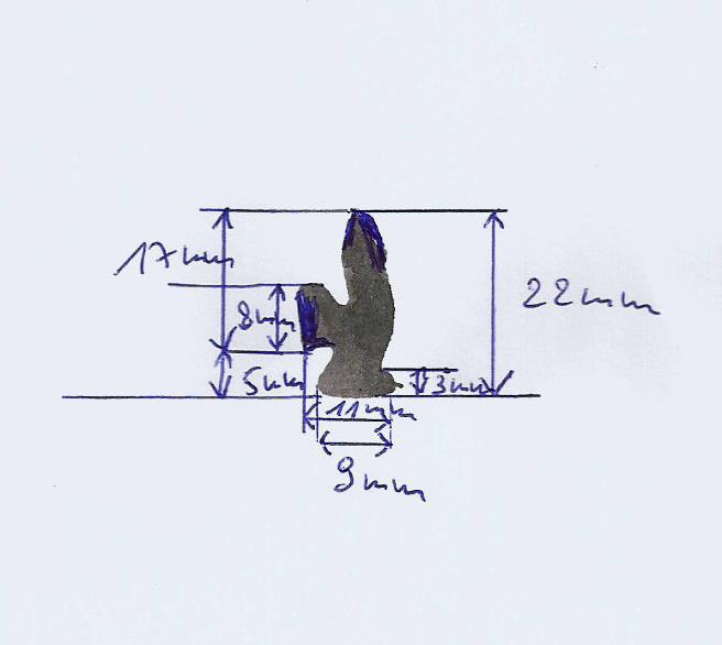

I ordered a custom made rubber inner seal for the doors based on a drawing I made of the original seal ; the custom made seal is not perfect (a bit too big and not very flexible) and hard to fit (about a whole afternoon for a whole 420g), but once fitted and you slam the door, the 420G is firmly closed and the seal does not leak (even in severe rain) ; if anyone is interested in improving my design, please feel free to contact me Jaguar Mk X / 420G doors rubbers-rubber-inner-seal-door.jpg
