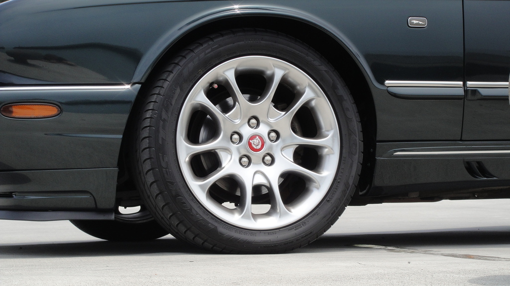

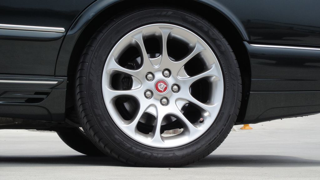

I should say the result is great.
The front spoiler looks like it was a factory fit (beware, the spoiler lips under it were not included).
The side skirts cover the flange and the jacking points, just as intended (and as Jaguar should have done initially ).

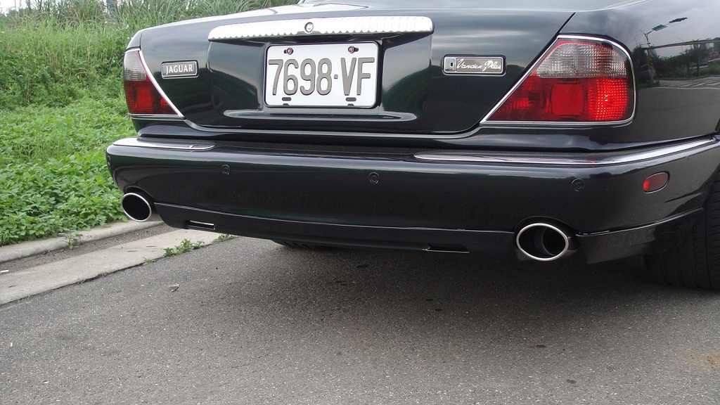

The rear bumper now flows from a much lower point behind the rear wheels, but keeps it gracious lines.

Hey Eric, did you toss aside the chrome stripping? As said in the other thread...very nice sir, very nice...it looks like you dropped her an inch. For the jack points, I personally would just go with a flat black arrow that somewhat masks it in the paint, but is showing where it is. I use a low profile dual pump jack anyways, I've never used the factory one.

There is a recess in the side skirts, but nothing in the front or rear.
my VDP already has the chrome from the bumpers extended over the doors, which I think is enough.
However, if I should install an other line of chrome, I want it to be parallel, which does not coincide with anything on the front or rear.
Need a sunny day to watch and think a bit more, but probably leave it as it is.

There is ~2" between the skirt and the jack point, not enough to slide the jack in.
I cut a fair piece of the jack's upper arm (the part which actually slides inside the car point), but will need to weld a support to prevent the jack able to come out. Not a biggy, and will be totally safe afterwards.

I paid ~700 usd extra, which is probably double than what it should have costed me here in Taiwan.
However, I am in the middle of moving, with many other things happening, so coughed up the extra cash.
All I did was sending them the Jaguar color code (HGL), and it just worked out perfect. Of course I had my worries, but it is spot on.
I am not sure they can do HGG, but considering the workmanship in Japan, they probably can.

Take the side skirts, they are bolted front and rear, and just those 4 bolts are holding the skirt so tight that basically you will not even need the tape.
I can guarantee you that once you see it, you will agree.
No worries needed there.

Wheels are "Double Fives", Optional on the ~2001 XKR's.
They come staggered, 8Jx18 in the front, 9Jx18 in the rear.
Tires are F245/45 and R275/40.
The tips are from Resistanz, sold in the UK, beautifully made and perfect service (they sent me a replacement for a slightly damaged one half way the world, free of charge).
Personally I think their diameter is a tat to large under a standard bumper, although they fit perfectly with the body kit.
