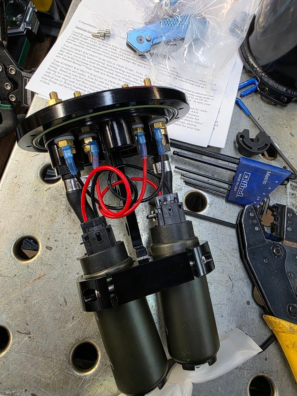

Last up was the fuel surge tank. Here it is out of the box.
I removed the lid and flipped it over. You can see the holders for the fuel pump as well as the connection points.
Here are the pumps wired and plumbed before I tighten up the bracket and reassemble.

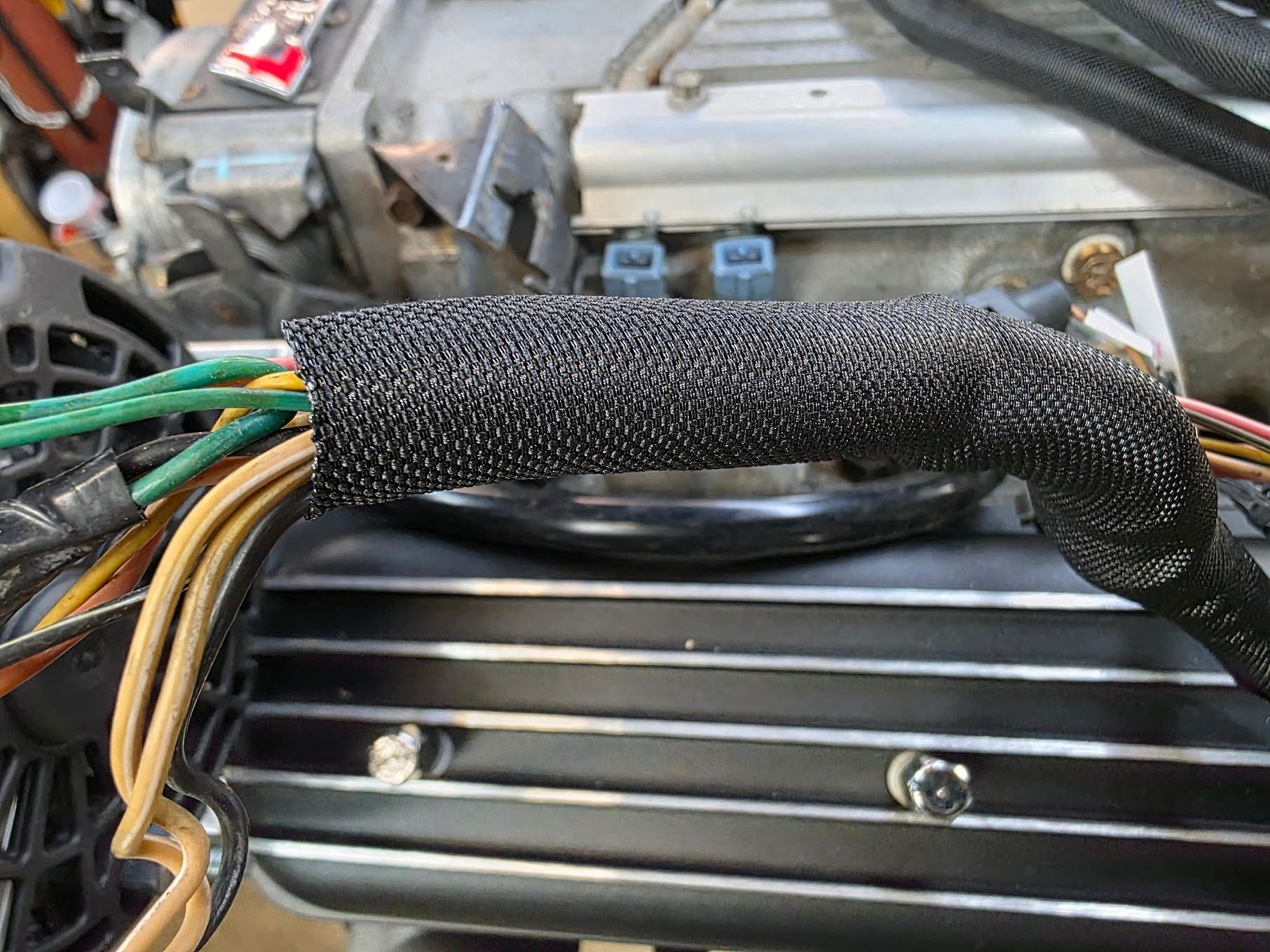

I worked on several different items today, including starting to wrap the engine wire harness.

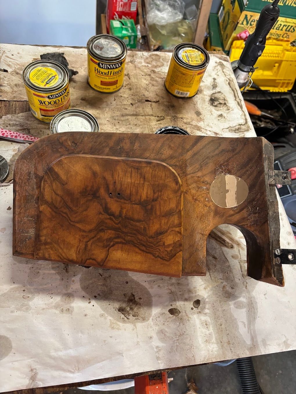

With the warmer weather Dad has been busy refinishing the wood. This is the dashboard section on the left side of the car; the steering column fits through the upside-down U and the automatic transmission gear selector goes through the hole above that. To the left is the door to the glove box.
Dad refinished the glove box door today. We also talked about the round hole for the automatic transmission gear shift lever. Since I am converting to a manual transmission I don't need the hole in the dash. I thought about putting a clock there but decided at the end of the day I'd rather have nothing. Dad made a plug to fill the hole and will veneer the whole piece. I'm not sure if he is planning on veneering the door but I think he will need to so the grain matches. I'll ask him tonight.

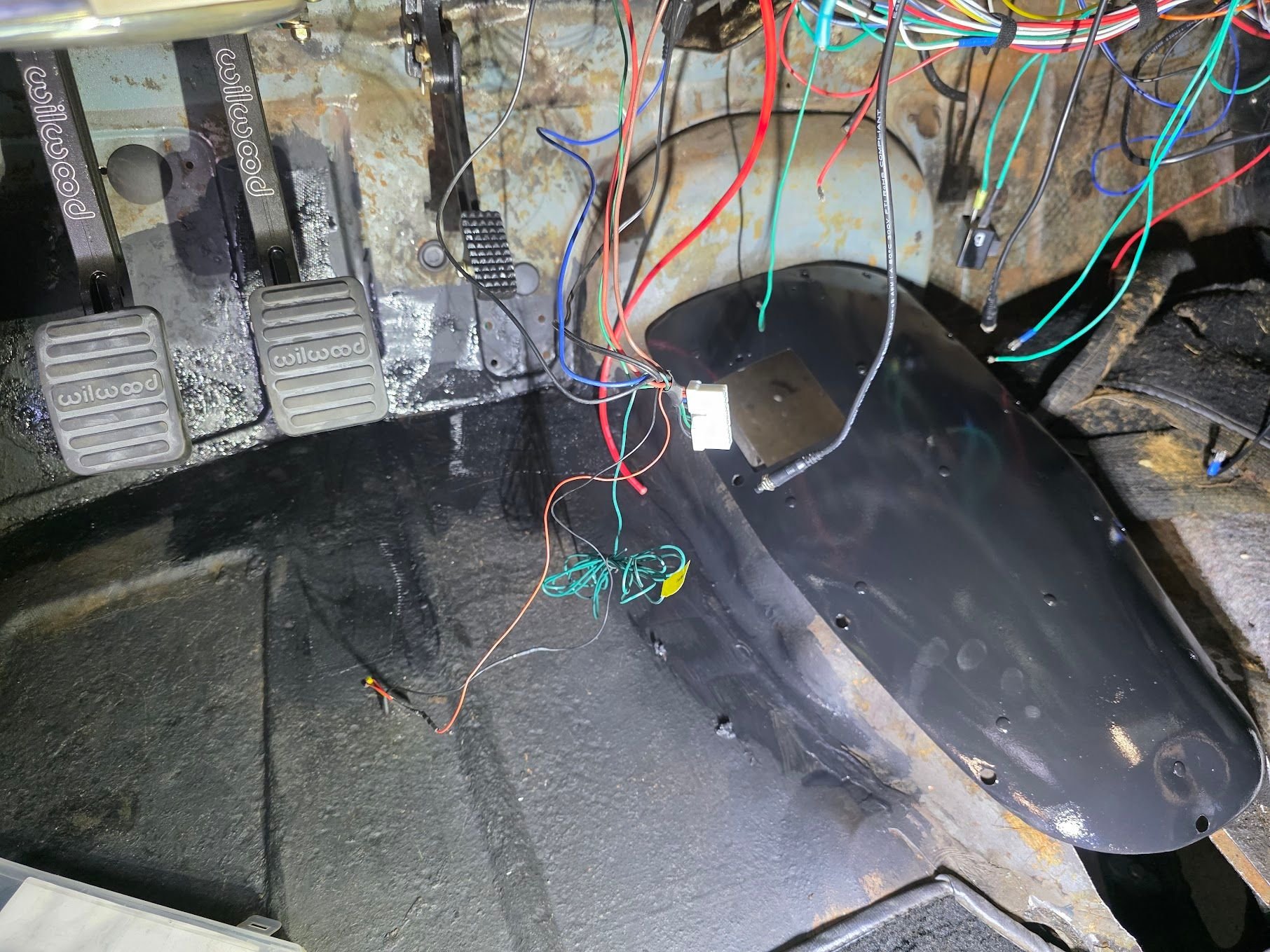

After that it was more clean-up of wiring. I wired the brake lights to the new switch on the brake bias adjuster and removed all the wiring for the Davies Craig water pump controller I used on the XK engine. I also ran a new fused & switched wire to the front of the car for the electric water pump on the LT1. I have a few more things to clean up like the high beam switch. The clutch pedal is where the original high beam switch was so I need to see what my options are for something mounted under the dash.

I had a busy day in the garage, mostly around wiring. I added an "always hot" fuse panel under the dash for a couple of circuits on the new engine. I also found a spot for the LT1 engine computer and a new spot for my PWM radiator fan controller. I also got both fuel tanks tucked back into the rear wings and have them bolted down.
