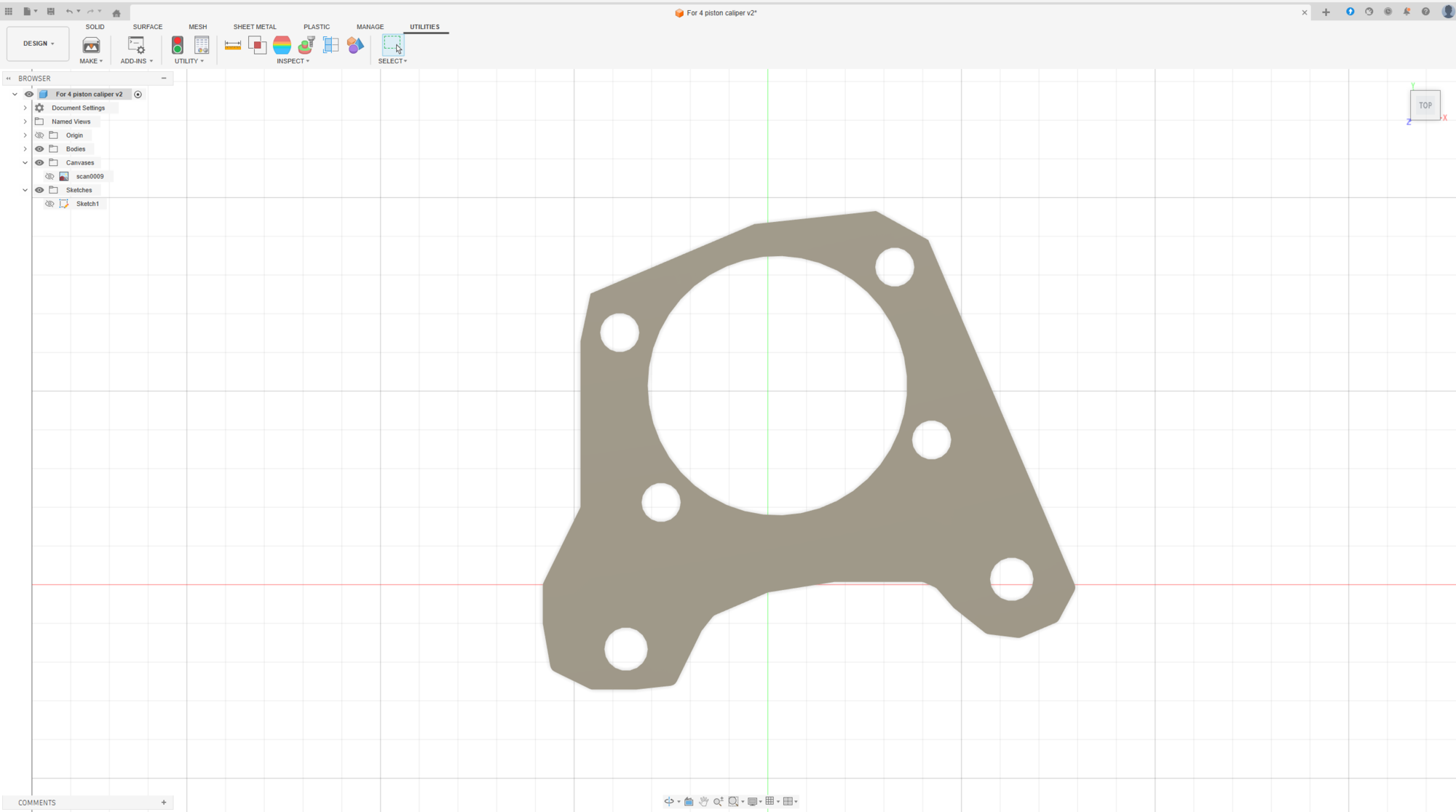

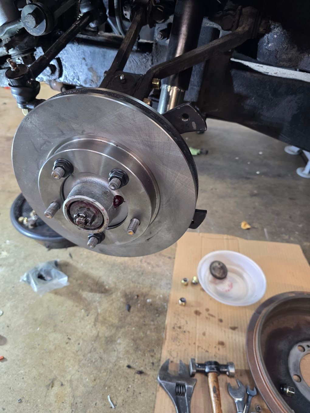

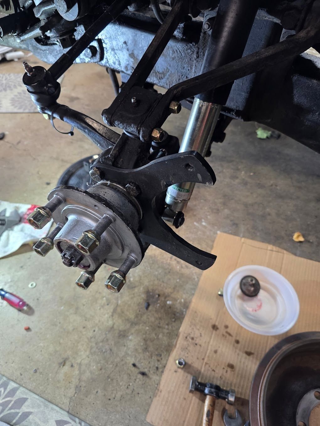

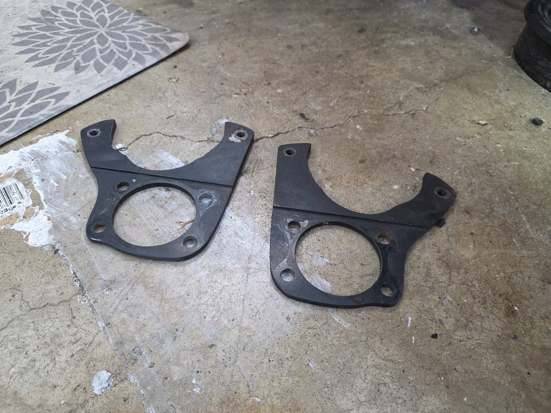

About 10 minutes after I made yesterday's post, I remembered this summer I was playing around with a disc brake conversion for my car. Over on the "other" forum, there is a thread called Mark VII Disc Brake Conversion where someone put together a list of parts he used to convert the drums on his Mark VII to discs. It's mostly custom made parts, or heavily-modified off-the-shelf parts, but it's a start. The thread is almost 25 years old (an eternity in internet time) but I reached out to the poster over the summer and he sent me the front brackets in exchange for me making them available to other Jaguar enthusiasts.
You can download the file here and take it to a place like SendCutSend to have it cut. The name of the file is Front Bracket - Original - v2.dxf
I loosely bolted them in place today.
This is the brake disc from a 1975 Cadillac Eldorado that conveniently has the same 5x5 lug pattern as the Jaguar, although the center bore needs to be opened up and the back of the bolt holes need to be opened up.
I decided to make some modifications to the bracket so I could use the brake calipers from a 2005 Buick Century.
