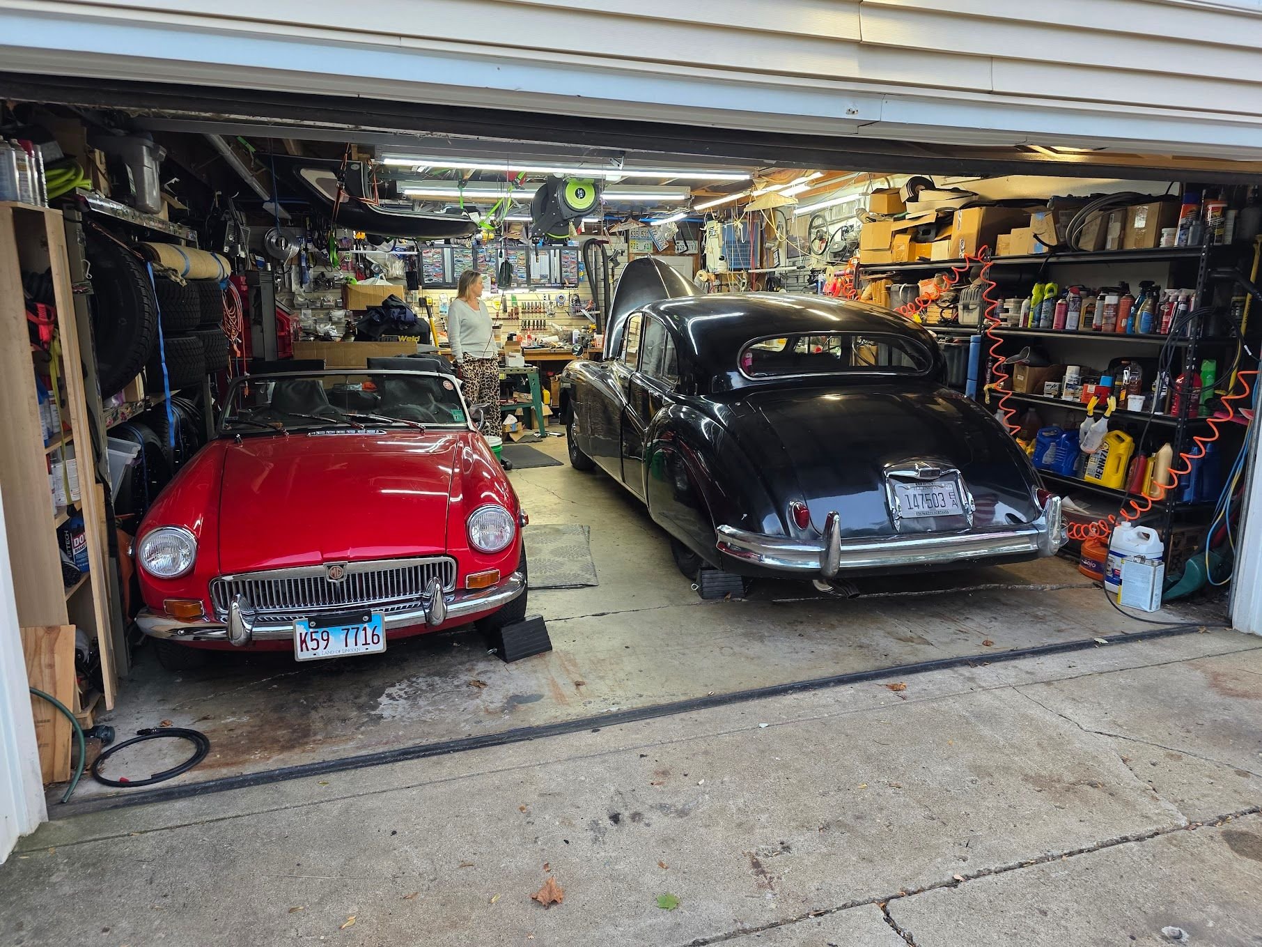

After towing the Mark VII home, it's safely back in my garage while my wife surveys the damage.
I should be putting things away from the trip but I did run a compression test. The numbers aren't great but they also aren't catastrophic either.

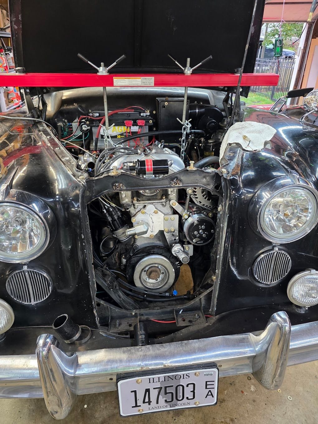

This morning I had to change the oil and rotate the tires on the Land Rover, but by the time lunch had rolled around I was all caught up and able to start working on the Jaguar.
First up was pressuring washing the bottom of the car. This had the secondary effect of draining most of the oil from the heads.
I pulled the gas tanks and completely drained them, then blew compressed air through them for 30 minutes to remove any residual fuel and vapors. I won't have to worry about fuel going bad over the winter.
Next up was pulling the transmission. I was glad to see the fluid still looked brand new - I know there's only 800 miles on the transmission but that tells me I had the TV cable adjusted properly.
I used a bar to support the rear of the engine while I pulled the transmission.

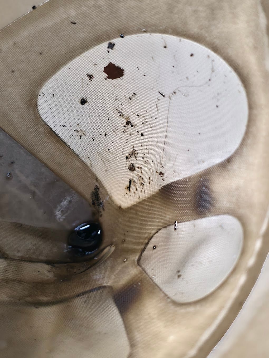

I drained the first gallon of oil from the engine crank case into a paint filter. Earlier this summer I had pulled the oil pan and cleaned it, so the offending bits of metal you see below are new.
Next up is pulling the head, followed by the block/crank case. I'm going to tear it all the way down until I find the culprit.

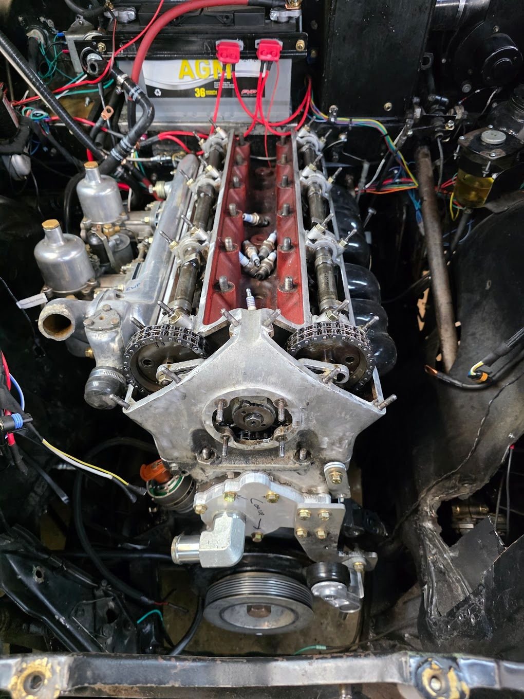

Today at lunch my neighbor came over to help remove the hood, then this evening I pulled the head and engine.
I promise, the wiring did not look this bad with the engine in the car. I'll address this before a new engine goes in.
I'm starting to form a theory of what happened, but I'll save that to the end.

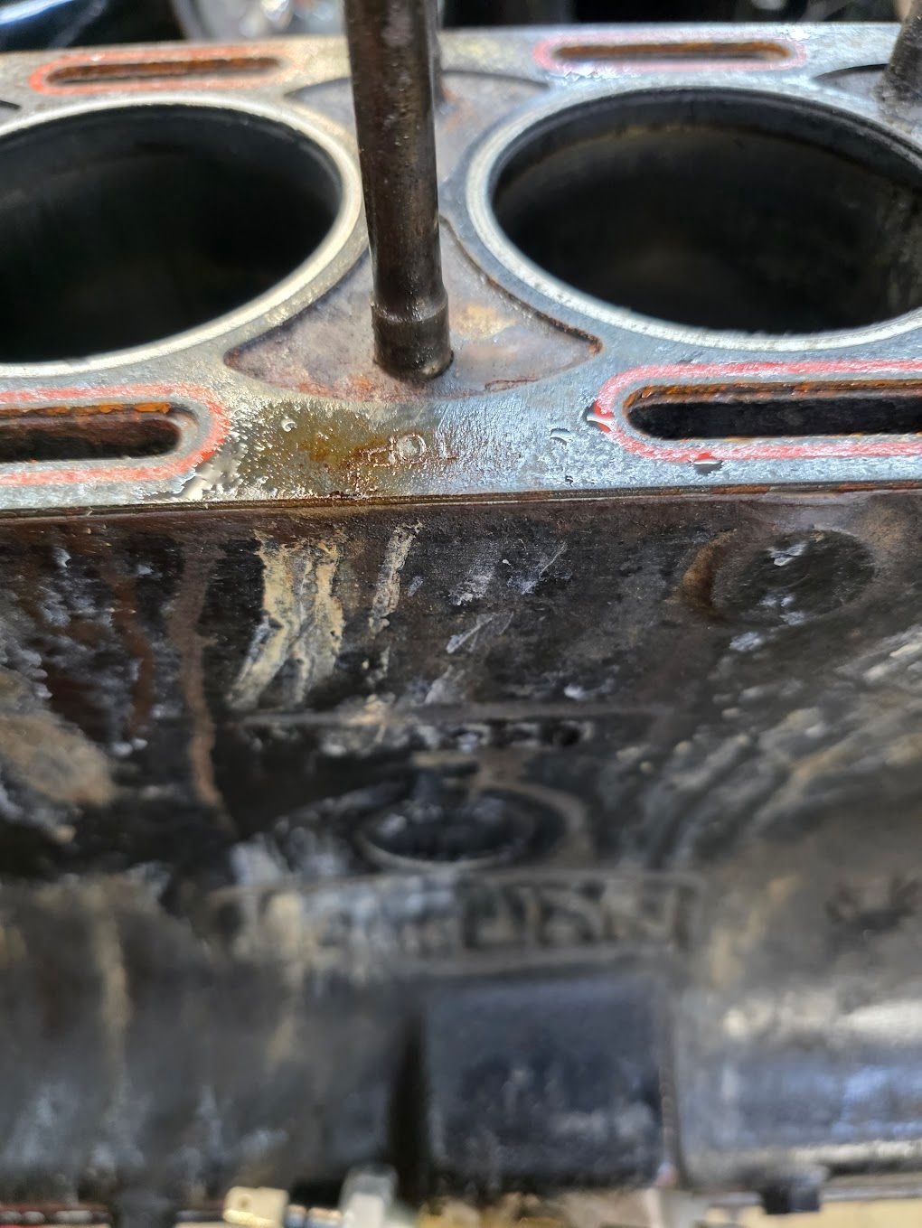

Here is the right side of the block showing the coolant staining (I use Zerex G-05). I'll note that the coolant level wasn't significantly low - maybe .25" lower than normal.
The head showed no burnt valves or damaged camshafts.

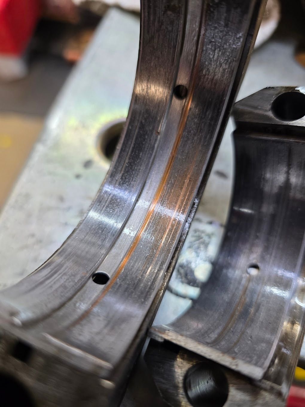

I pulled one main bearing and one connecting rod bearing. They both looked like garbage.
The crankshaft journals don't look great.
My theory is that some of the coolant got into the oil via the head gasket. It was probably just enough to cause a lubrication issue for an engine turning 2,700 rpm, which didn't do the bearings or crank shaft any favors. I bet when I finish tearing down the engine I find a spun bearing or two.
