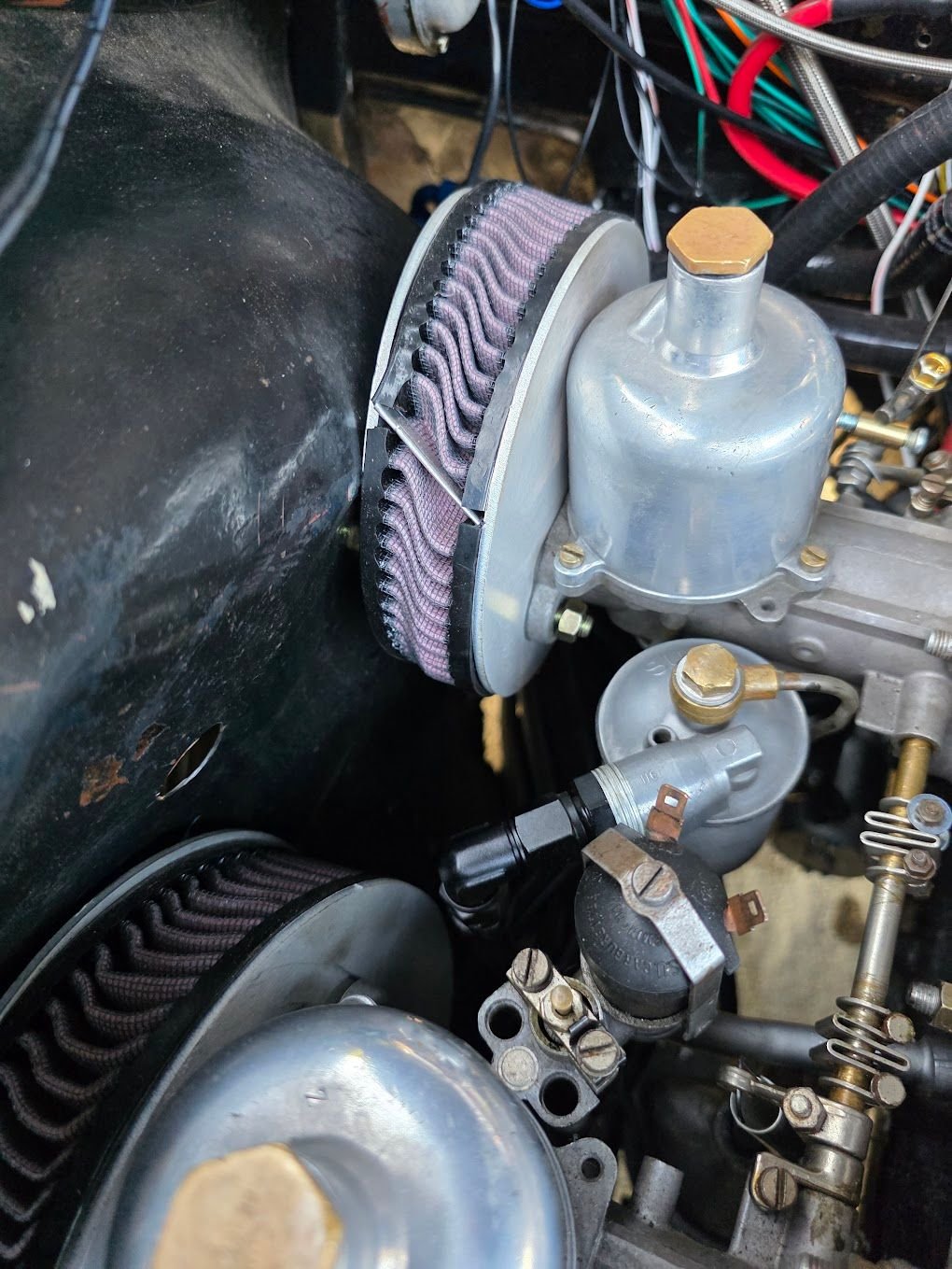

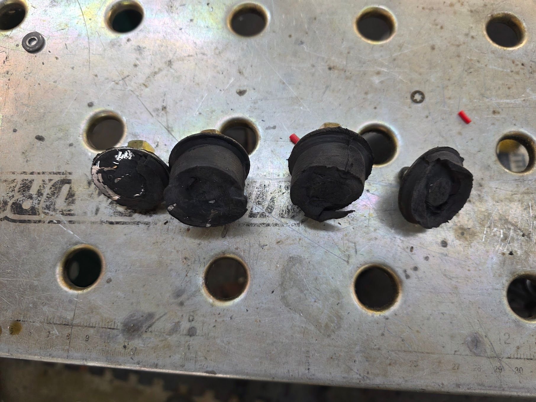

I had a great 25 mile drive today. Went and got a hair cut, filled up the right tank, took it on the highway (no starvation issues!), stopped by the tire shop to schedule an alignment. All was well with the world.
Then I was looking at the engine and noticed it seemed crooked. Then I looked at the air filters and saw they were both crushed.
I knew what was wrong without having to look. My new motor mounts lasted all of 30 miles before they sheared in half.
Here's a view looking towards the front of the car.
I'll call Moss on Monday but I'm not putting another set of their mounts back in. I think I'll spend some time in the Summit Catalog tonight and see if I can find a universal mount that might last longer.

That is not just incredibly frustrating, it is inexcusable!

That might explain the failure of the throttle coupling.

The throttle coupling def happened first. I know exactly when the mount failed - I had floored it getting onto the highway and held WOT for an extended period of time. It was just too much for the cheap rubber to hold. When I got to the exit ramp I went to shift the transmission to neutral and couldn't because the mount had collapsed.
I spent some time last night looking at motor mounts on RockAuto and came up with a few possibilities. I also ordered two different universal mounts.

Great resilience,Thorsen. I would ask Moss to pay for the air filters too. That failure is dangerous in the extreme.
There is a general problem with aftermarket Jaguar rubber parts across all models. On my car, I have all genuine rubber parts and good second hand ones in stock; but failures within weeks of mounting non-metalastik parts are extremely common. I had a very bad experience with rubber parts from what are meant to be good aftermarket suppliers, before i knew better.

Here are the Moss motor mounts I pulled out yesterday. The left side mount may have failed as a result of the right mount failing but I'm not sure.

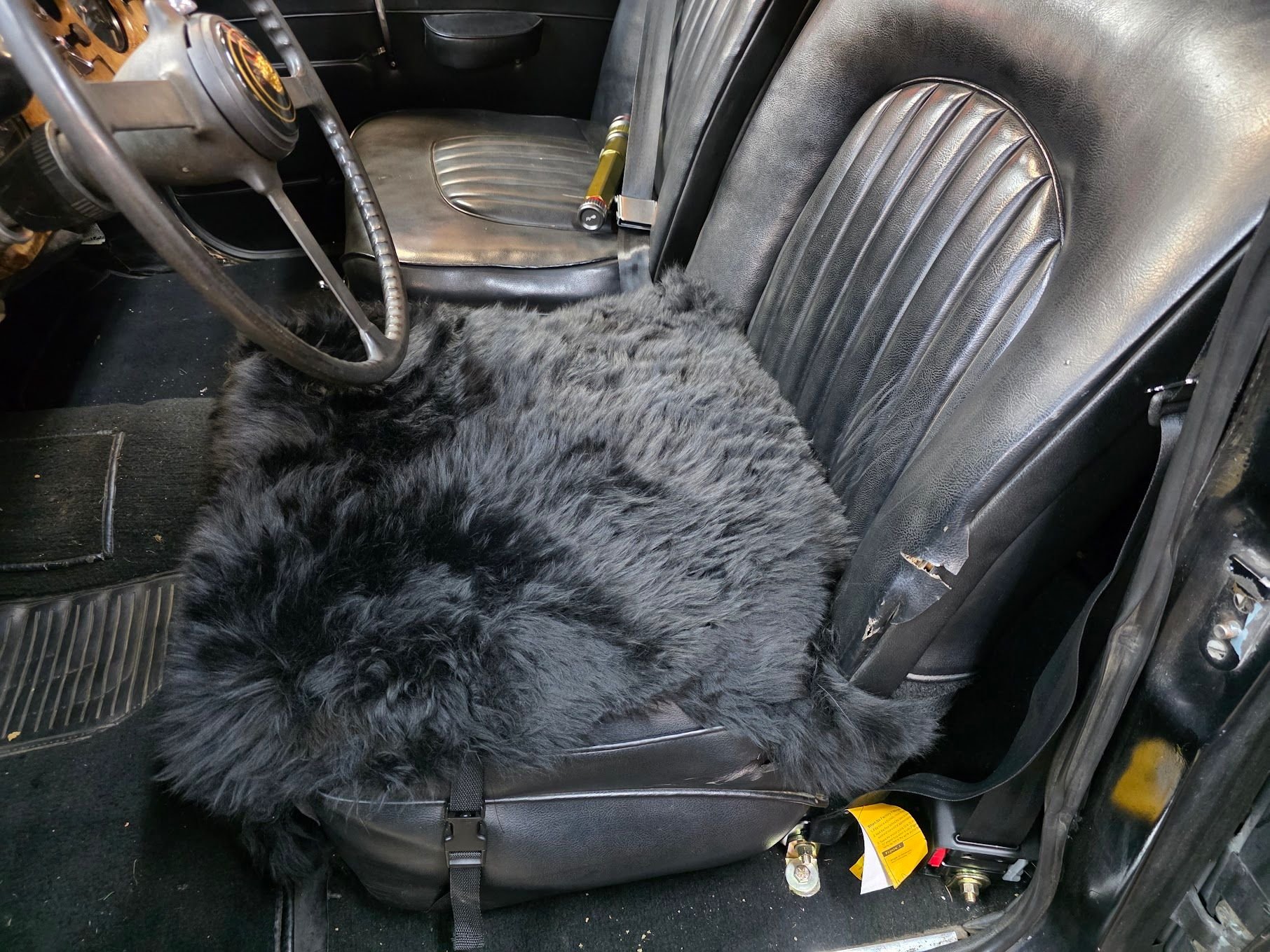

It's been warm in Chicagoland recently and while the "AC" system does a good job of moving air through the cabin, the vinyl seats are not very forgiving. As I think ahead to my 2,000 mile road trip later this month, I know I don't want to sit on these seats for a week. A set of sheepskin seat covers seemed like a great short-term solution to my problem, but I could not find anyone that was making them for the Mark VII. The universal ones were $300-$500 and looked like the fit would be iffy. So I took it upon myself to make my own.
Amazon sells sheepskins; I've had one on my desk chair in my office for the last 3 years and I spent 10 hours a day sitting on it. It's comfortable and durable so I decided to try it out. I started by sewing straps to the back edge.
The bottom section strapped in place - it's not moving anywhere.
The seat back followed the same process as the seat bottom. Straps to hold it in place and cinch it down.
I'm not a fan of the way this looks, but it's going to be more comfortable than sitting on old vinyl.
