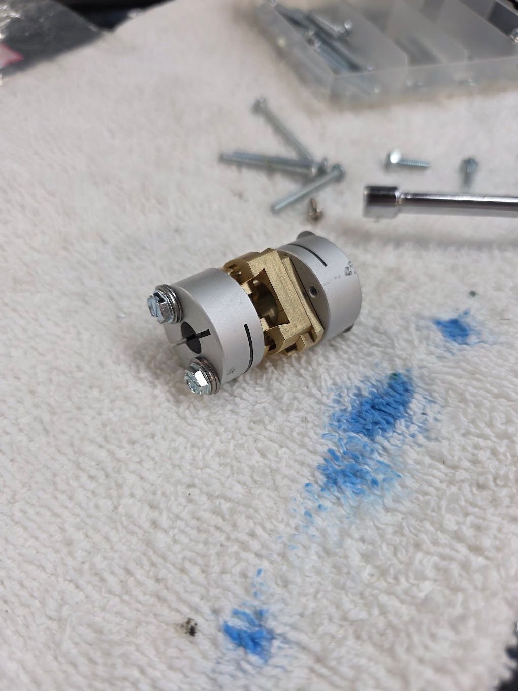

I had to cut it short because of this piece of cable that connects the throttle linkage on the firewall to the throttle shaft on the carbs. It's purpose is evident in this picture; it allows for movement between the engine and the firewall.
The problem is that there is a lot of slack in the piece of cable, and the clamps often rotate on the shaft. The slack in the cable, or the unwanted rotation of the clamps cause the same issue - the transmission (courtesy of the throttle valve cable) thinks the throttle is at one position while in all actuality it is less. This is bad for the transmission as it will burn up the clutches. I need a better solution.
I can use an Oldham coupler to allow for the misalignment, but I fear that I am asking it to do too much. The ones that I linked only allow .0008" of parallel misalignment, albeit at 4,500 rpm.
I'll spend some time on Summit Racing tonight and see if I can find a way to fab a cable system.

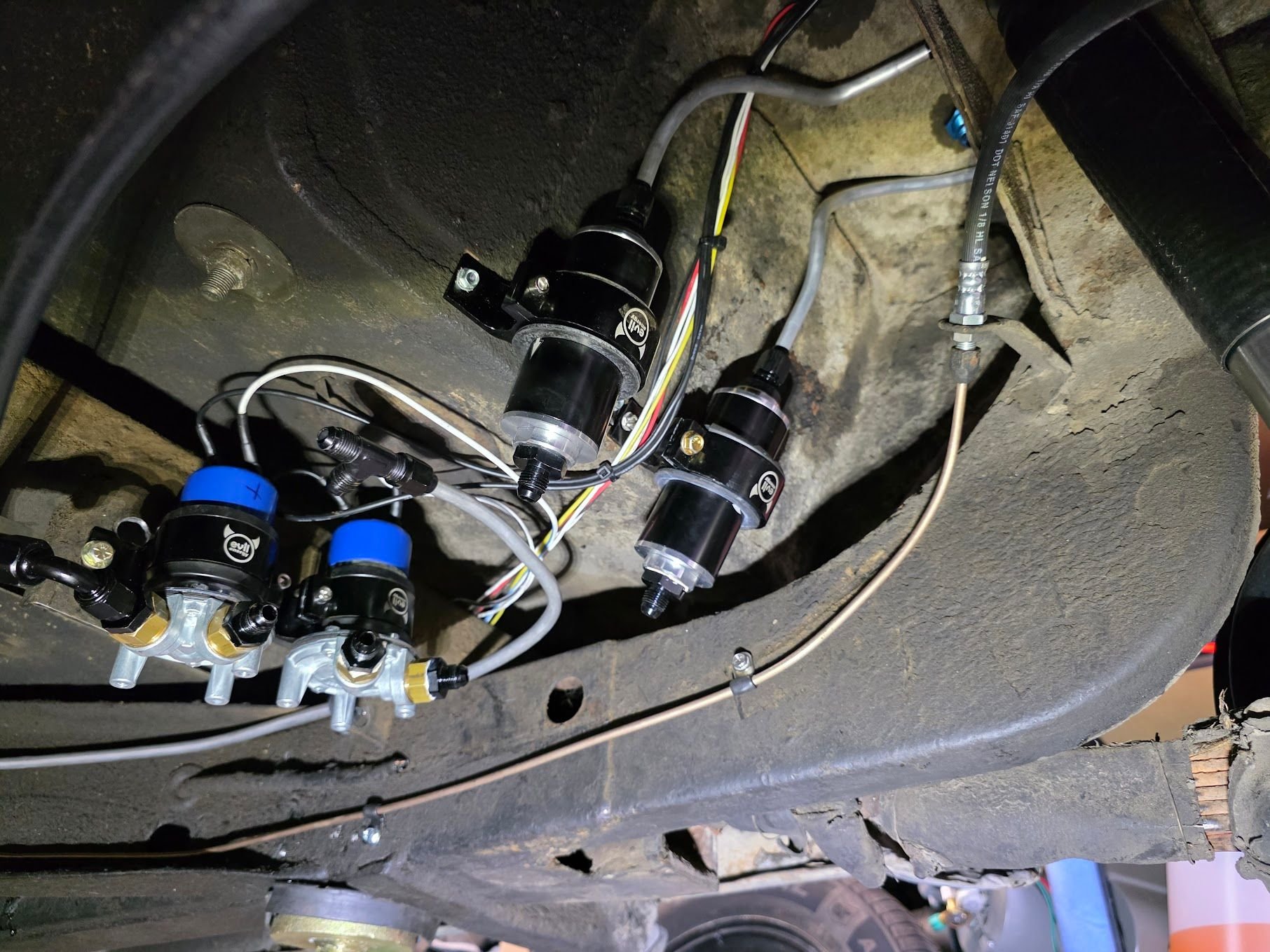

Next up are the fuel pumps. These are positioned above the center of the fuel tanks and I think they are loosing the fight against gravity. I think I am going to move them to the trunk floor so they have less vertical distance to pull.
I was able to confirm my theory tonight. On this morning's drive I had put a GoPro camera in the rear window; the fuel pump noise was audible since the camera was right over the speaker grill and directly over the fuel pumps. I had accelerated hard and you could hear the fuel pump giving it all it could. When I felt it running out of steam you could still hear the pump clattering away. I had coasted about 500-700 feet and when I stopped you could hear the fuel pump catch up and go back to a tick every second or two.

I think fuel pumps of that type need gravity feed Thorsen or burn out is a distinct possibility. Definitely move them lower, say I.

I need four AN hose ends and I will be able to finish replumbing the fuel pumps. I wasn't super happy about having them under the car but from a functional standpoint it was the best place for them.

Another busy night in the garage but much was accomplished. I was able to complete the re-plumbing of the fuel tanks and I am happy to report that both pumps now prime quickly and easily.

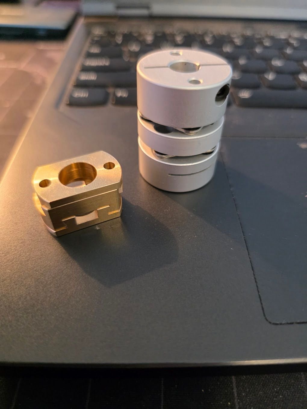

On to the throttle linkage, I bought a 36" accelerator cable but was surprised to learn that someone started measuring by the length of the inner cable, not the outer cable. I'm not sure who came up with that great idea but that's going back to Amazon.
What was delivered was an
Oldham Coupler Oldham Coupler
(on the left) and a
flexible coupling joint flexible coupling joint
(on the right). I had high hopes for the flexible coupling joint but it had an extremely limited range of motion.
I was able to disassemble the flexible coupling joint and bolt the Oldham coupler in the middle.
This gives me the range of motion I need with no slack action. It's very smooth and works well.
I did need to extend the shaft by about 2" but that was easy enough. I'll test this out for a few miles and if I don't like it I'll move on to the cable idea.

The coupler looks terrific, by the way; but how do you know about such things??
Dad asked me the same question last night and I didn't have an answer. I think I saw a video showing one once and filed it away.

The oldham coupler lasted all of 2 miles before the center section fell out and left me with an engine that would only idle. As luck would have it I was about a mile from home so I adjusted the idle screws to 1,800 rpm and limped home on the shoulder. I pulled her right into the garage and converted to a cable pull.
