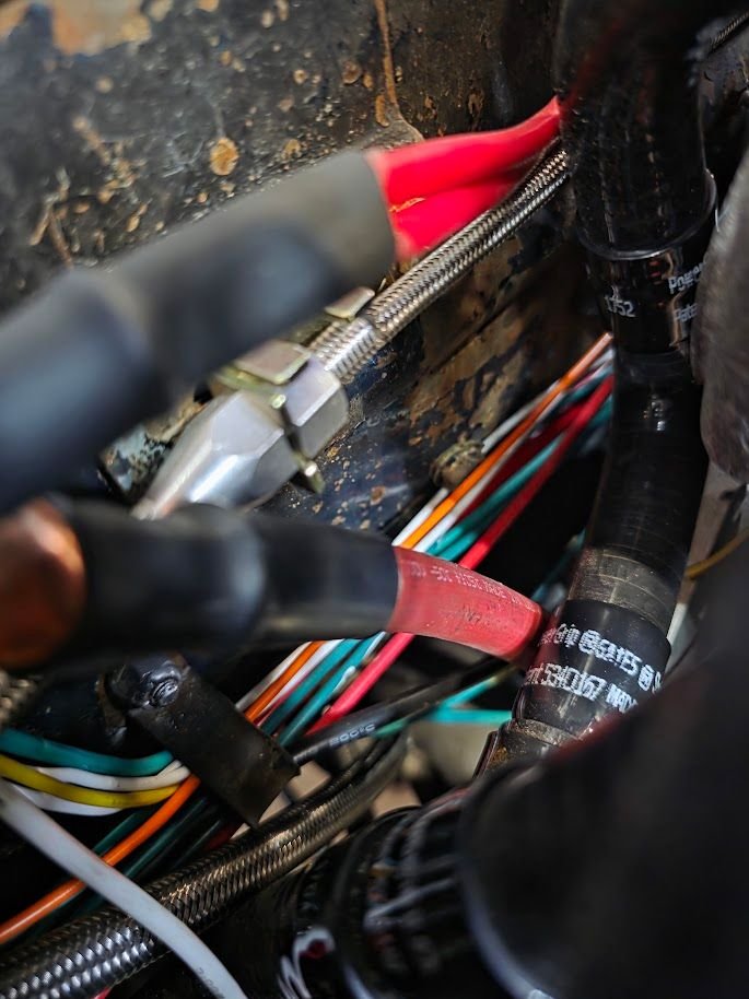

Tonight I was able to resolve the issue with poor fuel delivery from the left tank. After hooking my backup pump directly to the tank and observing low fuel flow, I decided the obstruction was internal to the tank. I disconnected the feed pipe from the tank and ran a section of weedeater line through the pickup line in the tank. At first it would only go in about 12" but after working it in and out a few times I was able to feed in about 2 feet. I think there was some of the tank liner obstructing the pick up tube because when I knocked it free I suddenly had strong fuel flow.
Interestingly enough, I blew air through the pick up line when I got the tanks home and there was no noticeable obstruction.
I took it for a high speed 15 mile drive on the tollway and I no longer have fuel starvation issues. This problem is solved.

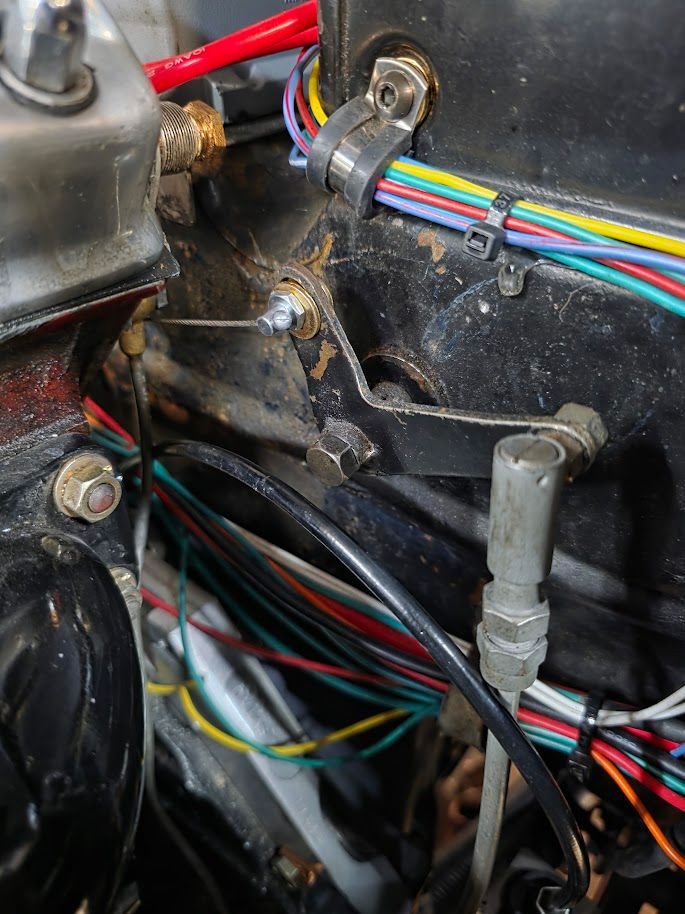

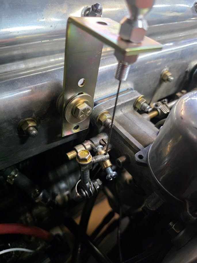

Good find. Can we have a photo of the throttle cable setup please?
Because I needed to keep the geometry of the TV cable for the transmission, I simply replaced the pushrod along the firewall with a cable. In this picture, the push rod on the right side of the bell crank goes down to the accelerator pedal and the left side is the new throttle cable.
This is the other side of the engine compartment. It's tough to see but the right side of the picture is where the outer cable starts. To the left side is a spare section of outer cable to keep the inner cable from sawing any wires or hoses.
I mounted a simple bracket to the intake manifold and the outer cable attaches to that. The inner cable attaches to the throttle shafts

Thanks thorsen. Elegant, safe effective, congratulations.

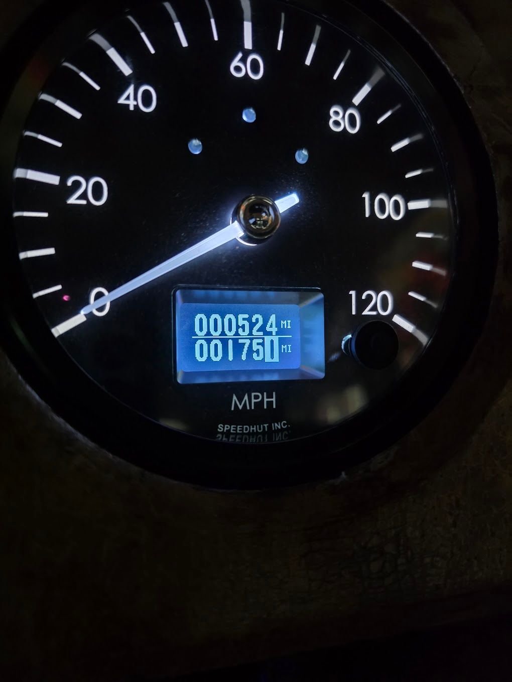

I'm up to 524 miles on the car, including almost 200 miles I put on her today with a beer run into Wisconsin.
She's running great and that was my last test before I leave on my road trip Wednesday. Bad weather or a catastrophic failure are the only items left that can scrub the trip.
