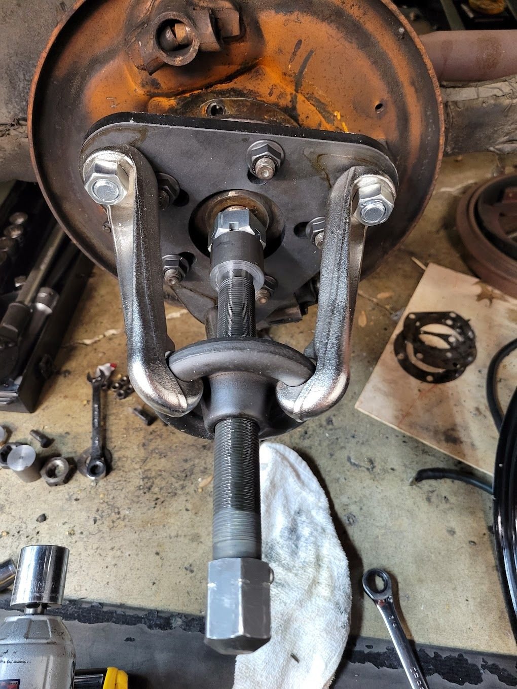

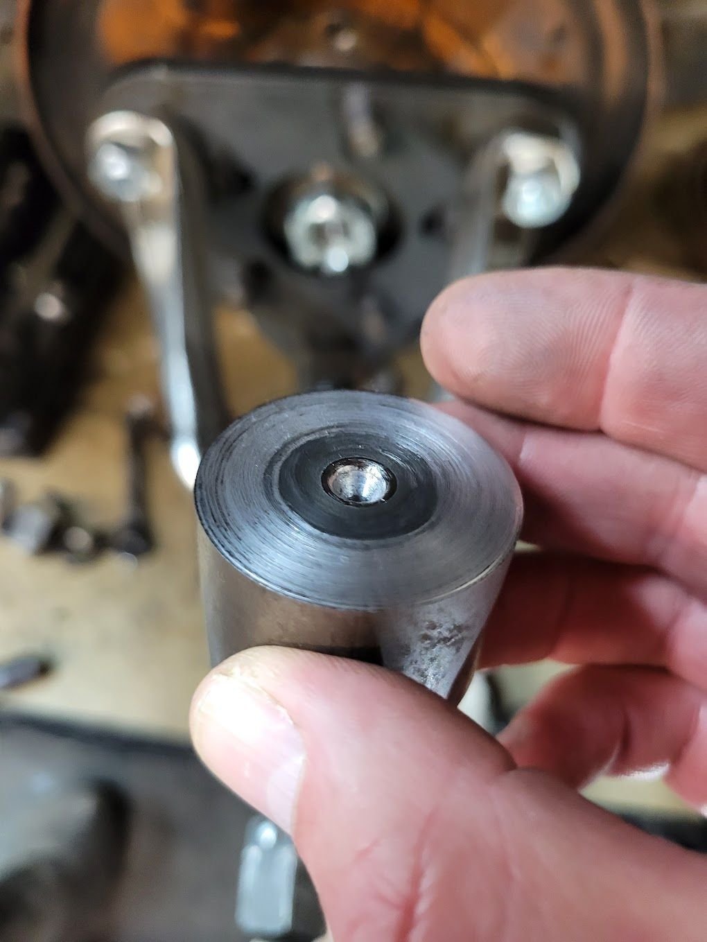

I had some good luck out in the garage today. The
OTC 6574 Hub Puller OTC 6574 Hub Puller
finally arrived and I got to work seeing if it would work on the rear hub.

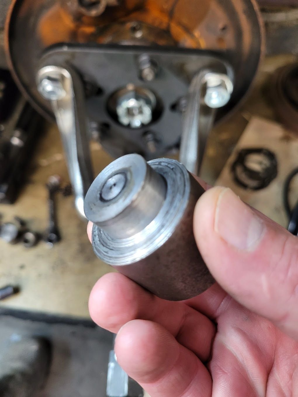

First I chucked up a piece of steel in the lathe and made a stepped rod to push on both the end of the axle shaft and the nut I had put on the shaft. I was trying to prevent the axle shaft thread from distorting.
The other end of the stepped rod got a small counter-sunk hole to match up to the OTC tool.
I bolted the plate to the wheel hub, greased the drive screw, and put my impact wrench on the end until I felt like there was sufficient tension.
I gave the end of the screw a few gentle taps with my sledge and the hub popped off with a dull thud. It was nice to have a victory.

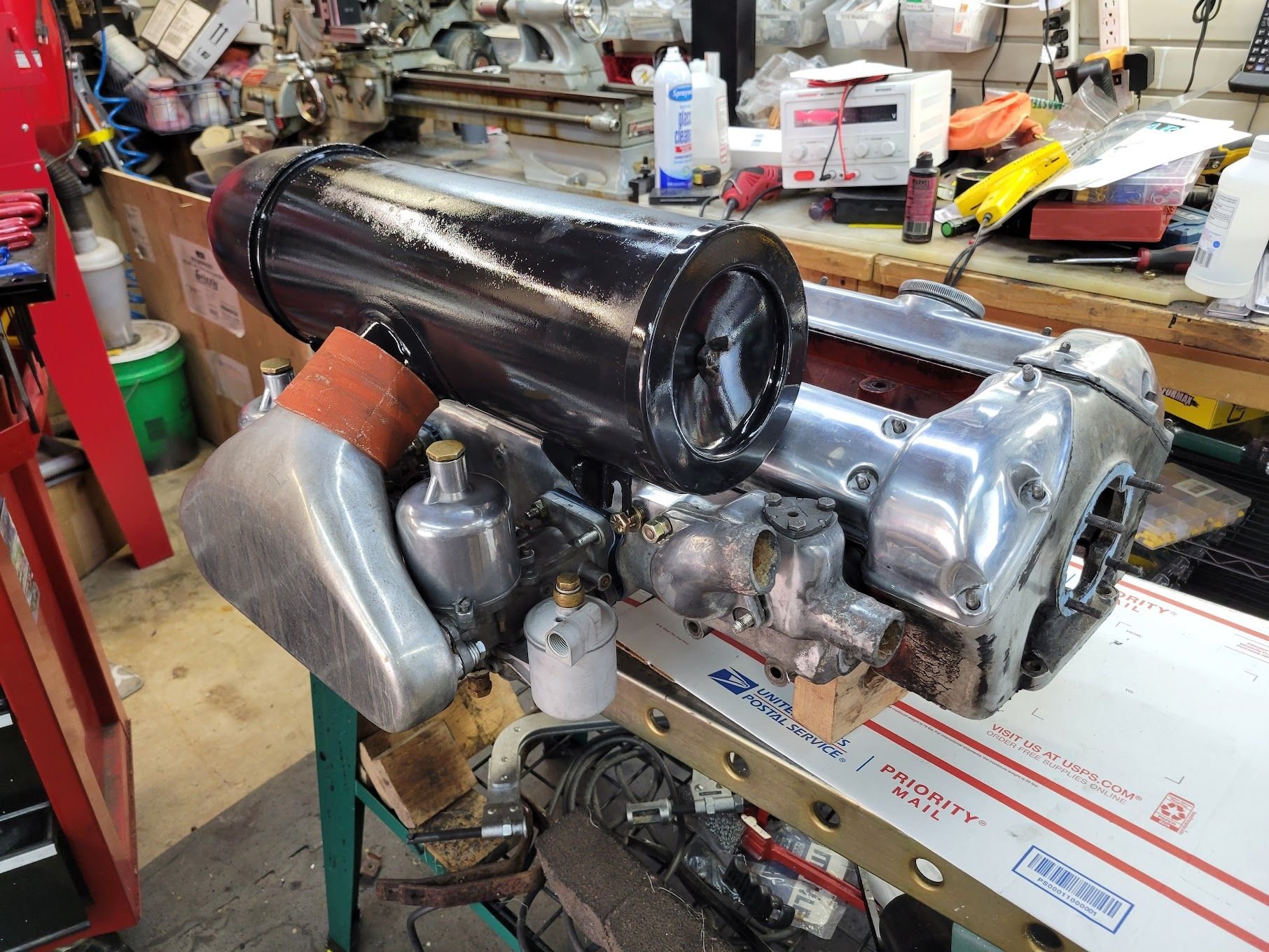

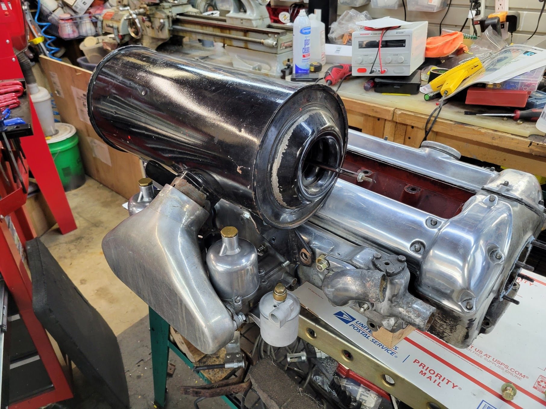

Chicago is under a heat advisory and today was a hot day in the garage, but I tried to think about all the days in the winter when I thought it was too cold. I don't know if that helped but I got a lot done.
I pulled the buffer out from under the workbench. My goal was to clean up some of the oxidization from the aluminum but not go all the way to a chrome look.
You can see the intake manifold was a little crusty looking.
After that, I thought I might as well polish the carbs too. This dashpot on the left is as-is, the dashpot on the right is after polishing but before the final Brasso rub-down.
If you're going to do the carbs, you might as well do the cam covers too.
I saved the air filter manifold for my Dad to polish - it's always good to keep him busy.
The air filter went into the sand blaster and got sprayed with 2k paint.
I'm not sure how NOS this air filter is. It looks like someone did some welding on the mounts and they are not even close to lining up. I can make it fit with some spacers.
Out of curiosity, I put the Sphinx air filter (minus the actual air filter part) on.

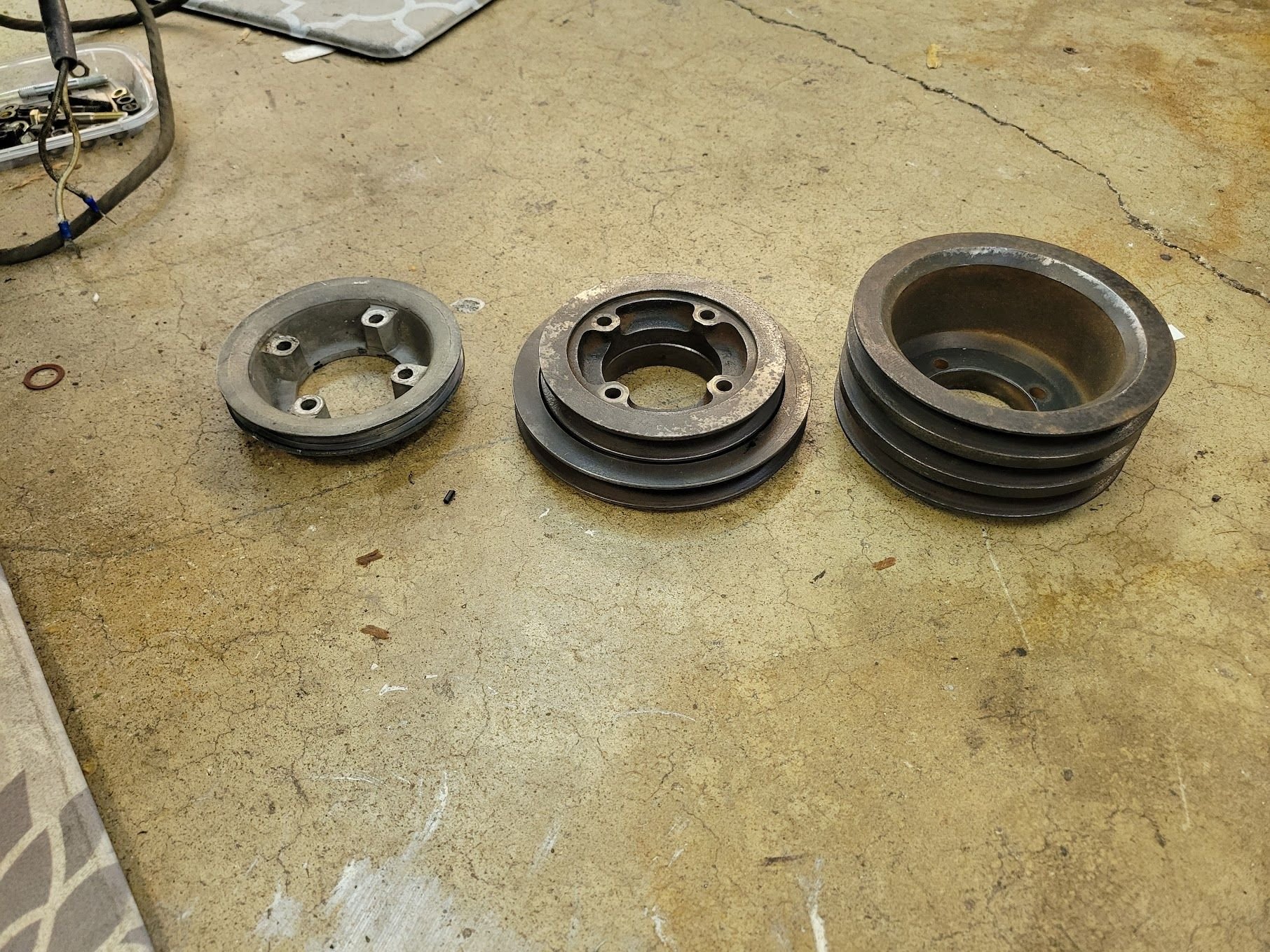

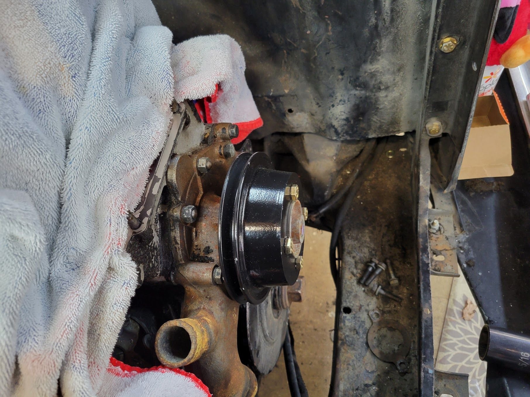

Feeling like the top of the engine was sufficiently polished, I moved to the crank pulley. If you remember I am adding an AC compressor and don't want it to share a belt with the water pump.
On the left is the original single pulley that came on the car, in the middle are the pulleys from an XJ6 (C23131, C37137), and on the right is the triple pulley from a V12 (C37892).
As I started checking the alignment of the pulleys, my mind went to how tight the space is in front of the engine. I have a radiator, an AC condenser, an automatic transmission cooler, and a fan I need to fit up here, and this water pump is taking up a lot of space. I need to do some research but I might have a way to clean this up.

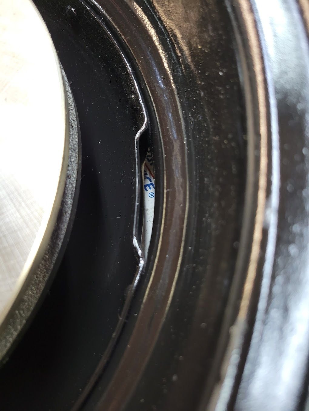

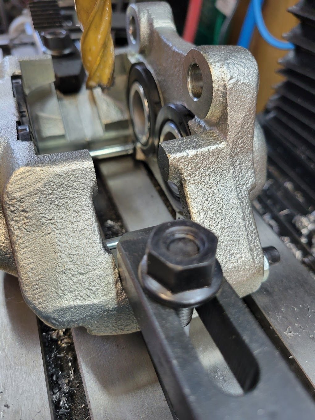

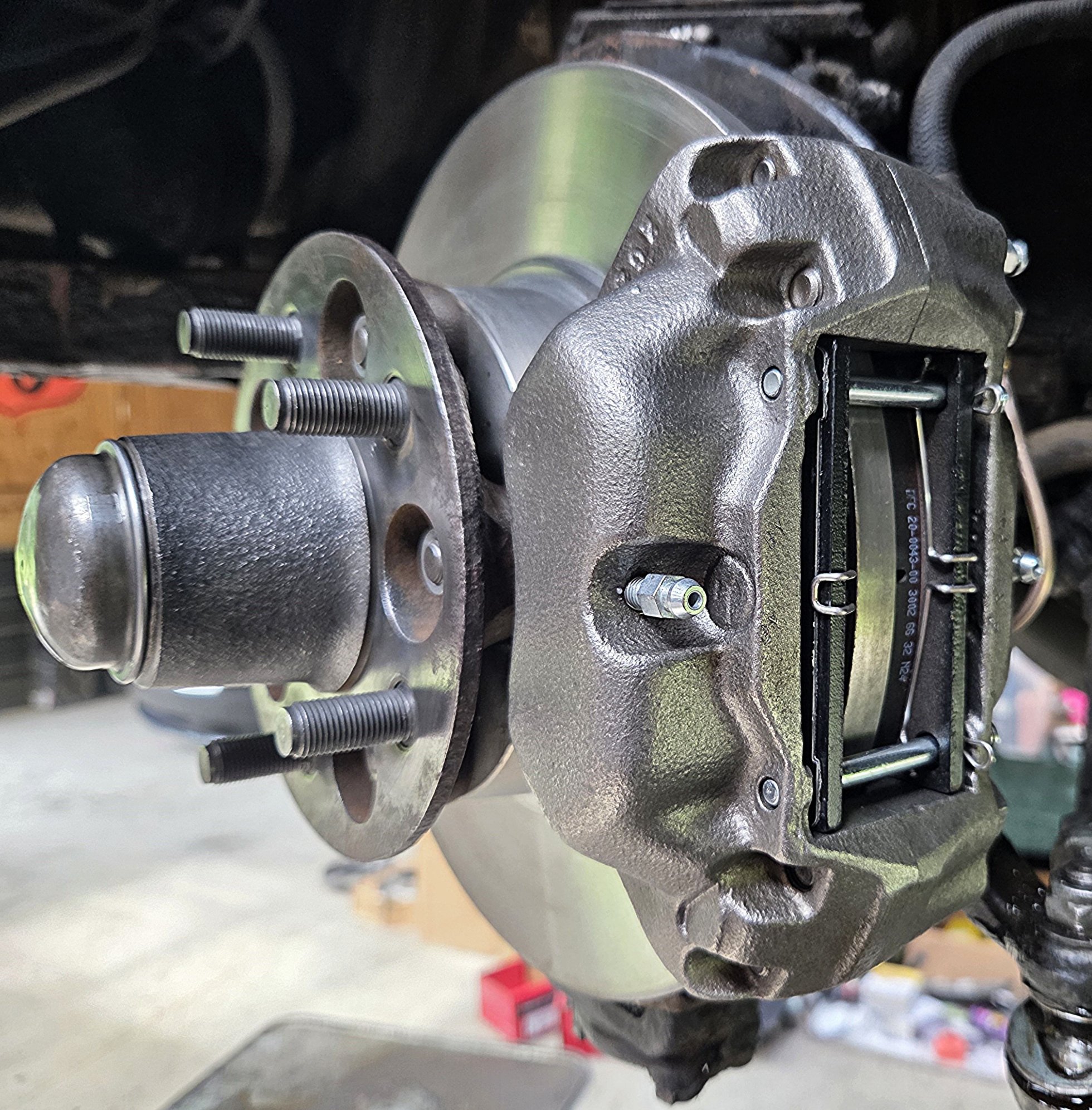

I had picked up a front caliper from a Volvo 240. I really liked that it was a Girling design with 4 pistons. To get it to fit over the rotor I needed to remove the two tabs on each side.
It fit the rotor (barely) but there was no clearance to the wheel (keep reading below).
I believe these are Dunlop wheels and they have four indentions evenly spaced around the rim. They do a great job of limiting space for brake upgrades.
Here's a better view. I suspect this was designed in to add strength.
It was at this point that I decided to table the brake upgrade to the winter so I could stay focused on the bigger picture. I rationalized that if 4 drum brakes are good for my Dad's 1966 Charger with a 330+ hp V8, they will be ok for this car.

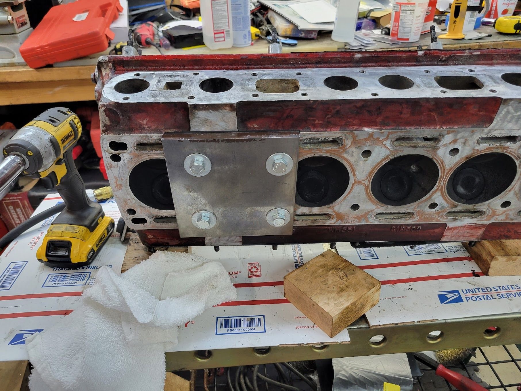

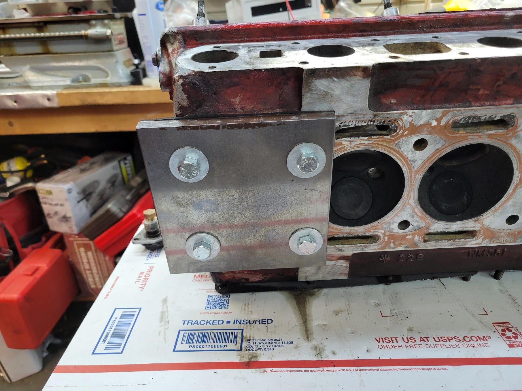

Next I moved on to the cylinder head pressure test plate. This is a piece of 6" x 6" steel 1/2" thick with 4 strategically placed holes and a sheet of 1/8" compressible rubber sheet to act as a gasket.
Here's a better view of it all sandwhiched together. This lets me pump comperessed air in through the spark plug holes and make sure the valves are sealing.

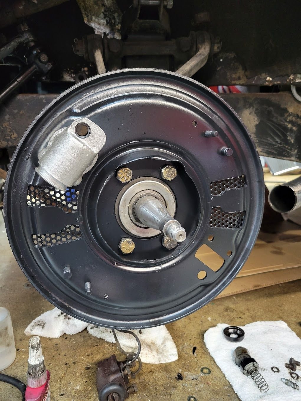

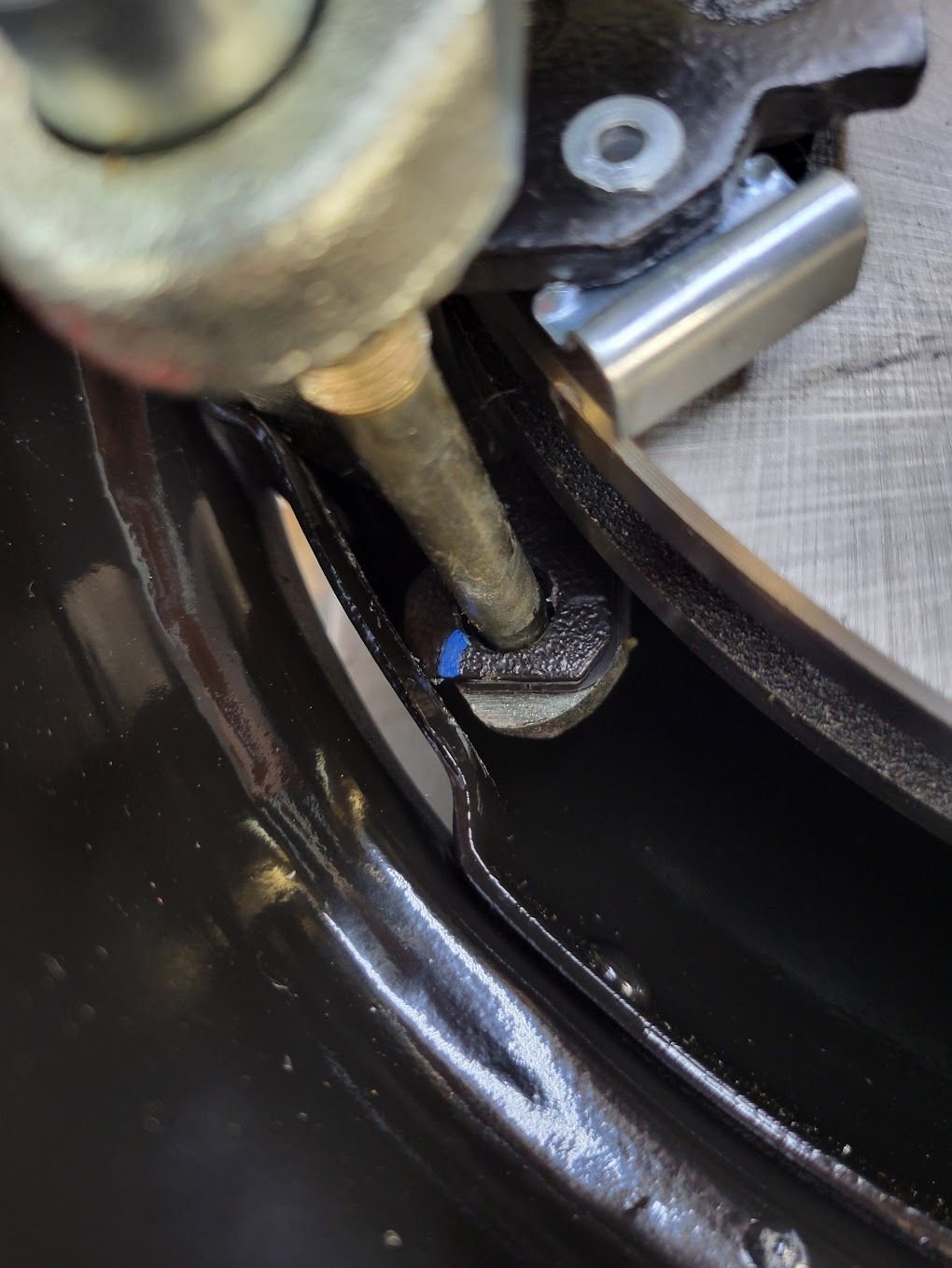

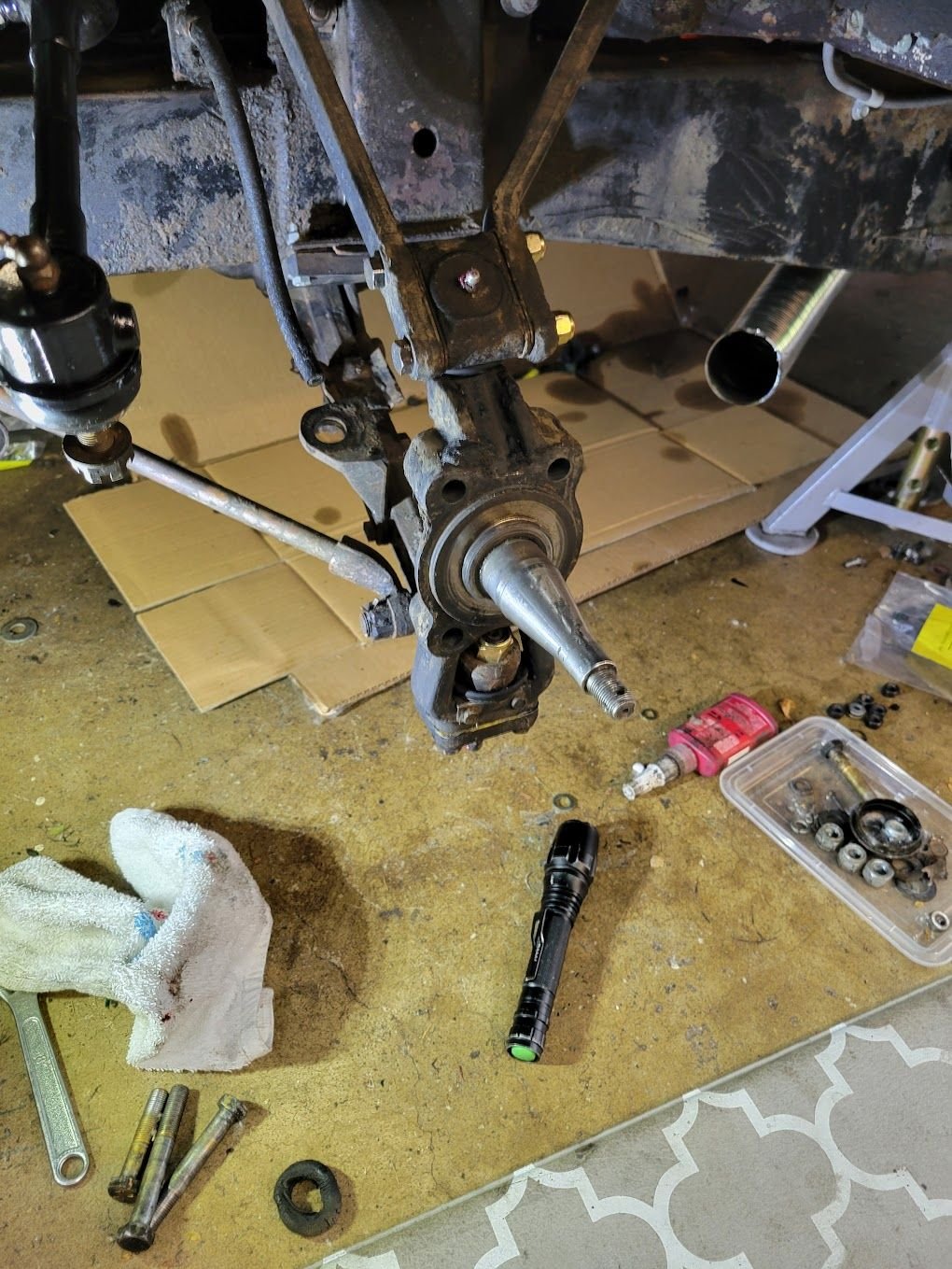

Then I moved to putting the front left suspension back together. New polyurethane ball joint boots replaced the rubber ones that were there.

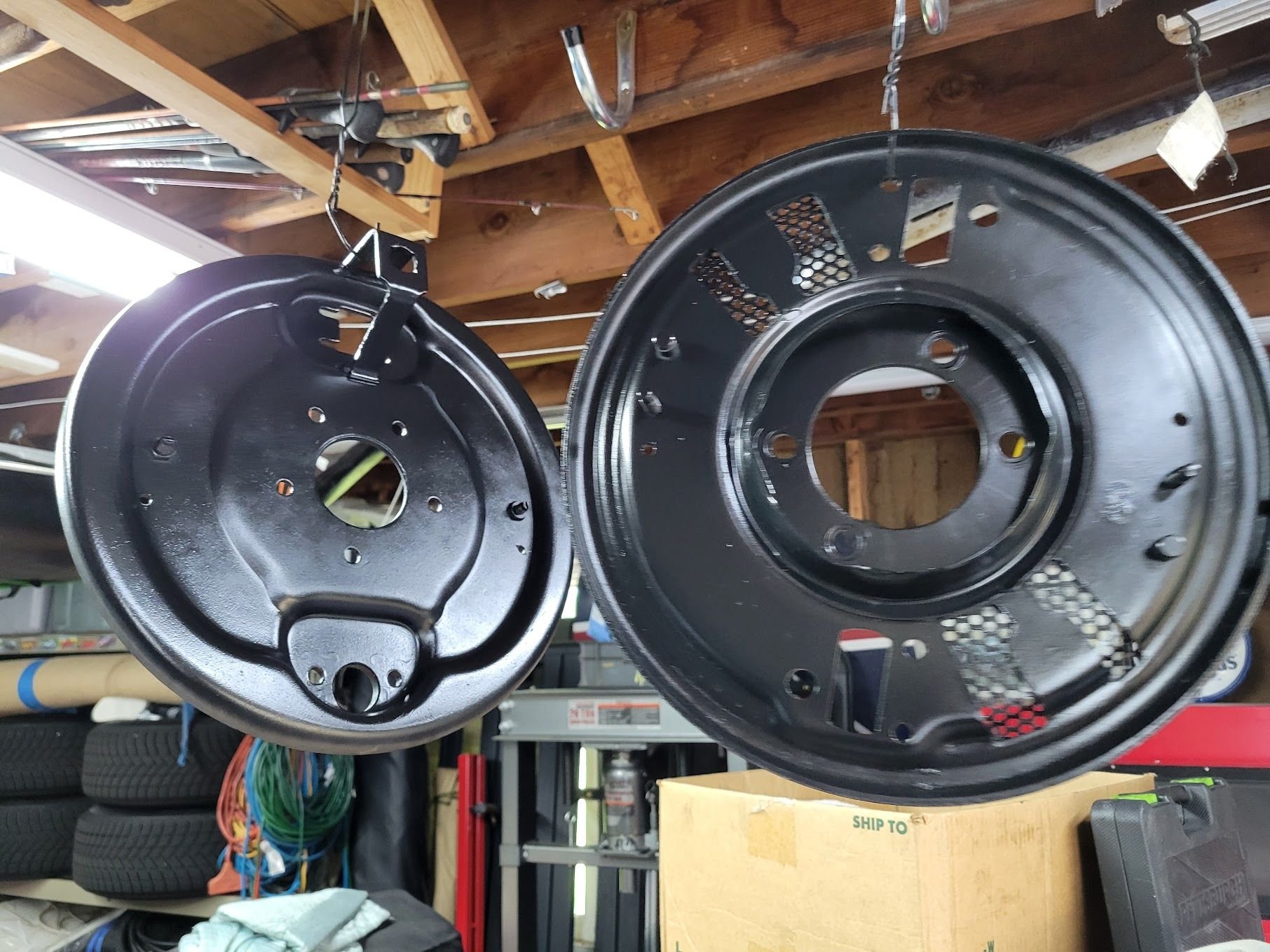

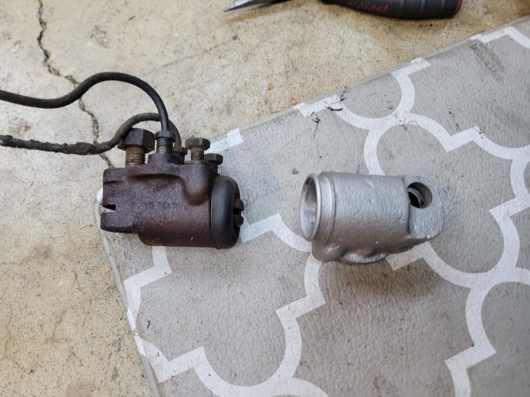

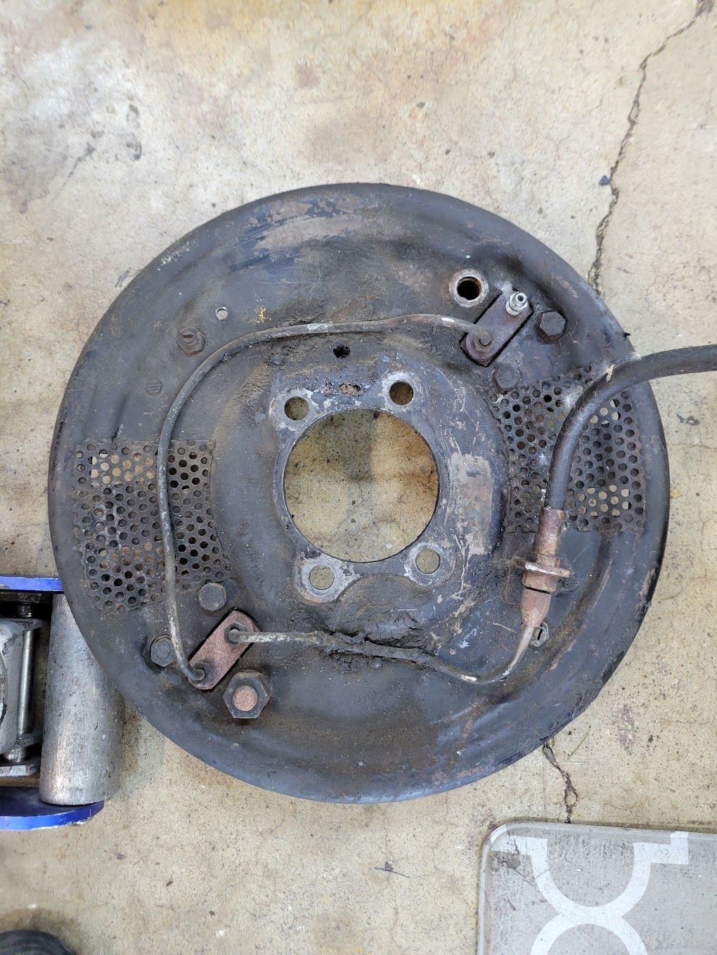

After that I moved on to brake backing plates. Looking at the front left, I feel like it would be easier to bleed the brakes if the fluid inlet went into the bottom of the lower wheel cylinder. That would keep all the bubbles moving up.
After sand-blasting the left side front and rear plates, they were treated to 2k chassis black paint. I like how the 2k paint cures in about 15 minutes and it's durable enough I shouldn't have to worry about it chipping.

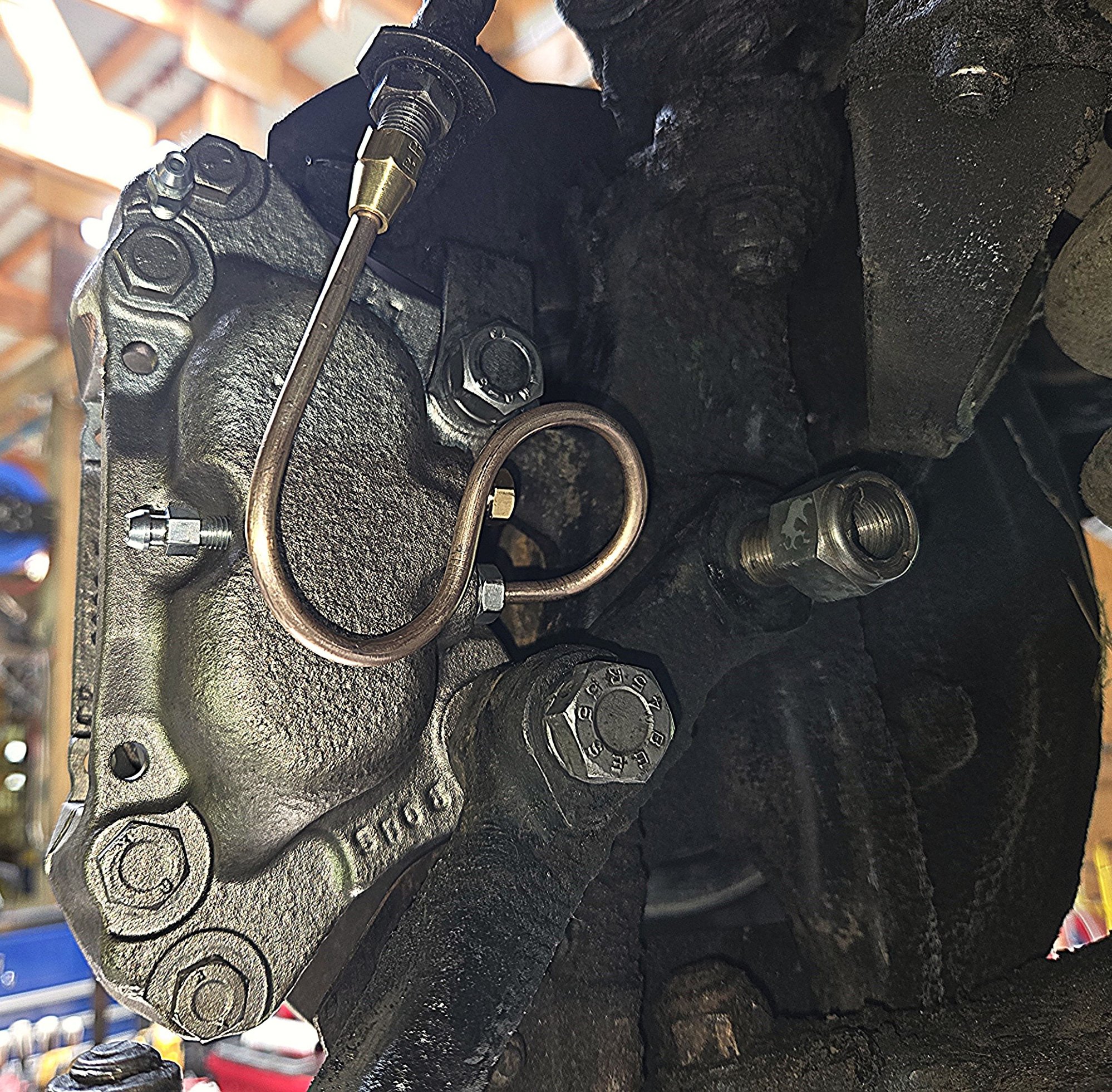

I happen to have just upgraded the original front Dunlop 2-piston calipers in our '66 S-Type to those Girling 4-piston calipers for the Volvo 240, and I really like the setup. In the S-Type, the original 11-inch diameter rotor has to be reduced to 10-11/16 inches, so 5/32 inch (4 mm) must be removed from the radius. The calipers center more easily on 1/2 inch thick rotors, so I used rotors from a Series 2 E-Type, which start out at 11-1/8 inches diameter, so 7/32 inch (5.56 mm) must be removed from the radius. Here are a couple of photos of the installation:
I'll post a more complete write-up in the Mk II S-Type forum. I hope you'll eventually figure out how to make them work on your car - they made a very nice difference on our car.

Tonight was a busy but productive evening in the garage. The UPS man delivered my new intake valves and I got busy lapping and installing them. With 6 new intake valves and valve springs, I had no reason for any leakage.
To test my theory, I bolted the pressure test plate mentioned above to the bottom of the head and started my test.
I broke out the leakdown tester which is supposed to tell you, as a percent, how much air you have leaking out.
The problem was these gauges are notoriously inaccurate. In the picture above I was showing 0% leakage at 27psi, but the end of the test gauge was not connected to anything. By my logic, that would be closer to 100% leakage than 0%.
I abandoned that test and went back to a test mentioned above. I stood the head on the exhaust port and filled all 6 intake runner with acetone, then checked the combustion chamber for signs of acetone leaking past the valves. It was dry, and still dry after 5 minutes - so I decided the valves were not leaking. I repeated the test for the exhaust valves and with the same result I moved on to adjusting the valves.
The intake side took me 4 attempts to get all 6 valves adjusted to .006" as per Bill Mac's advice. Proving that I am not a slow learner, the exhaust side was done in 1 try, with the exception of needing one more shim that should be on the way soon. .008" clearance on the exhaust valves was my target.
I ended up ordering the Payen composite head gasket from SNG Barratt. Not a cheap head gasket but buy once, cry once.

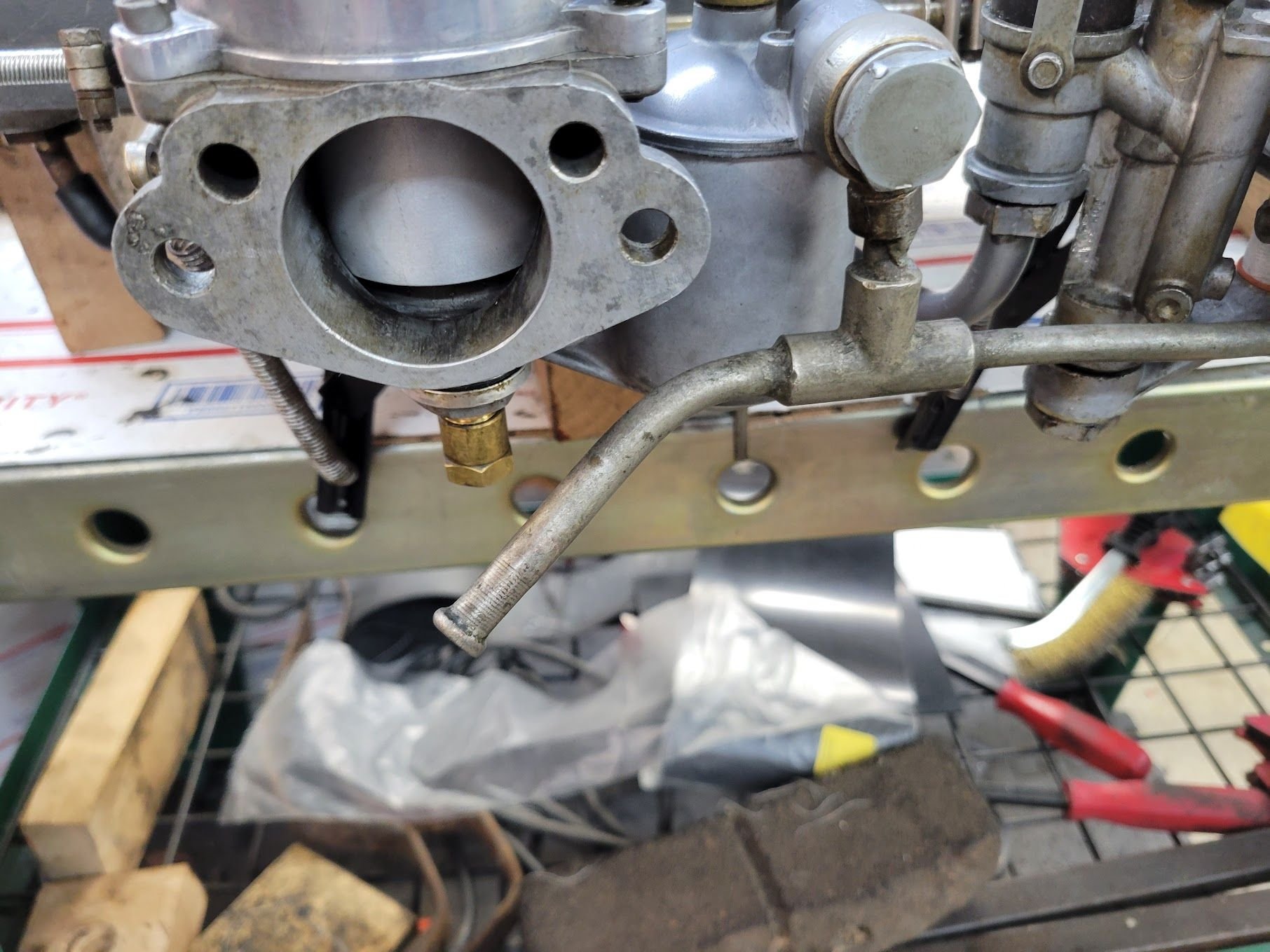

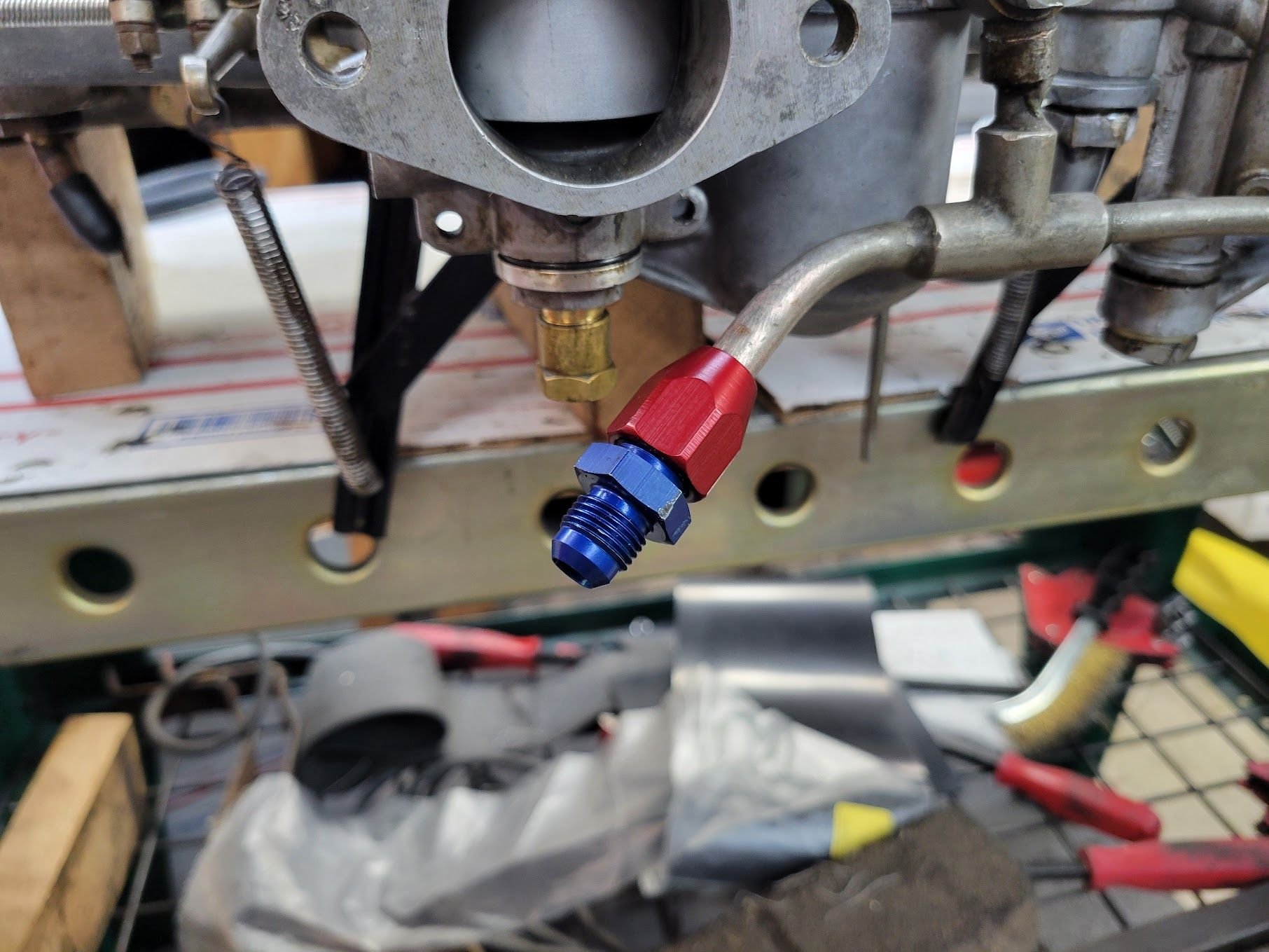

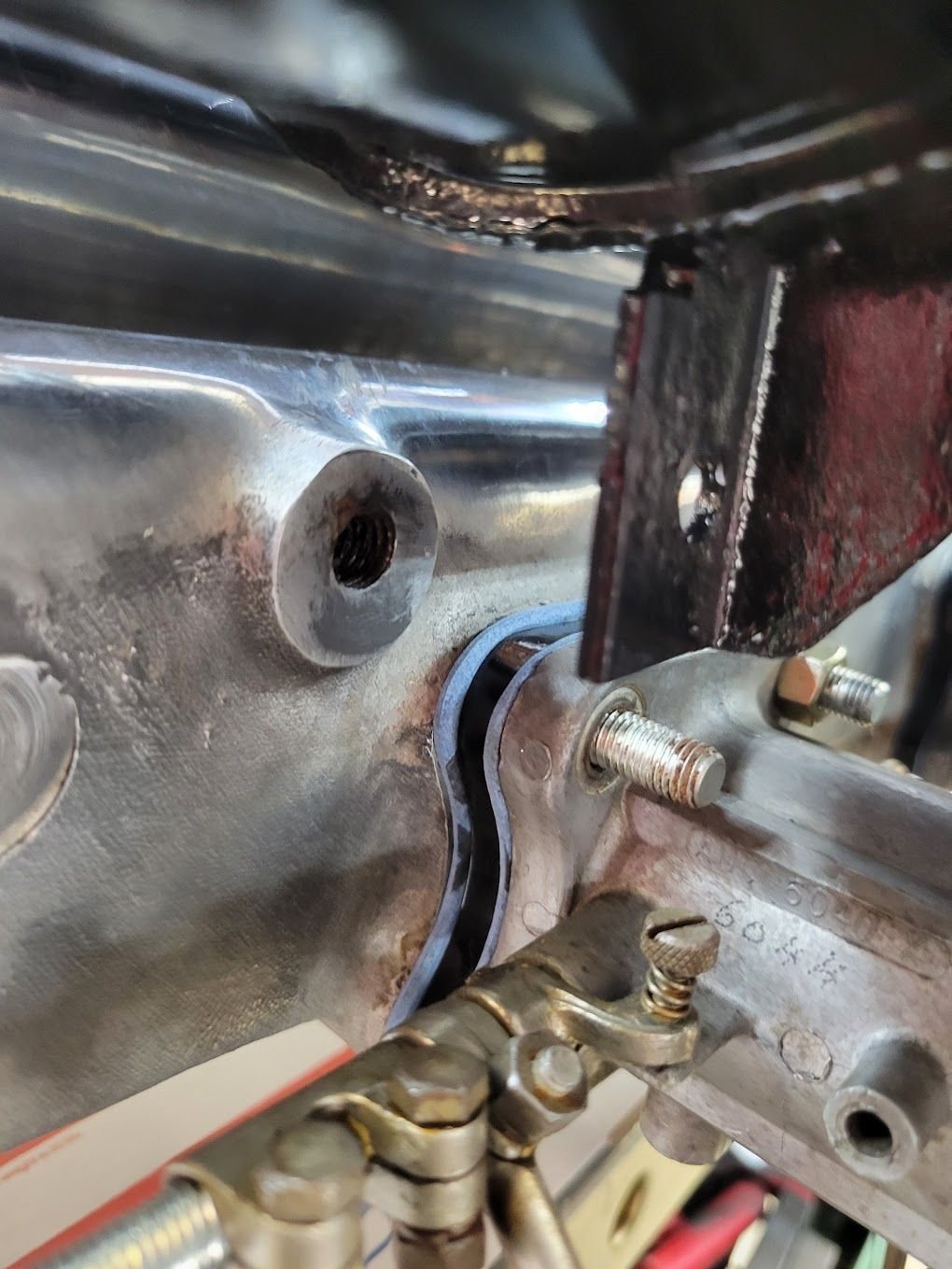

One thing I wasn't happy with was the flare on the fuel line to the carbs. I know this will see very low ( less than 5 psi) fuel pressure but a while back I had a fuel leak on my Range Rover Classic and it left me with 3rd degree burns on most of my arm. So when I have the chance to make anything related to the fuel lines safer I always do.
I cut off the flare, de-burred the edges, and slipped on a compression-to-AN fitting. I used these on my fuel-injected MGB and they don't leak even with 55-60 psi, so this should easily handle the 3 or 4 psi the fuel pump provides.
It's a little blingy for my tastes but the air filter manifold will mostly hide this.
