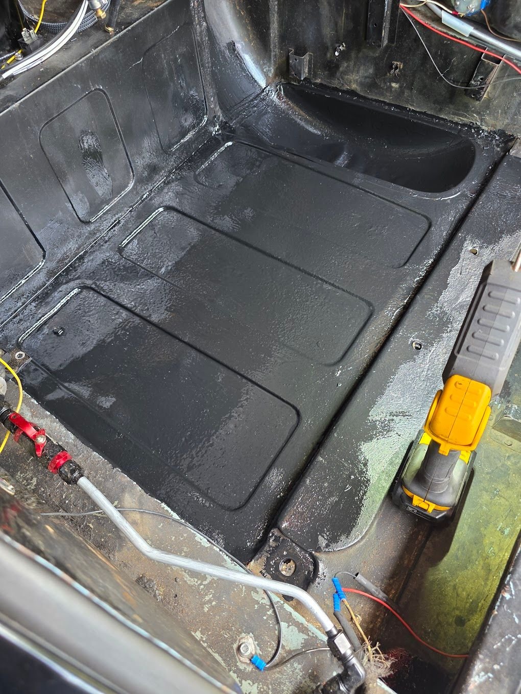

Since the car is non-operational for a bit, it's time to start addressing some things.

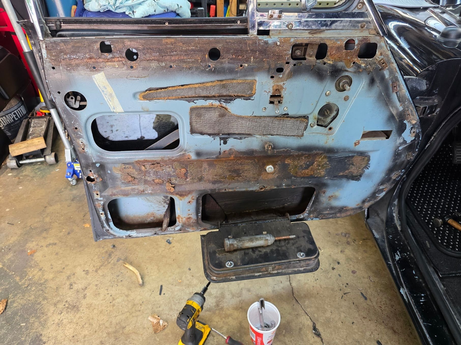

First up - since I had to pull everything out of the trunk to air it out from the gasoline bath it took I decided this was as good a time as any to address the surface rust on the trunk floor.
After wire-brushing, vacuuming, and cleaning it I put down a layer of rust converter. I don't understand the chemistry but this changes the iron oxide (rust) to black oxide (not rust) or something like that. I used it 33 years ago on my MGB and it's held fast so I trust it.
While I was waiting for the rust converter to dry, I moved on to the part that I was planning on getting to tomorrow after Coffee& Classics. New window channels and NDV (No Draught Ventilator) seals. First up was removing the door panel.
I had to switch from 3/16" felt to 1/8" felt, otherwise the window would not go up and down.
I'm not sure why they advertise this as grey felt - it's not even close to grey.

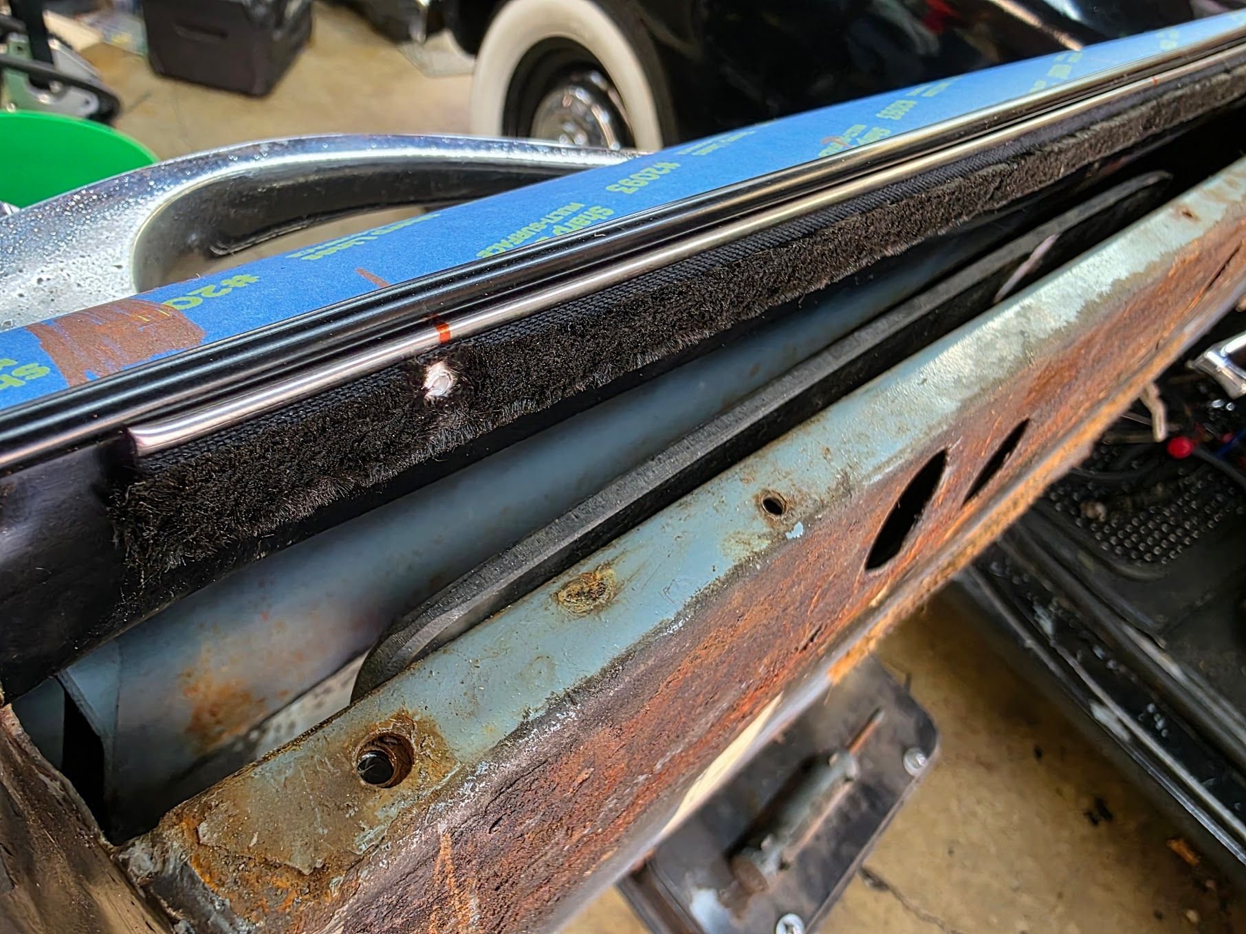

I had planned on using more modern window channel with flocked rubber, but they did not fit.
I laid a piece of tape across the top of the door to mark the hole locations for the beaded trim that goes between the door and the outer weatherstrip.
Here is a picture showing the beaded trim and the new outer fuzzy weatherstrip.
The beaded weatherstrip continues to the front of the door where it turns 90 degrees and is between the top of the door and the NDV aka vent windows. Here it is being glued in place.

After giving the rust converter 4 hours to dry, I top-coated it with black paint.
After the paint dries I need to pull the roll of heavy Hardura off the shelf and make a new trunk liner.
