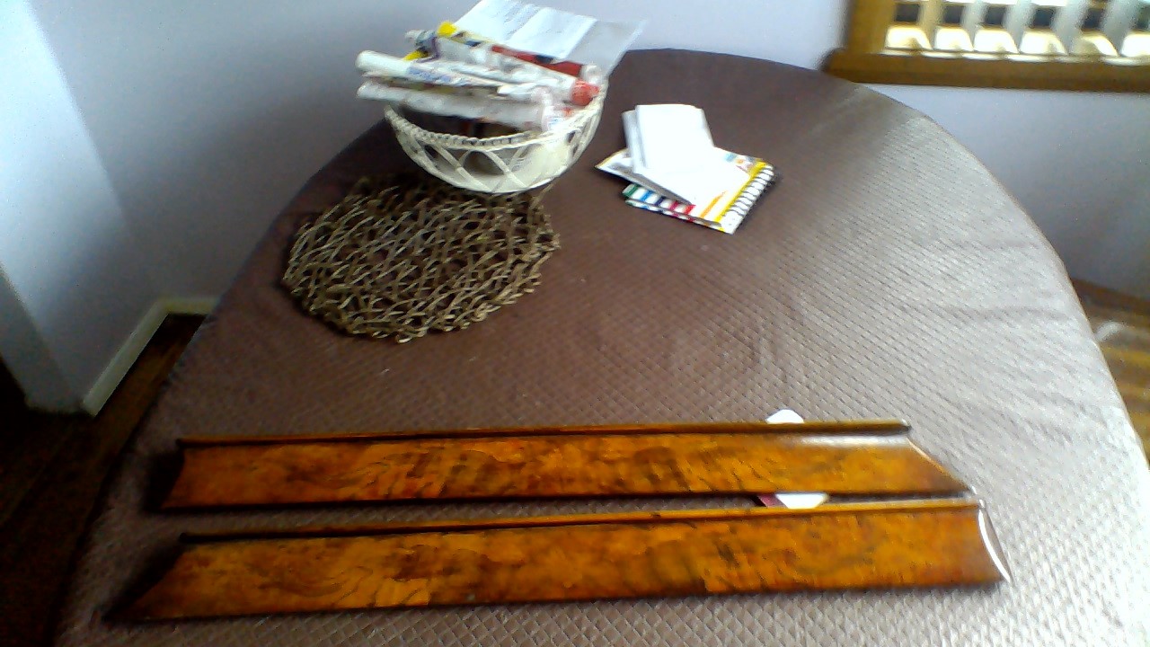

Now,moving on to the vehicle....Its a 1953 Mark 7 automatic,australian delivered.I havnt done too much yet,Ive started refurbishing some of the timber inside the vehicle..I didn't want to "restore" the timber as such,I like the patina.
So,Ive been rubbing it back with 00 grade steel wool and metho to remove the old finish,and reapplying garnet grade Shellac...everything is coming up nice
Now,as some as you know from my previous threads,I havnt fired it up yet...I removed the distributer yesterday,my new points and condensor should be here in a couple of days.So,tomorrow ill be pulling apart and cleaning my distributer,and closely inspecting my oiling system...ive wound it over on the starter motor a lot,but oil pressure gauge isnt moving...pics to come...
Attached Thumbnails Tales from the ghetto gutter workshop,my MK VII build thread-win_20150322_102732.jpg

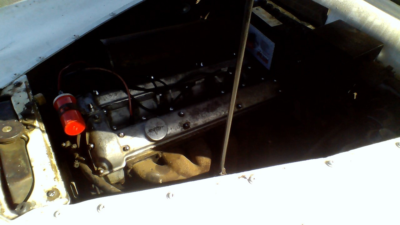

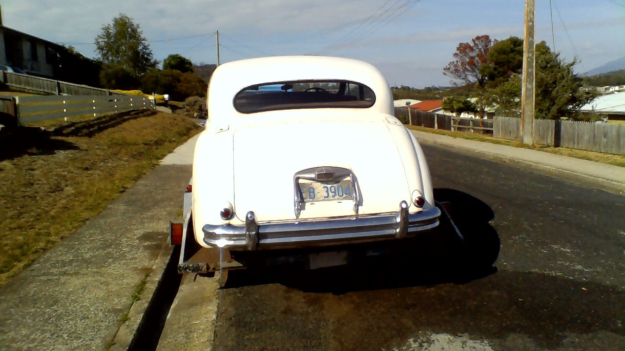

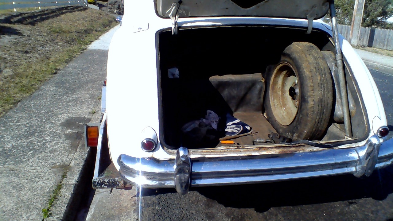

The beast in question,as it sits now on the trailer..
Attached Thumbnails Tales from the ghetto gutter workshop,my MK VII build thread-win_20150322_104122.jpg   Tales from the ghetto gutter workshop,my MK VII build thread-win_20150322_104128.jpg   Tales from the ghetto gutter workshop,my MK VII build thread-win_20150322_104139.jpg   Tales from the ghetto gutter workshop,my MK VII build thread-win_20150322_104217.jpg   Tales from the ghetto gutter workshop,my MK VII build thread-win_20150322_104155.jpg

Hi, I am a Tassie resident as well (Hobart), doing up a Mark7M. Has been sitting around for about 7 years, but I have finally made a start on it. During that 7 years I have been buying bits and pieces for her, that were missing or not original. One of those was the Vokes air cleaner / silencer. The one that I finally sourced has one bracket damaged, and the other removed. So, noticing the photo of your girl's engine bay, I am wondering whether you can help me out with a few things: (1) photos & dimensions of the brackets on yours so I can get mine re-fabricated and (2) photos of how it is secured to engine / inlet manifold. Any help greatly appreciated
