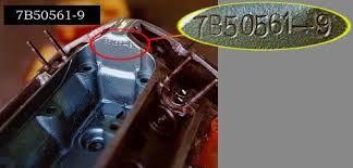

the compression ratio is stamped at the front inner valley wall of the cylinder head. ("valley" is where the spark plugs are).
The engine number is stamped there which will guide you. See last digit. i.e. 9 to 1 in this case.

Found mine end with a -9. Guess my engine is still loosing some health.

9:1 compression, just like mine, a California Black Plate engine.
