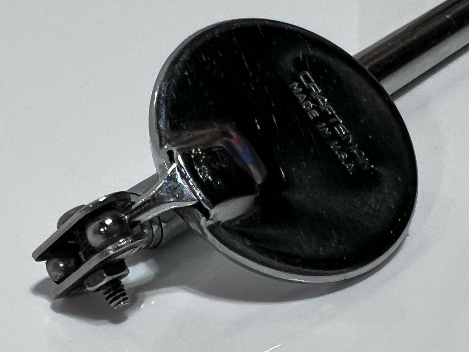

This is really easy if you don't drop something. Likely the O ring binding or someone has applied a sealant. Only necessary to remove cam cover if the bush has moved on the old generator (Unlikely to cause retraction problem) or the plastic drive piece has broken up or severely worn/damaged & jamming something. I replaced mine very quickly with a Craftsman flex joint extendable mirror & a magnetic LED light to see what I was doing & obviously the right tools. Mirror available round or oblong. I prefer round. The shaft is strong but manufactured like an old style car antenna to extend. Available at any Sears. Make sure to fit a new O ring. Remember this is an AC device.
Back of round mirror.
Collapsed mirror shaft
LED Magnetic & rotatable USB charged light. Runs for 7 hours on a single charge easily. Very bright. Light intensity starts dropping off at approx 10 hours but still good. Much better than an old style incandescent lead light.

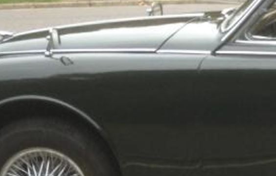

I did not remove the bonnet and it is obviously helpful to do so. I think it needs to be warned that this is just removing the bonnet from the hinge mechanism. If you remove the hinge mechanism from the inner fender is where you really run into bonnet alignment issues with the scuttle top & chrome side beadings. The hinge pins are fairly loose & you can have difficulty aligning the bonnet. ~ a real fiddle on some cars due to the hinge mechanism & centre rubber. You usually end up with the bonnet standing high on one side which irritates me to look at. My **** Virgo tendencies showing.
After much cursing trying to get the LHS of the bonnet low enough my Restoration man said to me now you go home and feed the dogs! I arrived the next morning to a perfectly aligned bonnet. He had worked late into the evening & got it perfect. I compared my hinges with my 2 donor car's hinges & sloppy hinge pins was much the same.
My hinge tops are painted to the bonnet.
Misalignment like this. Excuse if this car is yours ~ This clip of the pic is pretty anonymous:
