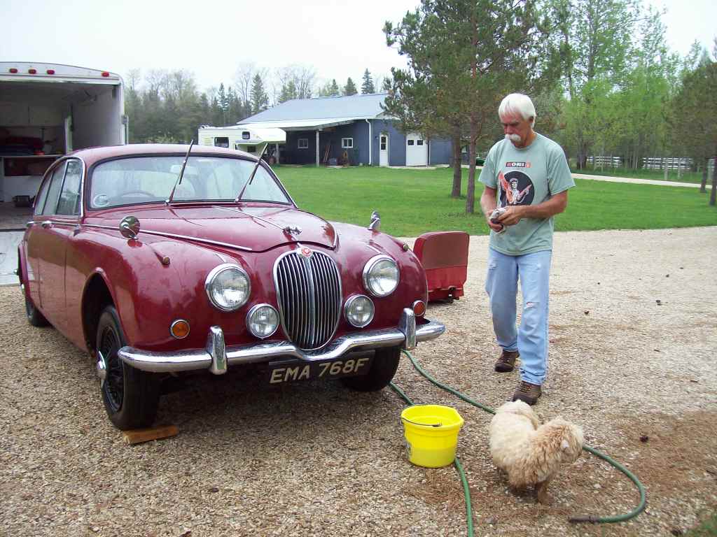

Just got this car (on trade), fairly solid, all chrome, glass and trim excellent, 2 engines (one rebuilt), 2 tranny's (both overdrives), lots of spare parts (many new). Has been apart for 10 years, I'm going to start putting it back together as a driver. Someone know the battery that this car should have? My auto parts guy thinks a 27-750 but that seems kinda big...

So how come in Canada it has a UK registration plate for 1967 ? This is the same year as the Mark 2 I had in the 80s. Presumably imported by somebody who hadn't got much to do. A Mark 2 will always keep one out of mischief !!

Car was brought over early '70's, can't explain original plate, anyone have a North American # for a battery? No tray or hold down with this, want to get one that fits for when I find those parts...

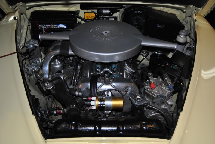

My 1966 Mk 2 3.8 has a group 27C battery, 1000 cranking amps. Perfect fit for both the tray and the batter cover.
