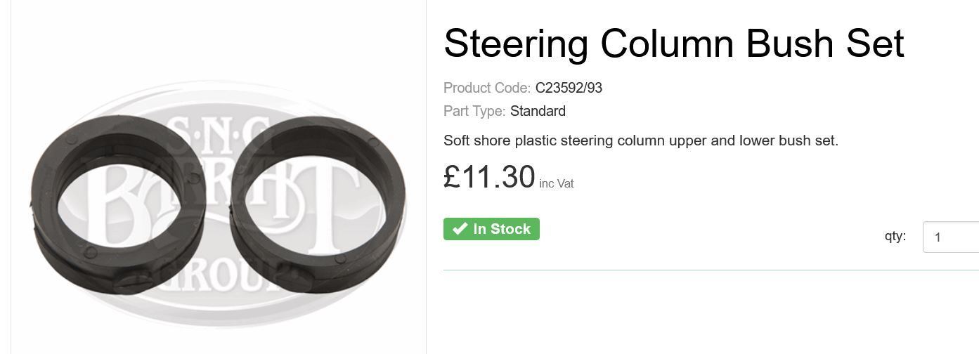

If it's bushes ~ these replaced felt:
Old felt. Barratts can supply the two different thicknesses of felt but you have to cut your own.
