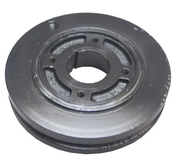

I have a 3.4 engine from a Mark 1 I am installing into my 67 340. The question is should I swap dampners from my later engine or leave well enough alone? First photo is late one.

Which is in the better condition? The rubber part deteriorates over time. It can separate from the steel, crack or become deformed. As to the design, apart from timing marks, I don't think that it changed much over the years, but someone may correct me on that.

It shouldn't make any difference as both are 3.4 litres, use the one in the best condition _ no cracks in the rubber.
If they are both badly cracked, then replace it.

Use the one that is in the best condition as long as it takes the Bi V belt pulley.
Very early XK engines did not have a damper. In June 1956, a vibration damper was added to the crankshaft nose to give smoother running, Dampers pretty much coincided with the 3.4 litre launch.

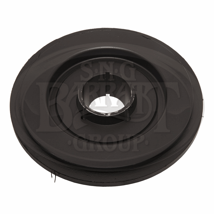

What I'm asking is the later engine has what looks to me more like a dampner while the early engine does not. The only thing I've changed is swapping pulleys.

Your second photo. Is that thing behind the pulley just a metal pressing with no rubber? If so it is not a damper. Sorry the picture is not clear. You need a heavy iron damper ring with a rubber insert. That would be the correct item to use. Your 1st photo has a damper like my 3.8. Jaguar changed patterns over time.
This is what a new crankshaft damper looks like for a 3.4 engine. Some had spokes. These things are heavy.

2e Foto is clearly a broken damper, where top part and rubber is missing completely.
This happens when the rubber is perished.
