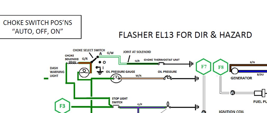

I have exactly the same problem. The thermal switch opens before the engine is warm enough to run without the choke, but mainly in cold weather.
I set up a 3 way switch and an indicator light showing when the choke solenoid is energized. The switch positions are Automatic, OFF, and ON.
I cold start with the switch in Automatic and see how the engine runs as I drive off. If it tends to stall, I switch to ON until the engine temperature rises to about 65F and then go back to automatic. Having the light is a good reminder to manage the choke switch correctly.
Like many others, I have fitted an on/off switch on the dash to help with Jaguar's "Automatic Enrichment Device".
I like your idea of a 3 position switch with warning light.
Any chance of you sharing your wiring diagram with us?
Thanks!

As Red Triangle asked here are a couple of pictures describing the choke wiring I made up.
This was part of a complete rewire with a new harness that featured other changes like multiple fuses, alternator, hazard warning etc.
Attached Thumbnails 3,4l eng. not working properly when cold-choke-wiring-schematic.jpg   3,4l eng. not working properly when cold-choke-switch.jpg
Very neat set-up. Thanks for that.
