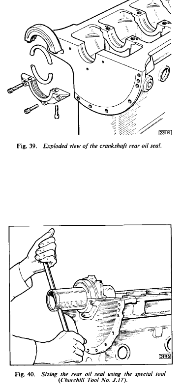

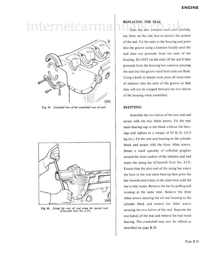

To answer your question directly.~ If I had the option today I would use the SKF seal as used by Rob Beere.
I still have the rope seal in my newly rebuilt engine (not fully run in yet). The SKF seal was not available when we built my motor years ago but if you read my thread in my signature you will understand my delay ~ long expat assignment. I had all the necessary Churchill tools for the job. The secret is NEVER to trim the rope seal. Continue to work the seal with a wooden hammer handle or similar into the groove & finally use the Churchill sizing & centering tool. My seal is bone dry. Zero leaks. The seal must be kept wet with oil & the car used or started regularly.

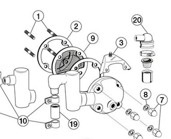

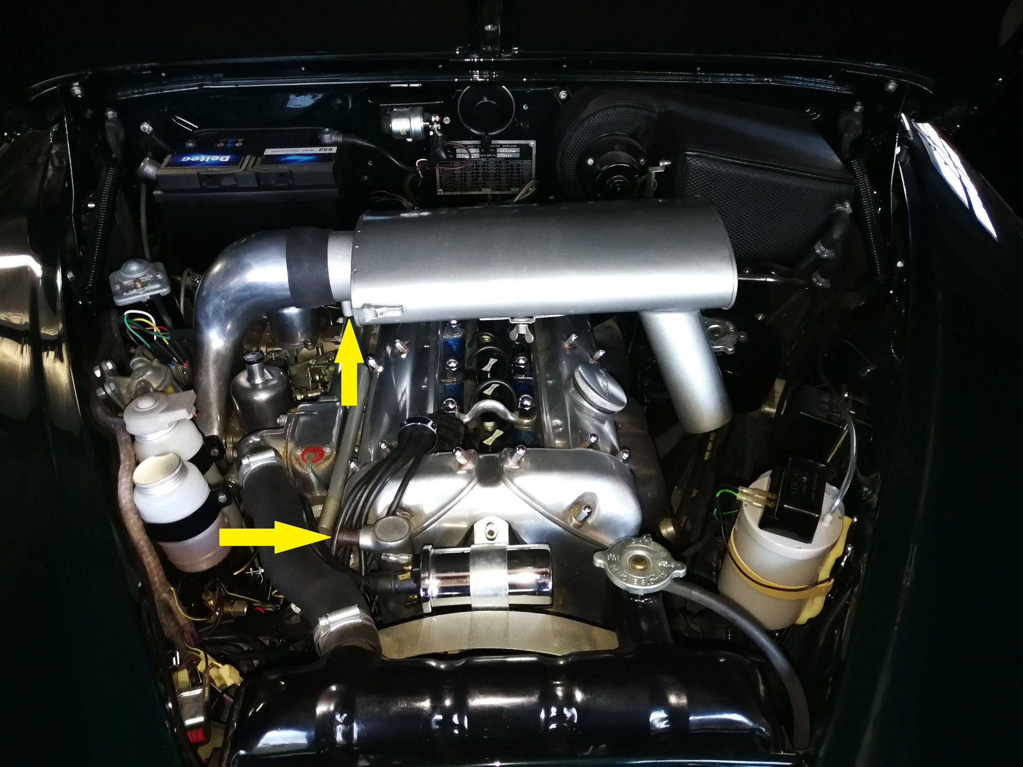

Yes ~ ensure the crankcase ventilation screen (No 9 in diagram) is clean plus Peter's other remarks.
Connected to the Aircleaner Plenum Intake pipe on the S Type engines.
My pipe lying there waiting for me to connect the rubber elbows.

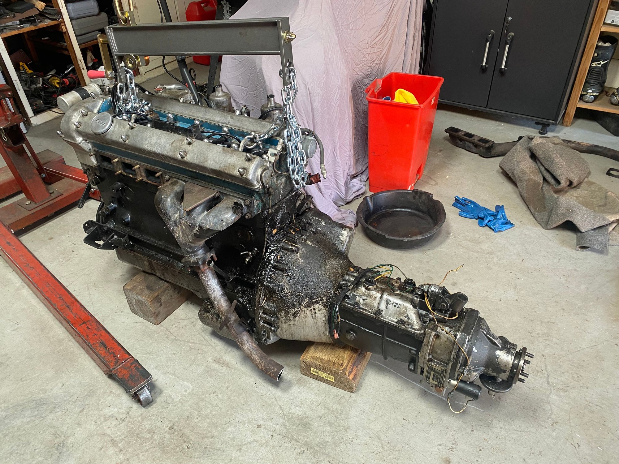

Pulled the engine on Easter Sunday. What a beast to get out! First impressions are that someone had previously pulled the engine to do some work. Every single bolt that held it in place was barely tightened. Nothing was torqued to spec. A lot of oil coming out from between the head and cylinder block at the rear of the engine as well. Hoping that the head isn't warped since the previous owner installed an aluminum radiator. My fear is that at some point it overheated.
We had to cut the exhaust to get it out.
A lot more will be learned when the head is removed.

Before taking the head off and before cleaning the oil away, have a good look for where it's coming out. In the picture, it seems to be from around the head gasket, but check the pipes carrying oil to the back of the head especially where they attach at the tapped holes.

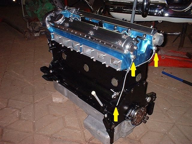

Someone probably decked the block without the chain case in place.
Cam oil Feeds:
