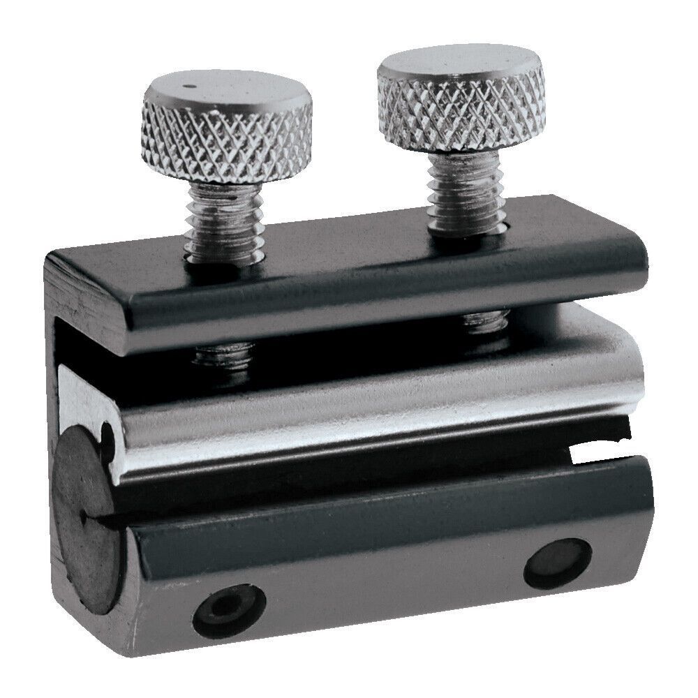

For less than £10 you can buy a cable lubricator. Used on motor bike cables. From my experience of stripping down the heater box I think you will find it is more likely to be the hinge for the flap that is either seized or very stiff.

Peter3442's Avatar
Joined: Aug 2020
Posts: 2,293
Likes: 1,463
From: Oxford, UK
That's a neat tool!!
