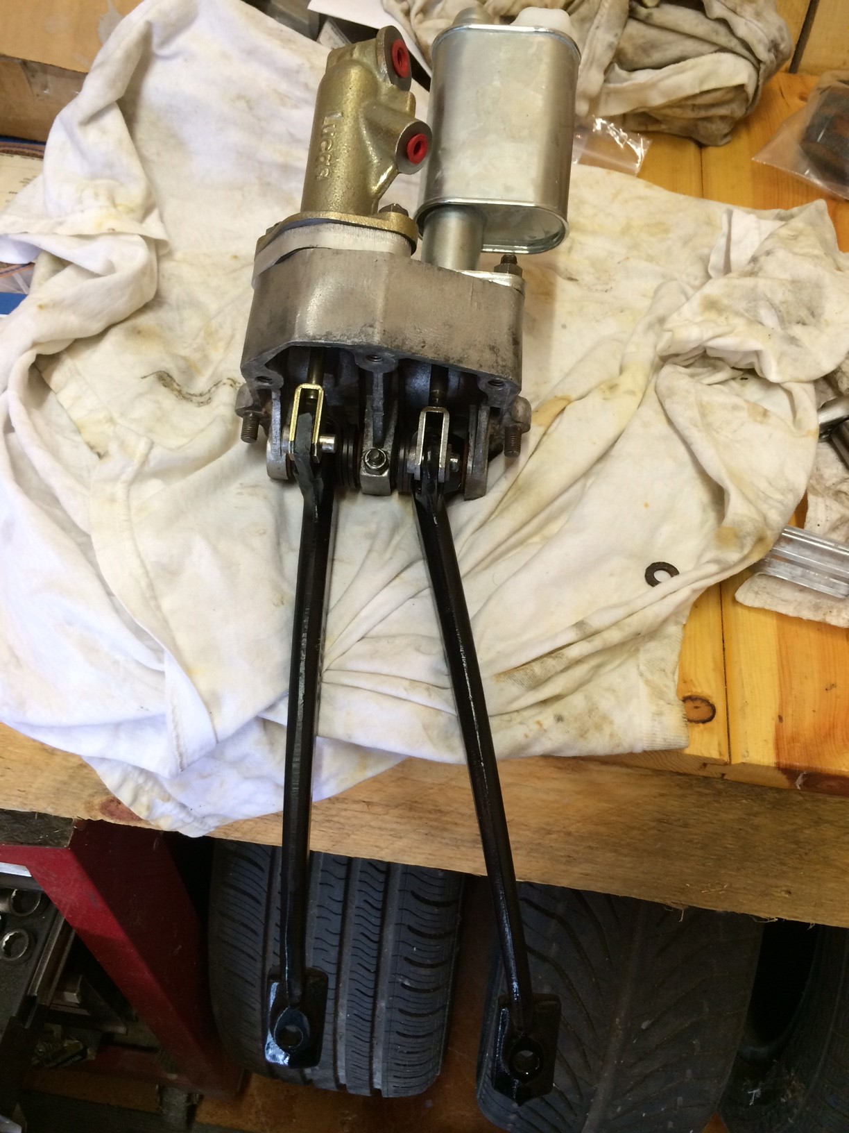

Mostly finished with the pedal box. I have this forum to thank for the help. I always love before and after pictures. This is a case where new parts are key.

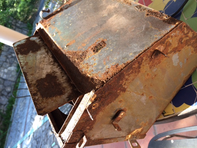

Working on continuing to strip down the car. Ran into a snag with the heater box. Sure it was a pain to get it out, but my biggest challenge is that the flaps are frozen and will not move. I tried penetrating oil for a week, but no luck so sent it to the same radiator shop that cleaned up my gas tank, and we will see if sitting in their tank for a while will free up the flaps.

The restored pedal assembly looks nice.
Regarding the heater box, if you don't have luck at the radiator shop, check out what I did. This is a link to my heater work on my website: Heater ? Valve Chatter

I had a good time with my heater box. Just disassembling it was a challenge.I got the nut off of the motor/squirrel cageattachment, but the old/dead motor would not come out.I used a metal saw to cut the motor shaft, soI could get the squirrel cage out and remove the motor from the heaterbox.
Of course the flaps were also frozen and soaking them forweeks in penetrating oil did nothing. Itook the box to a radiator shop and had it tanked- that cleaned it up prettywell but did nothing for the flaps.Itook MK2’s advice and set up anelectrical bath for it.I didn’t get quite the chemical reaction that I had hoped for but it was very clean. I used a sandblaster on it, and got the remaining rust off, but no luck with the flaps. Finally after all that, I put some more penetrating oil on the flapper pivot points, and attached vice grip pliers to each end and tried to rotate theshaft with light pressure on each end of the flapper.Very slowly they came free and with more coaxing, they are both smooth and have a full range of motion.

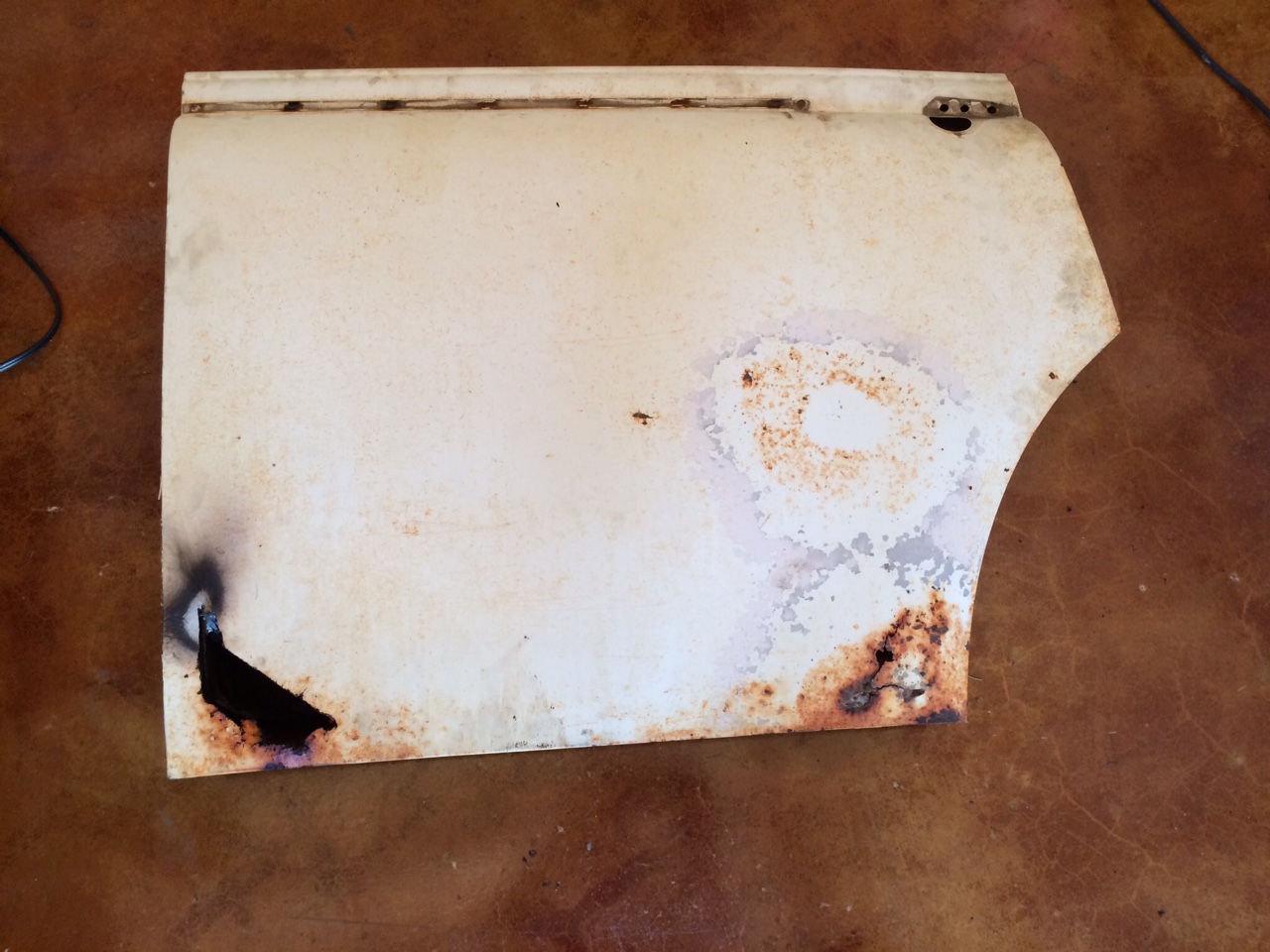

Moving very slowly, but I am making progress with disassembly. I need to disassemble the doors for metal work, as well as getting the door handles re-chromed. Getting the first door stripped down was pretty simple. It all came apart nicely. Getting the door off the chassis was not so easy! I unscrewed the hinges from the body, but found that they will not come out without the door first being removedfrom the hinges. I got one of the three bolts off the bottom hinge and could not budge the rest. I soaked everything with penetrating oil and let it sit for a few weeks.I finally got an impact driver and with a large hammer was able to get the hour upper hinge bolts loose.The bottom bolts would not budge, and the way they are seated in the hinge don’t give much surface to grabso the wrenches slipped off. I finally got a little tool that catches on the bolt head, but it was still too tight. Eventually, I decided to give thetorch a try. I blasted the upper bolt until it was red and everything was smoking.That did the trick, and I was able to get it out. I had no access to the lower one, but since the exterior panel was rusted out and I was going to replace/patch it anyway, I used an electric saw to cut a hole in the exterior of the door and was able to torch the lower bolt too.I was finally able to get the door off. Seemed like a simple task, but of course it was a pain. Only three doors to go!
Heat (allot of it, to the point of cherry red) to the nut(s) will always work.
The heat expands the nut and chemically changes the rust (turns black) and breaks the seal which is keeping the bolt from coming out.
In cases like this no penetrating oil can get past the rust deep inside the threads.
I appreciate your advice on this from previous posts, which is what made me decide to try it on the door. I am a true believer now and the torch is my new best friend! I am careful though, and keep an eye on the car for several hours after torching to make sure nothing is still smoldering.

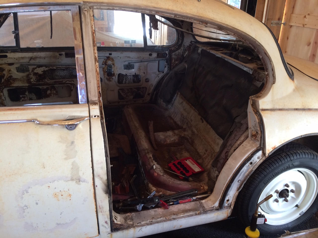

I finally had some time to work this weekend. I pulled the front and rear window’s out, and finished pulling off all the chrome. I got the last two doors stripped down and removed from the car. This serves three purposes- get the door handles off so I can get them re-chromed, polish and fit new rubber in the window frames, and do the rust repair and metal work on the doors. I hope to get started on the body and metal work in the next few weeks.The rust isn’t too bad so that part shouldn’t take long; just a lot of time cleaning and stripping. I hate pulling out all the interior soundproofing, but it all smells. I have been following the Kriss Motors blog which has some great examples of sound proofing, so will eventually go down that road.

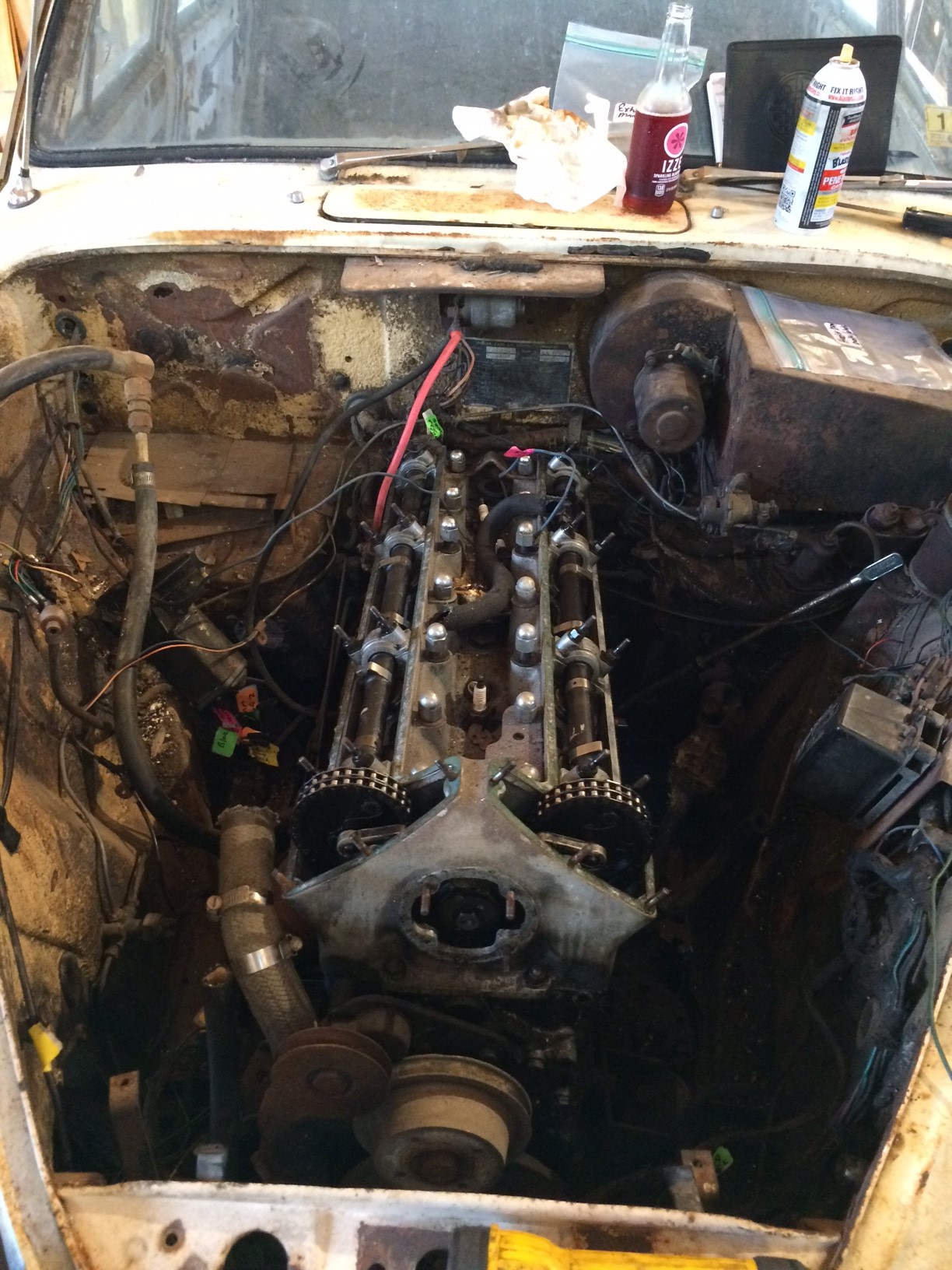

I also took some time to further strip the engine. I pulled the cam’s out, and they look pretty good.There is some light wear on the bearings, but nothing significant, and no scoring. I’ll measure them at a later date. I then proceeded to take off the head to see a little more of what I was facing in the engine.The head came off pretty easily once I found and removed the 6 (!) bolts holding the timing chain housing on the front of the head. Getting the head off revealed why the engine would not turn over- two of the cylinders have corrosion in them- the one pictured has a lot! There is a nearby Jaguar shop that specializes in machining and rebuilding older jag engines, so I will eventually get it to them to fix the block and rebuild the head.
