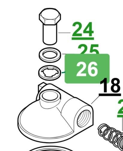

Are you aware of the special washer that fits beneath the overflow pipe connection to the float chamber lid? This allows air to escape the chamber as the fuel enters. If not fitted, the float may not rise fully and fuel continues to enter. Many times, this washer is incorrectly replaced during maintenance with a regular washer or the special washer is refitted on top instead of beneath.

By the way that special vent washer fits between the top of the float bowl and the vent line.

Thanks everyone. I have ordered the special fibre washers. Ian

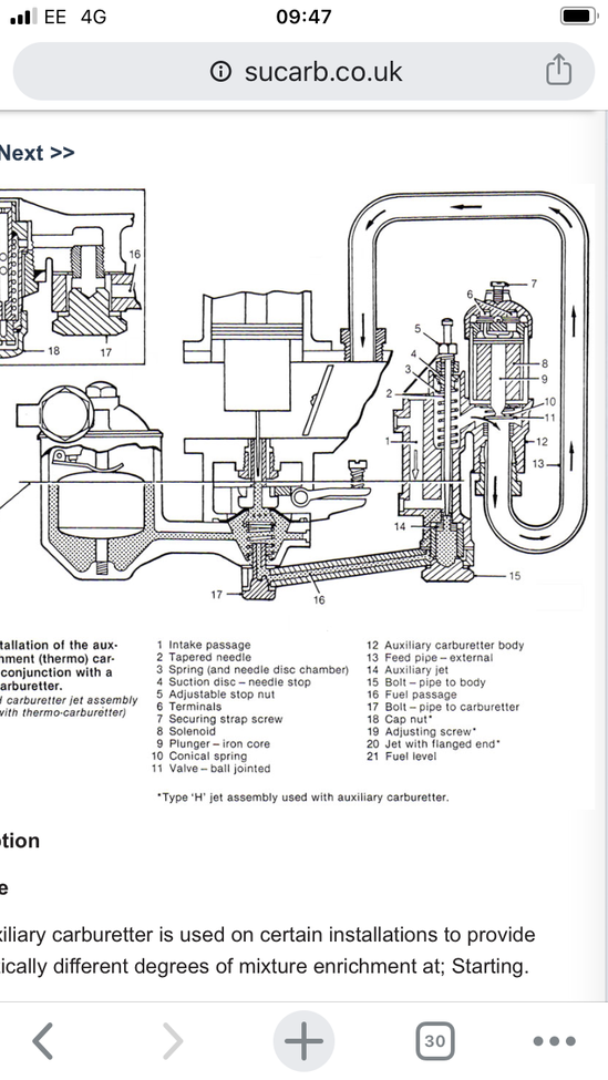

The serrated fibre washers did not work. I read in an old forum that a leaking seal on the ball-jointed on/off valve in the starting carburettor can cause fuel to be sucked through and appear near the top of the intake tubes. Has anyone knowledge of this? Ian

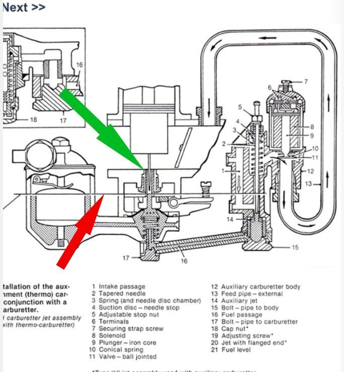

First off, Cass has already explained, but I'll try be more specific.
Look at the diagram below and note where the drawing puts the fuel level (red arrow).
When you set up the float level, the manual will have you set the float fork at 7/16, using round stock.
This puts the float level just below the jet bridge (green arrow points to the jet bridge)
I have found that setting the floats at 7/16th are too high, and this can allow fuel to percolate over the jet bridge and cause flooding, this gets worse on a hot day, or even when the car is simply at full operating temperature.
I want you to do something for me, remove both dash pots and carefully set them aside with their plungers.
This will leave the jet bridges visible on both carbs, looking down into each carburetor.
Now turn the ignition on, let the fuel pump fill both float bowls, and note where the fuel level is in relation to the tops of both jet bridges.
It should be at 1/16th just below the bridges.
If it's above that, or even nearly spilling out, then you have to reset the forks in both float bowls.
I set mine at 1/2 inch, it won't hurt for the fuel level to be a bit below spec, or even lower, maybe even what the diagram represents where the red arrow is pointing.
There's tremendous drop in air pressure right where the main jet is, even if the fuel level was at the red arrow mark, I don't believe it would effect the proper running of the car.
I'm betting that when you do my check, the fuel is nearly at the point of spilling over the jet bridge and trickling into the engine.
Another problem is the fuel tanks breather line is too small, and on hot day, the pressure built up in the tank can't be sufficiently released.
This in turn makes the flooding problem worse by adding air pressure on the pump and forcing un-wanted fuel into the carburetors.
My theory is that poor fuel venting in the tank raises the fuel pressure beyond the pumps 2 to 4 lbs. and the needle valves in the float chambers are easily over come with too much fuel pressure.
I have made my fuel tanks vent larger to deal with this problem, or what I believe to be a problem, it didn't hurt anything, and I don't have a fuel odor.
Do my jet bridge test first, and don't worry about the tank vent for now.

Thanks, JeffR1. Only just seen this. The fuel levels of both carbs have already been confirmed to be at the normal level of just below the bridge (1/8 to 1/16 in). The problem is very intermittent, usually only happening after the car is thoroughly warmed up. Once cooled down, all is well again.
Yesterday I spoke to a classic Jaguar engine specialist recommended by Burlen fuel systems. He said that this is typical of a Mk 2 running on modern fuel and is caused by the fuel boiling (i.e. vapourising) in the hot engine bay. Not sure what to make of this suggestion. Hard to believe that more owners don't experience it.
