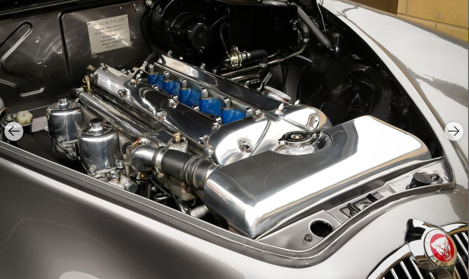

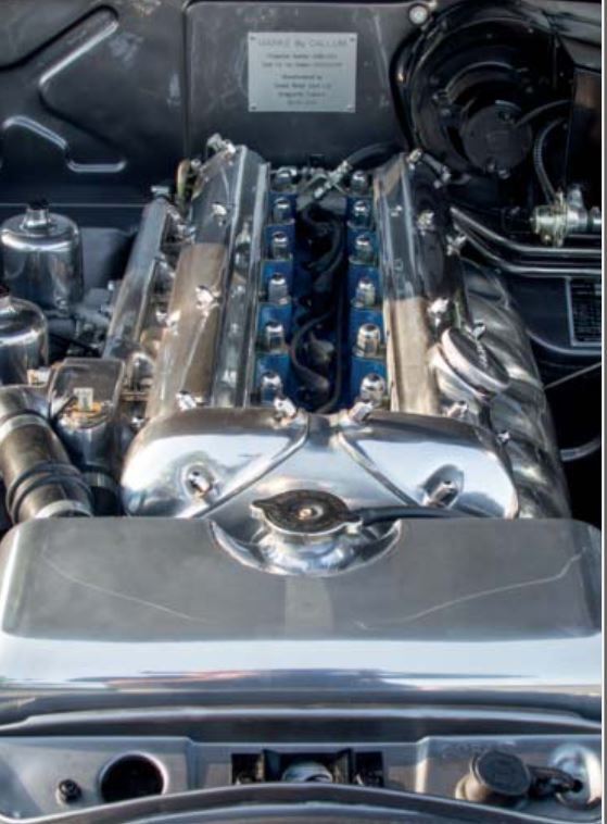

Ian Callum's car with HT leads routed to the rear & coil to inner wheel arch.

Makes for a nice clean engine bay.

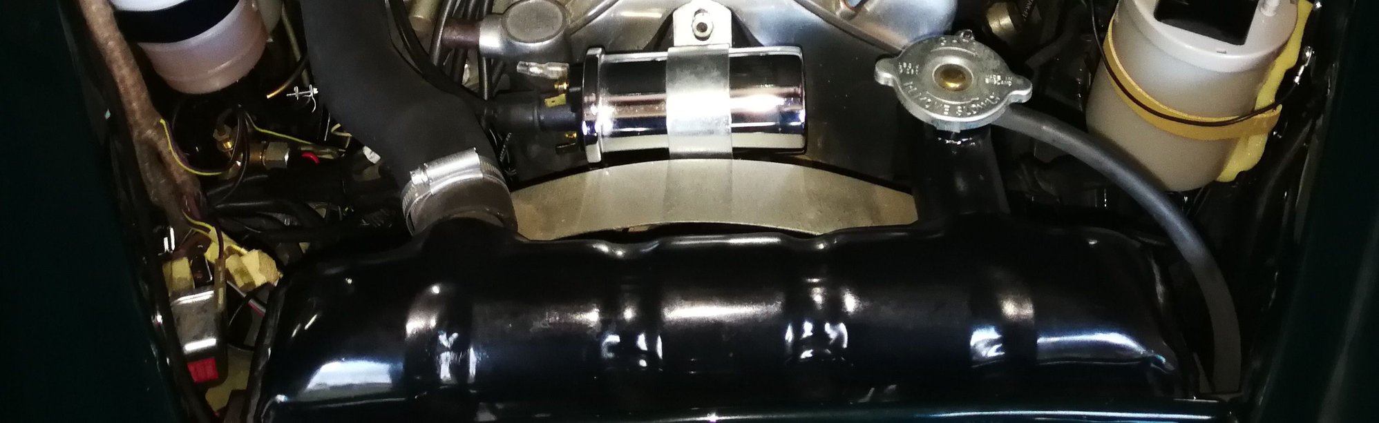

Jose ~ I'm running a debranded Flamethrower 3 ohm 40,000 volt coil without ballast resistor. Starts on the button & performs faultlessly.
Now has a correctly positioned & correct Lucas sticker/decal on it. (for SA CKD cars anyway)

Thanks ~ as you can see we were still working on her at that time. Yes HA12 coils were 30KV and only supposed to have push on connectors from 68. My car originally had acorn nuts everywhere but I went to push on for the coil. That said a friend has an unmolested 66 with push on coil & acorn nut distributor cap so who knows. My original Lucas Coil had done 90K miles so I tossed it.
