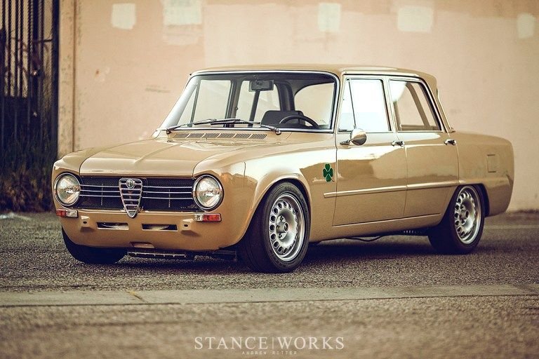

Thank you for all the replies. Due to English not being my daily language, I should have changed the wording from "compatible wheels" to "alternative wheels", but the replies are at least all in this direction. Love the Dunlop Style wheels on Nigel's car exactly what I do have in mind, but at the price on the internet, I am sure there might be more affordable alternatives and yes, I do revert back to the 5 bolt Jag hub.
Hope I do not get criticized too much for posting other vehicle types on this forum, but the Alfa guys in my view got it spot-on with their GTA type wheels on the Giulia which also has an overhang on the rear fender similar to the S and that at a very reasonable price. I have enquired about them, but they are only available in a 4/108 PCD. So my search for alternatives will continue.

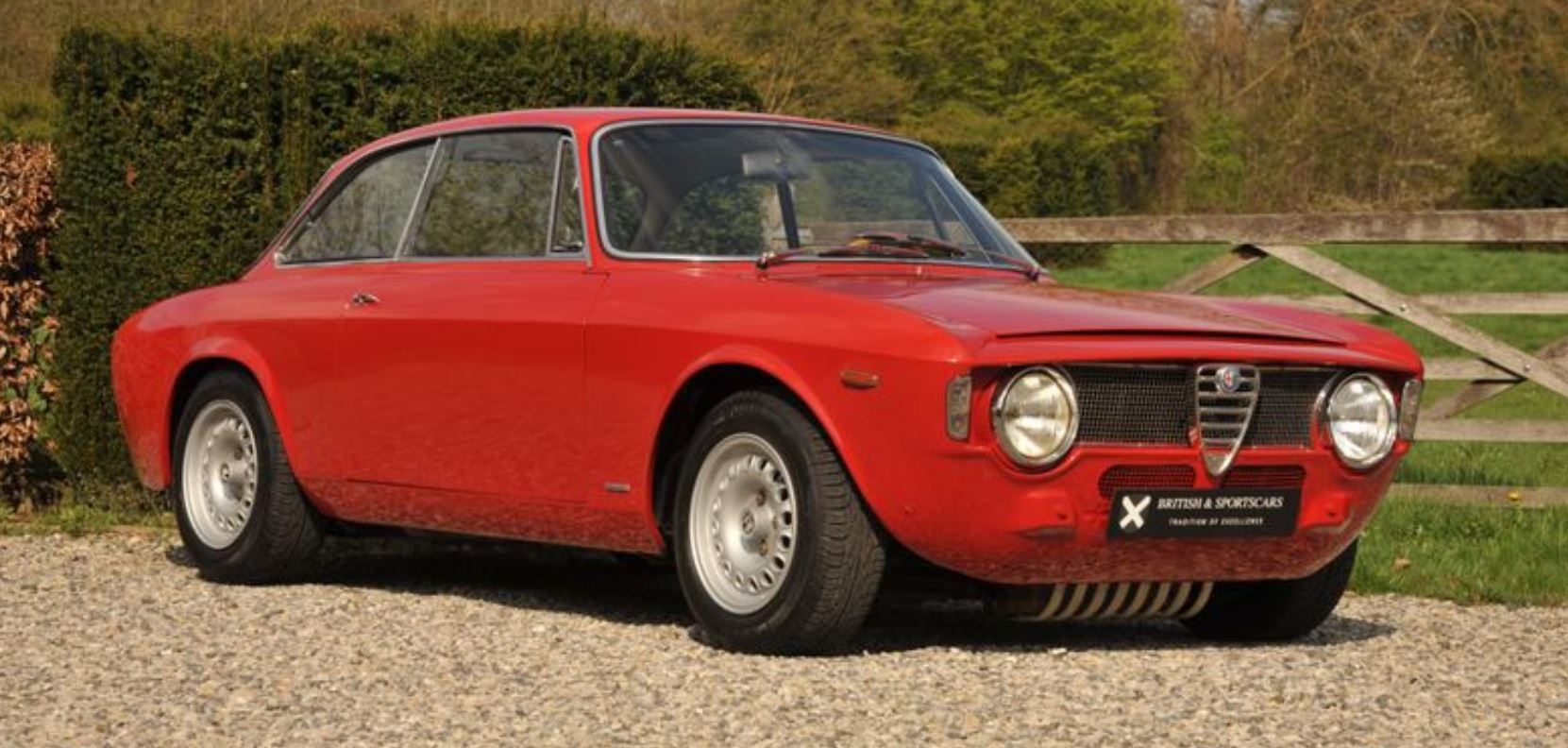

I owned multiple Alfa's in my youth from Giulias, to Berlinas, to GTV's to Spyders. and also loved the GTA wheel.

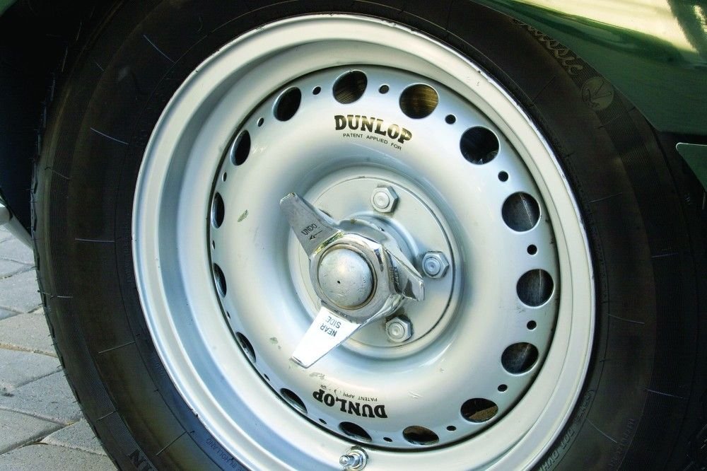

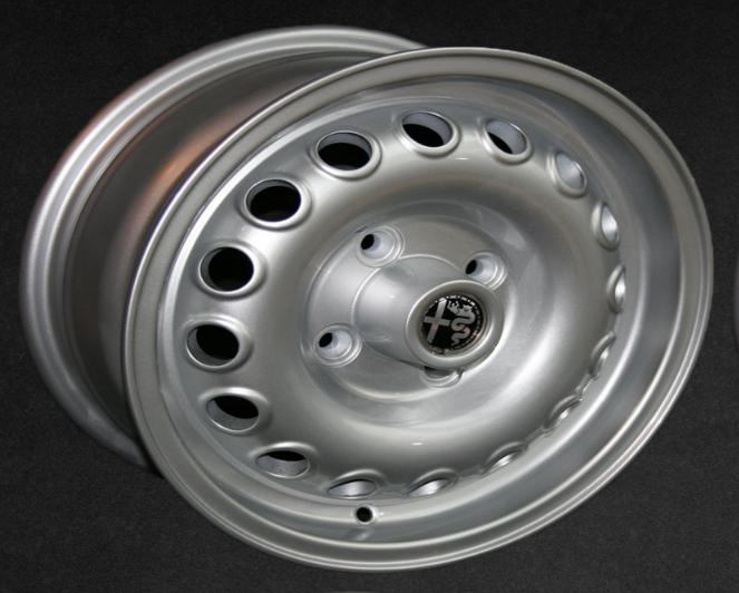

My old GTV had those wheels (or similar in steel? - it's a long time ago). Certainly, I remember that they looked very good.
I think you find the best or least bad prices on the Dunlop wheels if you go directly to Realm or to Image rather than the re-sellers, but they still aren't cheap, certainly not compared with secondhand ones from a pre-X350 XJ.
1950s MGs used steel wheels similar in pattern to the aluminium Dunlop racing wheels. I'm surprised no one produces similar steel wheels today. They wouldn't cost more than £100 absolute max - at least not until someone added a Jaguar label.. There are some 4x4 that vaguely resemble them.

Yes ~ Alfa made a similar wheel in steel
The MGA Twin Cam used a similar wheel. In fact I think the MGA TC used Dunlop wheels.

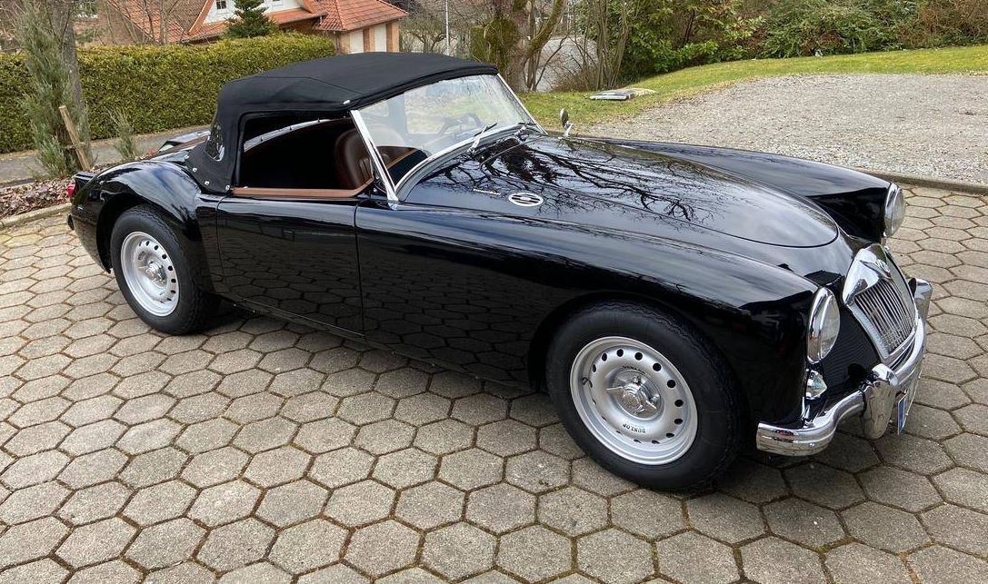

Wheel tech - MGA wheel types
All you might like to know on MGA wheels.

Thanks Peter. So the Dunlop decal was never standard on the TC wheel. Good to know. That is a very good forum.
